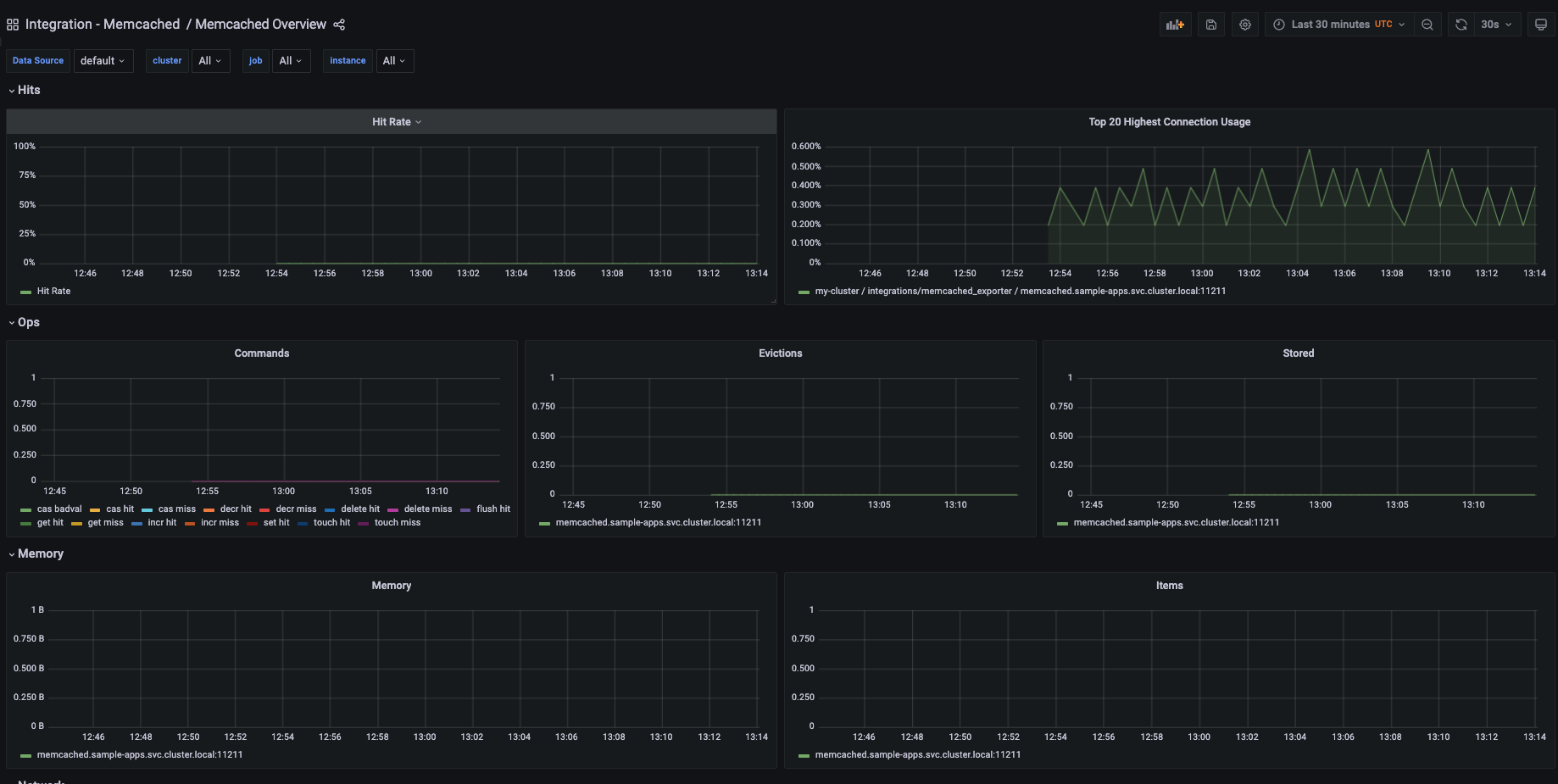

Dashboards
The Memcached integration installs the following dashboards in your Grafana Cloud instance to help monitor your system.
- Memcached Overview
Memcached overview
