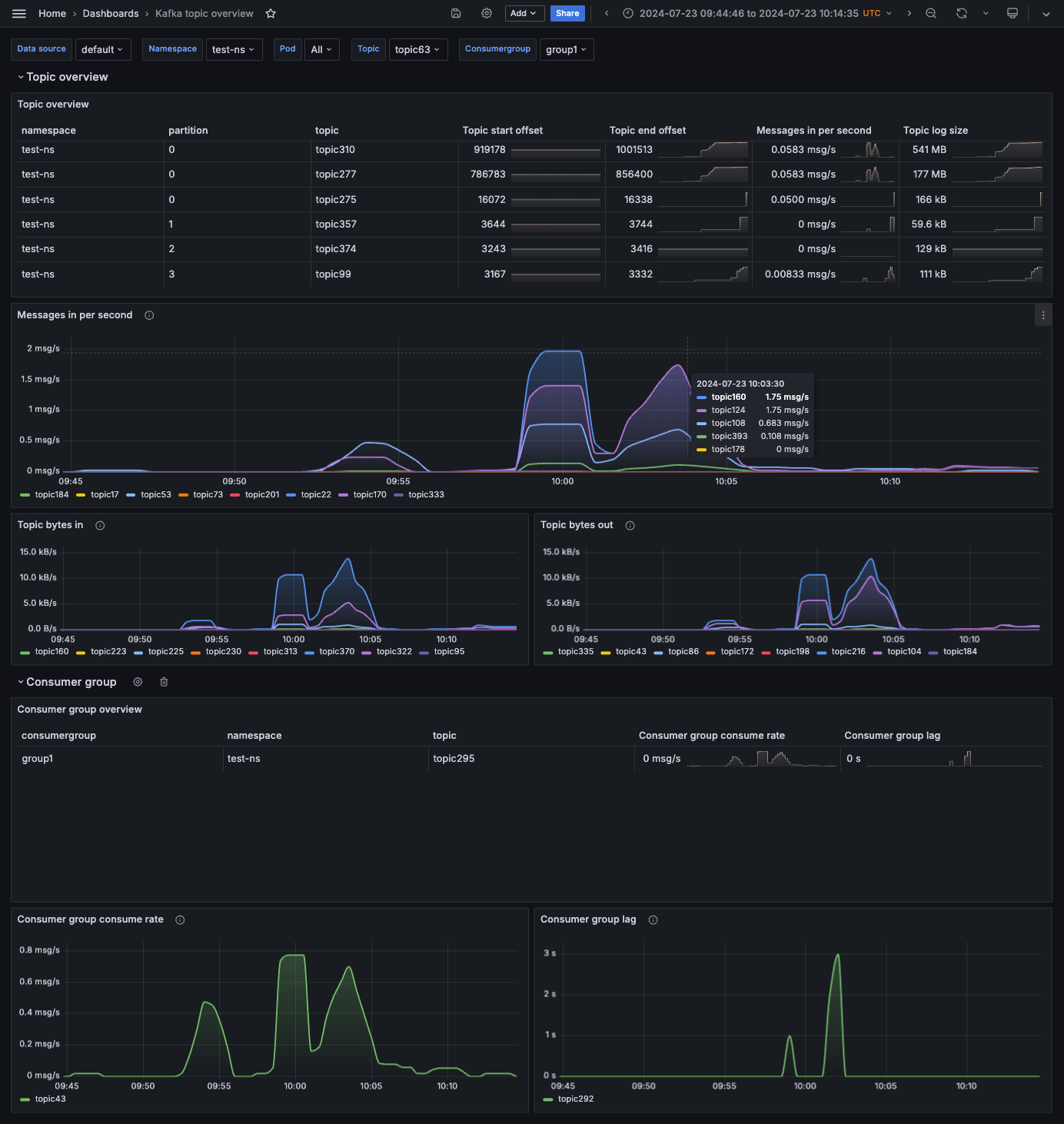

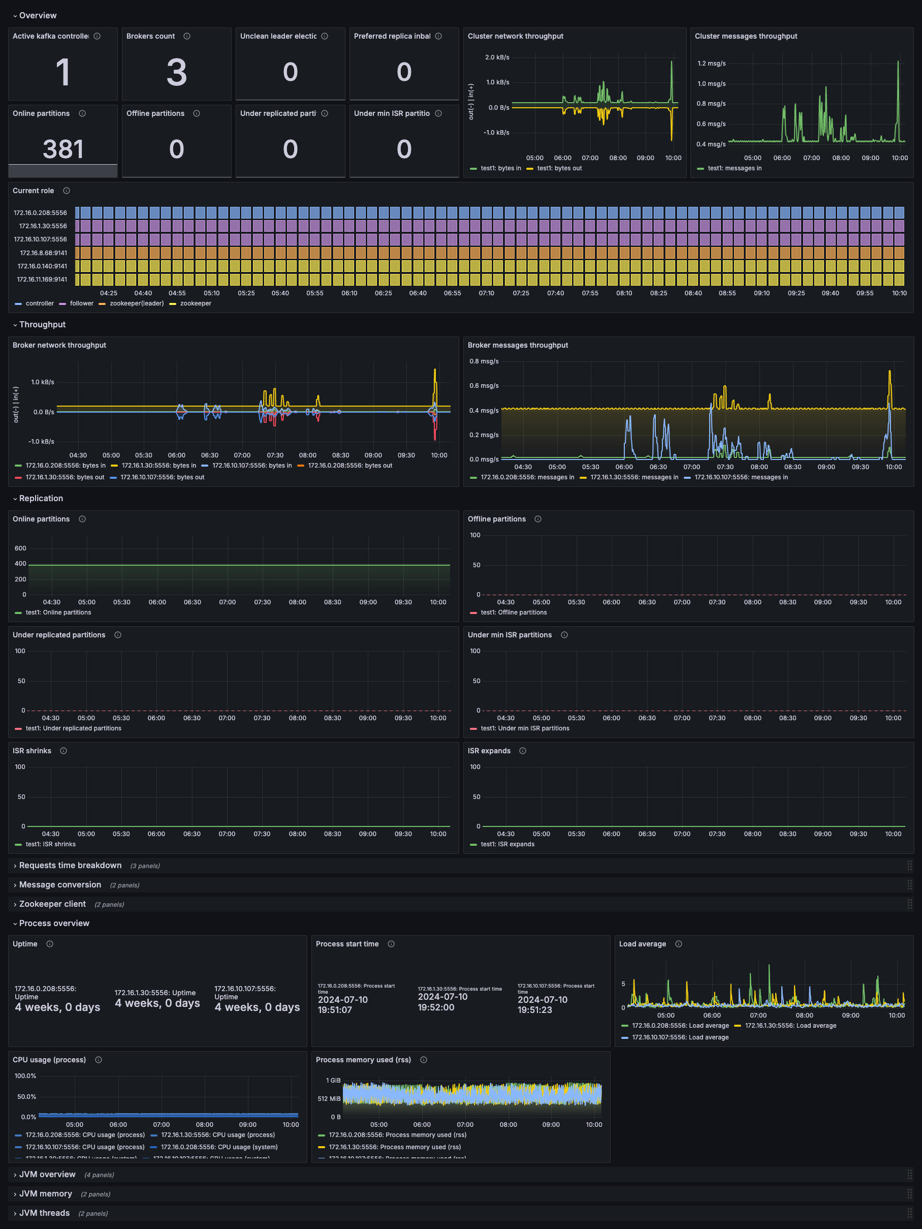

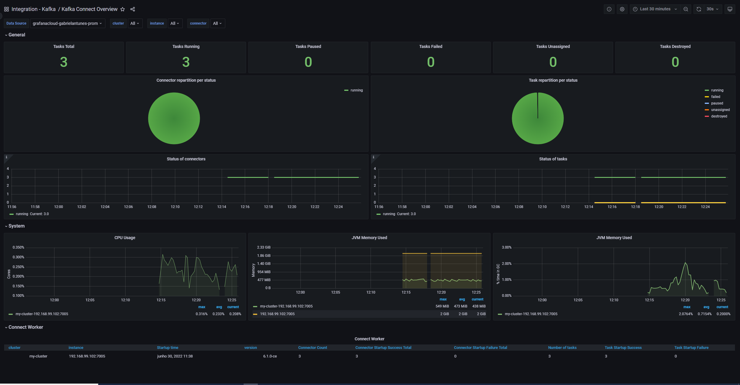

Dashboards
The Kafka integration installs the following dashboards in your Grafana Cloud instance to help monitor your system.
- Kafka Connect Overview
- Kafka logs
- Kafka overview
- Kafka topic overview
- Schema Registry Overview
- ZooKeeper overview
- ksqldb Overview
Kafka overview dashboard
Kafka topics dashboard
Kafka Connect Overview dashboard
