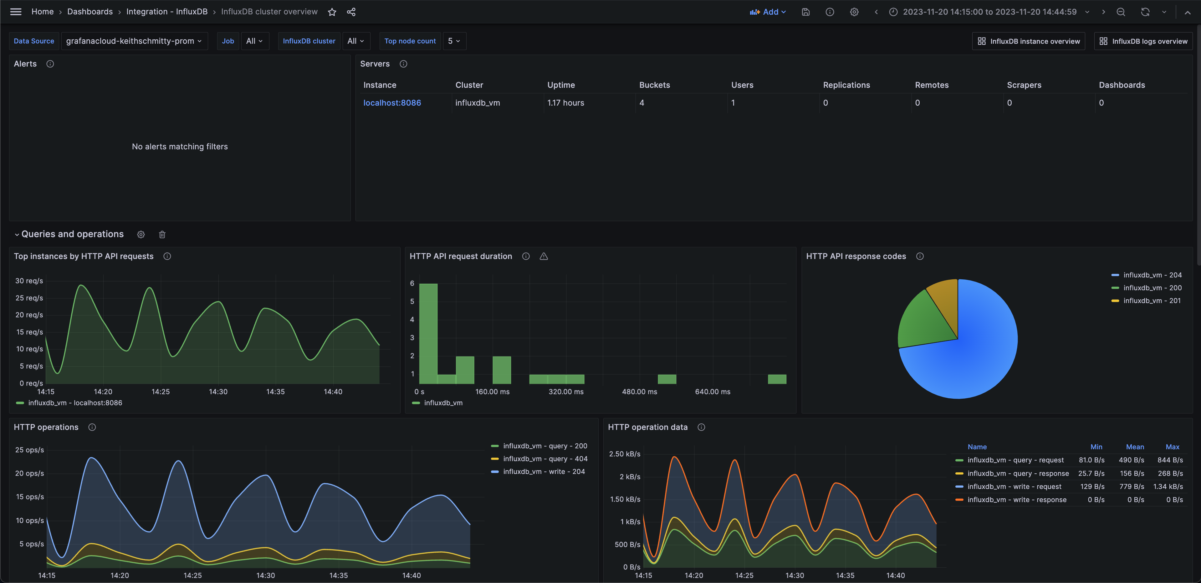

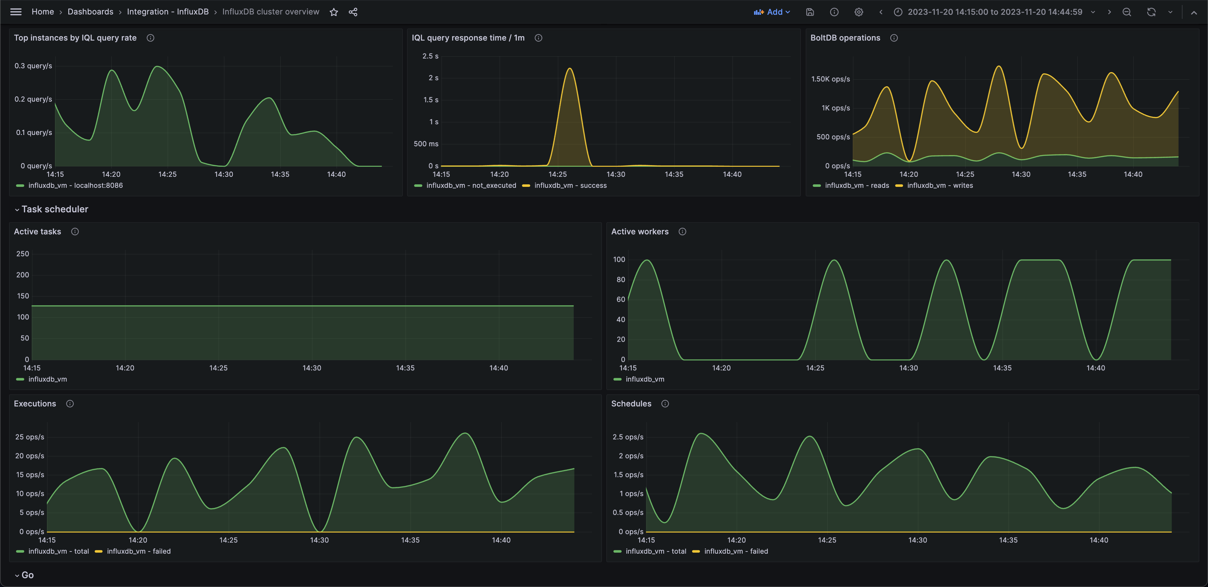

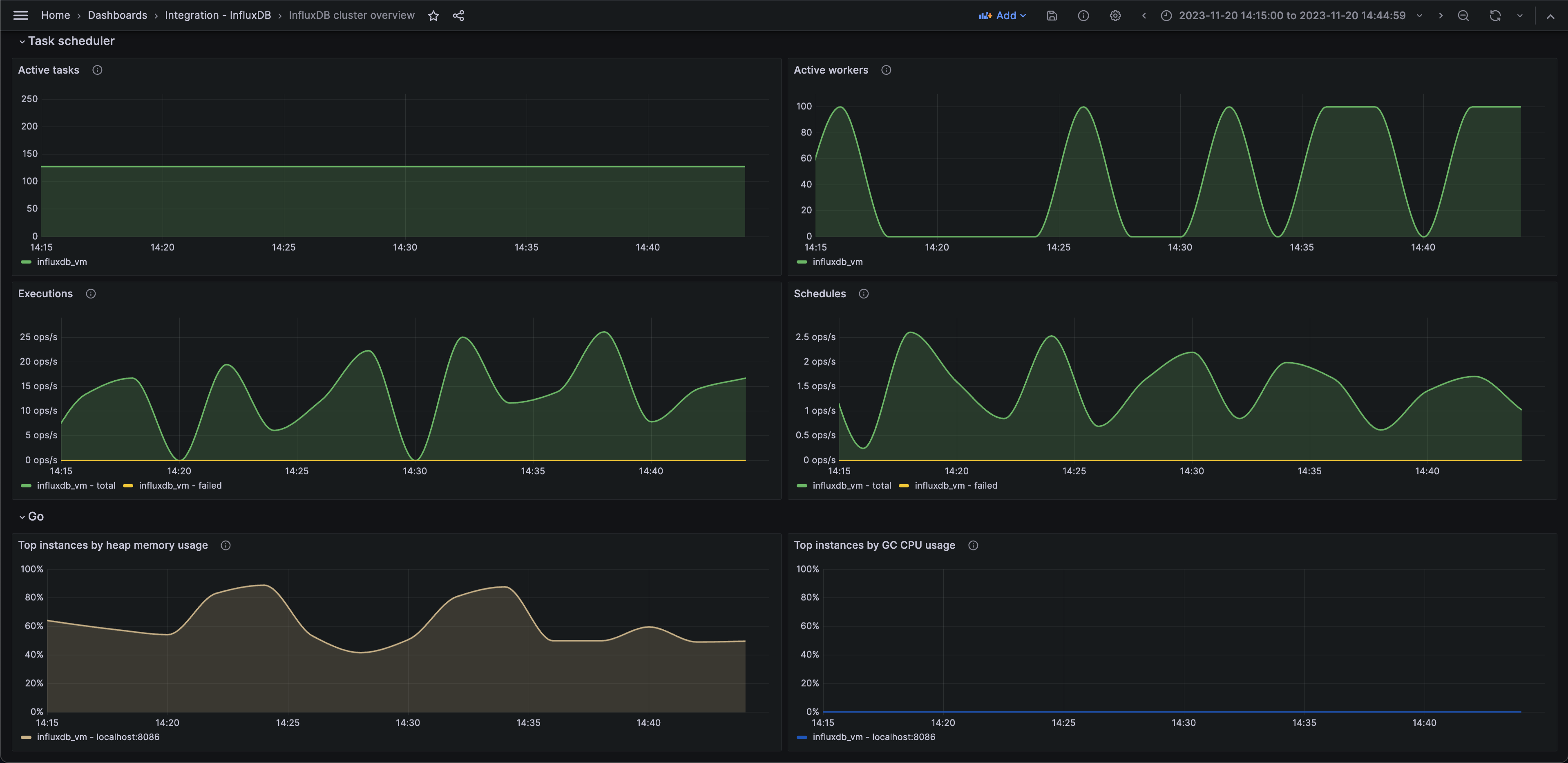

The InfluxDB integration installs the following dashboards in your Grafana Cloud instance to help monitor your system.
- InfluxDB cluster overview
- InfluxDB instance overview
- InfluxDB logs overview
InfluxDB cluster overview (queries)
InfluxDB cluster overview (tasks)
InfluxDB cluster overview (Go)
