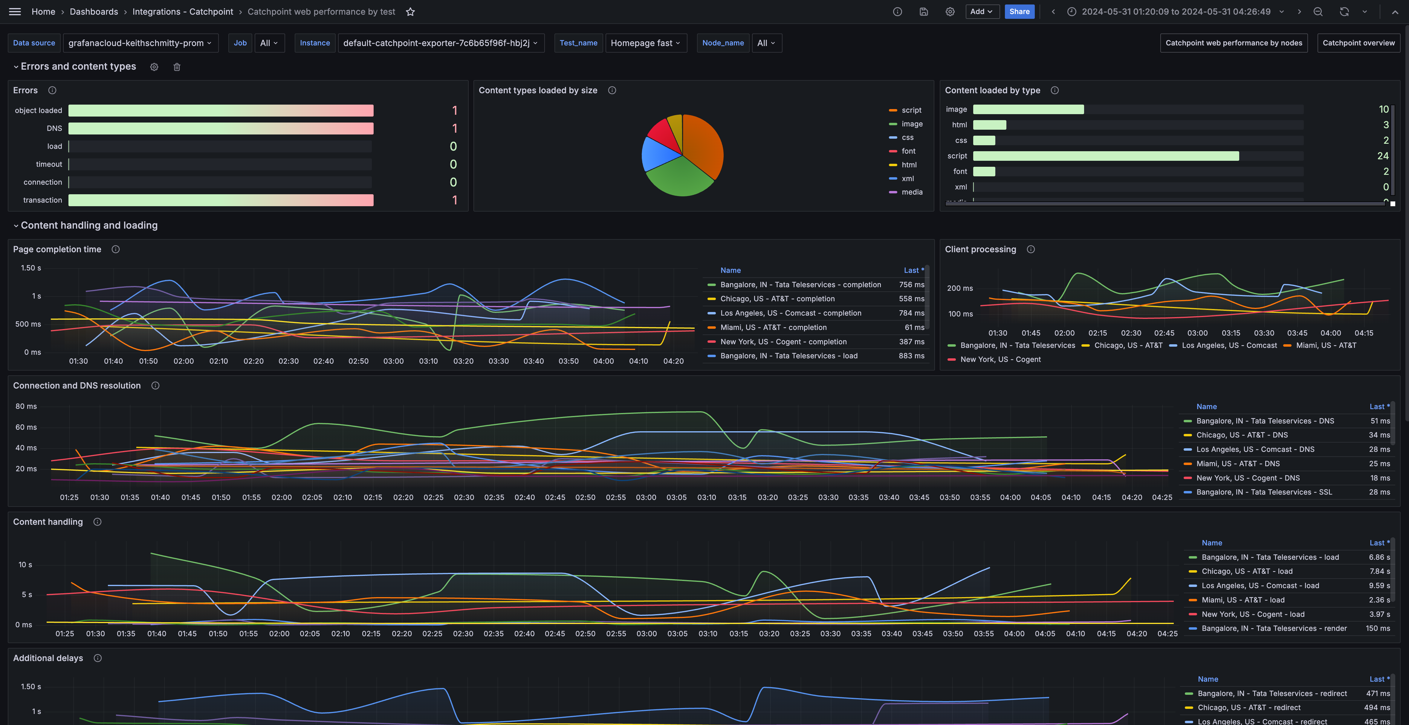

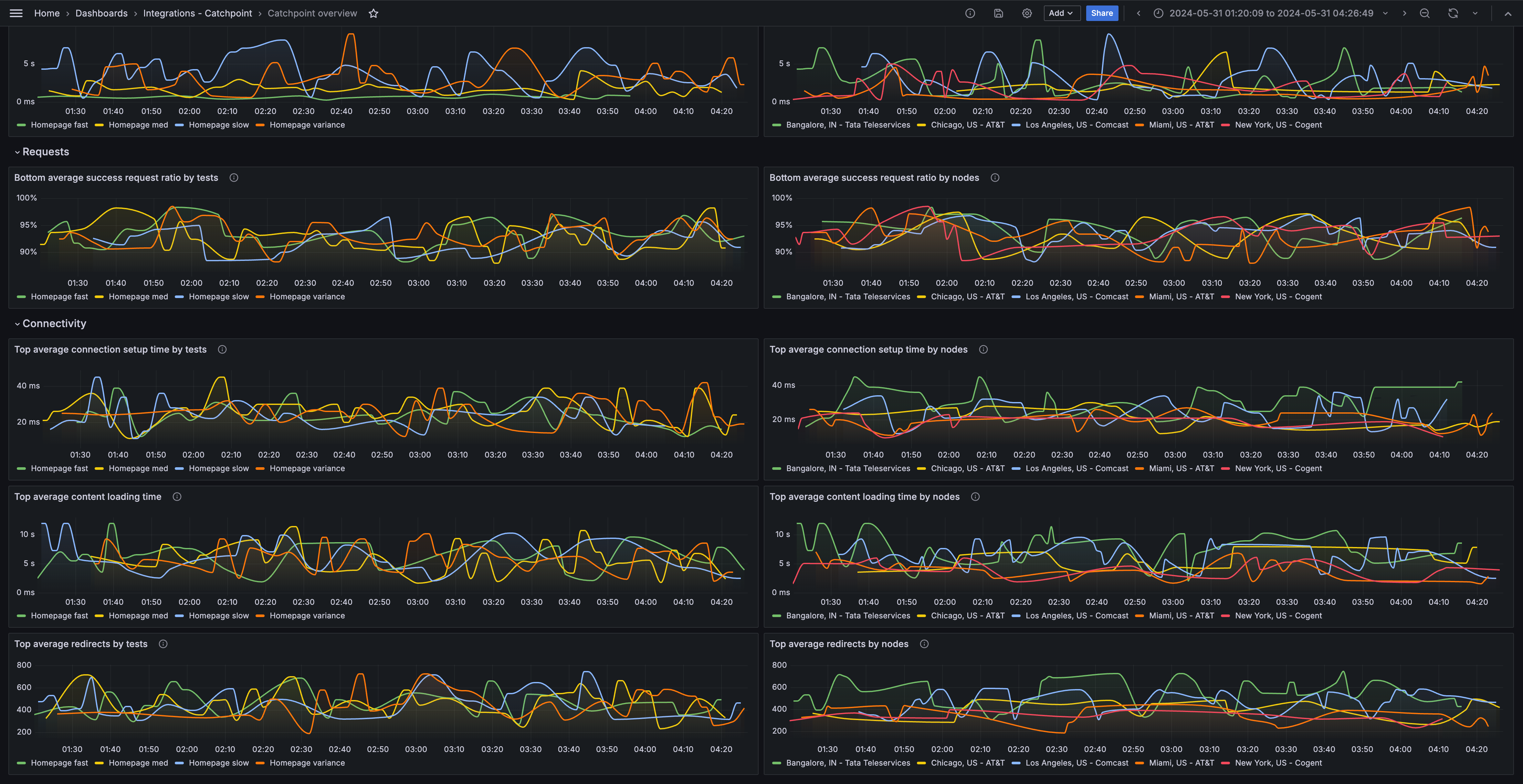

Dashboards
The Catchpoint integration installs the following dashboards in your Grafana Cloud instance to help monitor your system.
- Catchpoint overview
- Catchpoint web performance by node
- Catchpoint web performance by test
Catchpoint overview
Catchpoint overview (connectivity)
