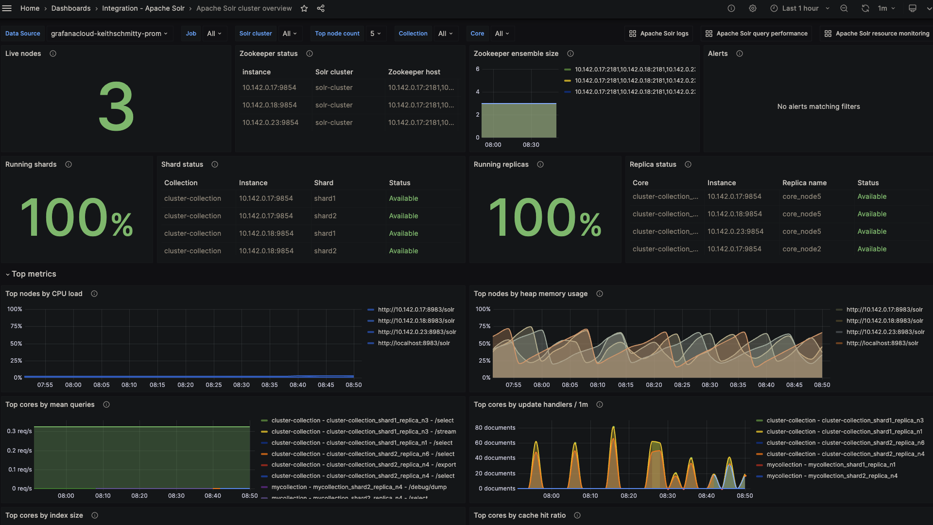

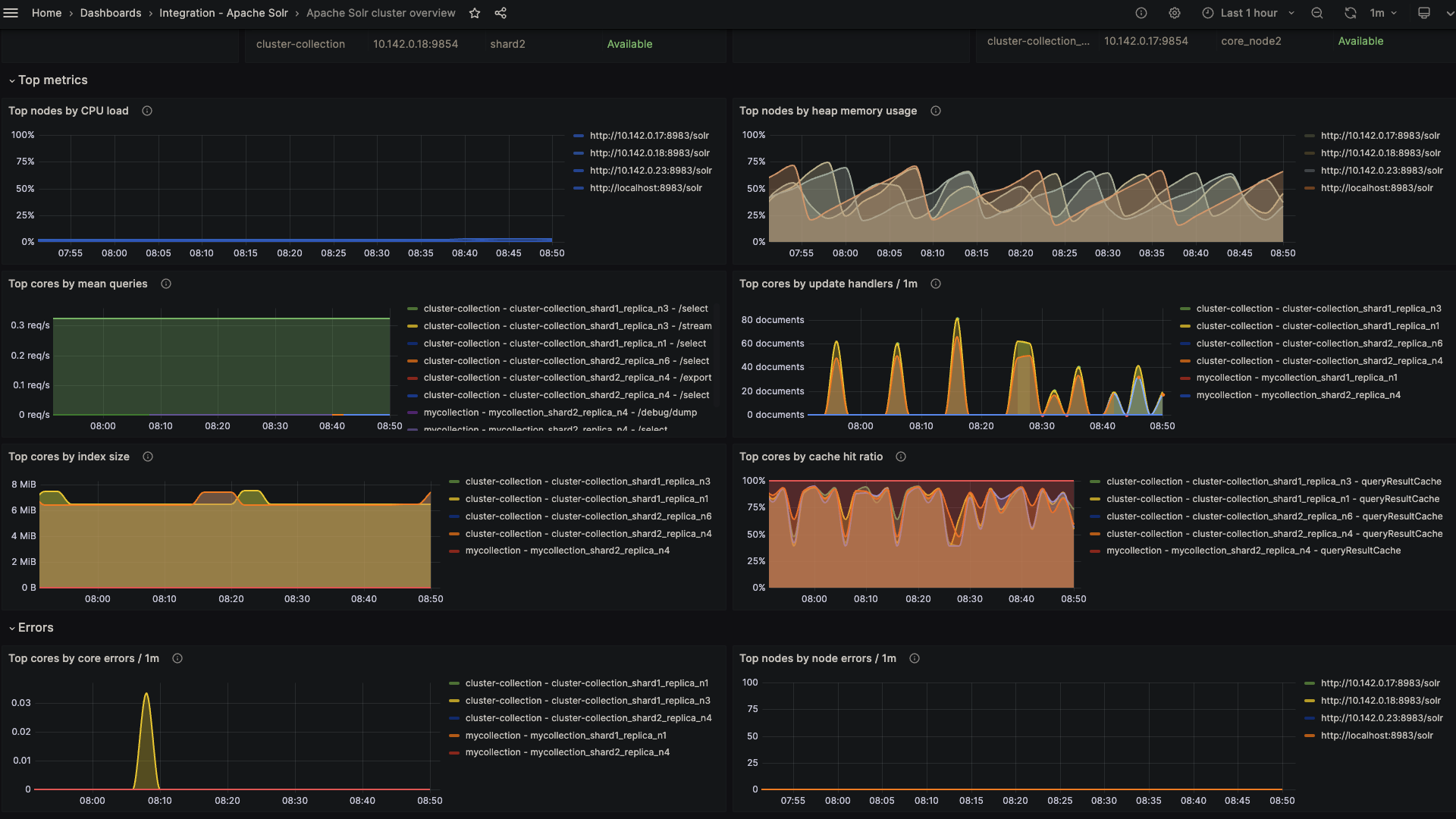

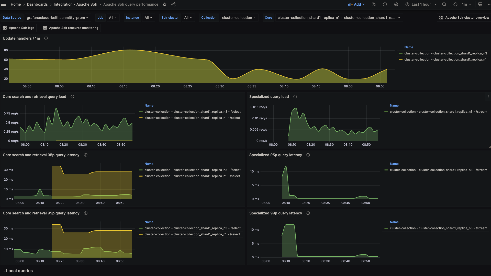

Dashboards
The Apache Solr integration installs the following dashboards in your Grafana Cloud instance to help monitor your system.
- Apache Solr cluster overview
- Apache Solr logs
- Apache Solr query performance
- Apache Solr resource monitoring
Apache Solr overview (cluster)
Apache Solr overview (top metrics)
Apache Solr query performance (latency)
