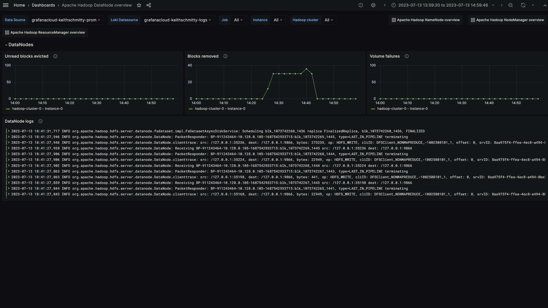

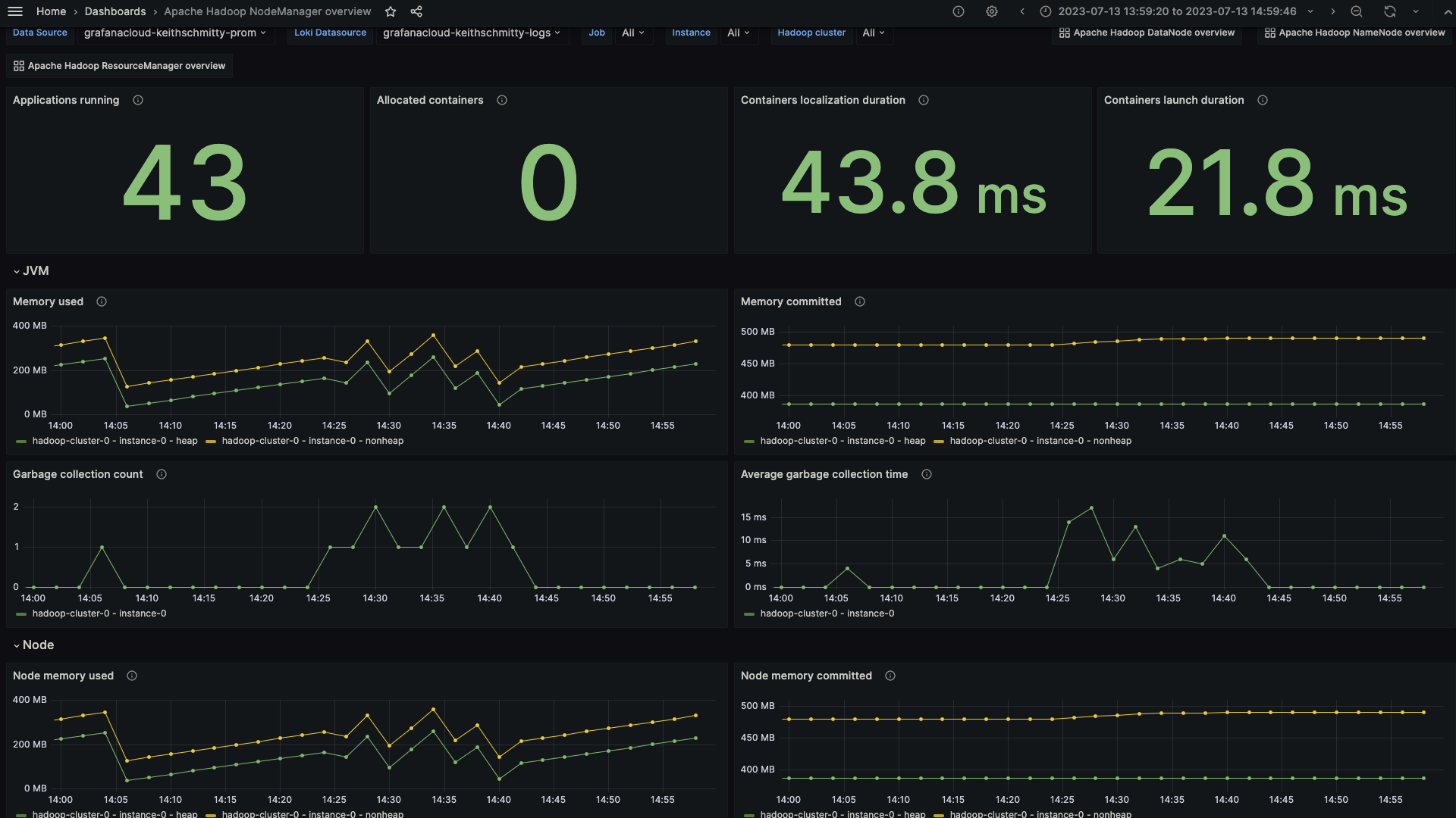

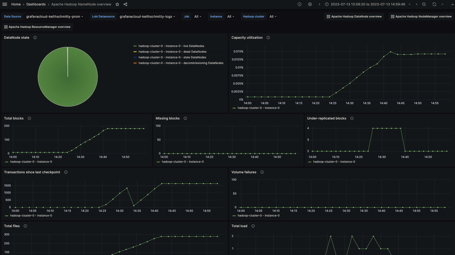

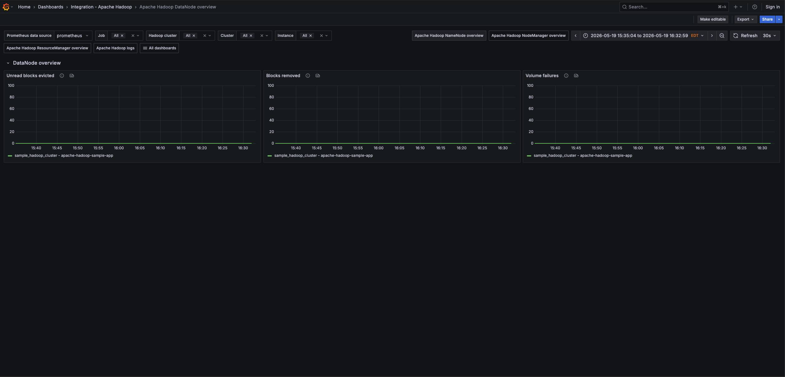

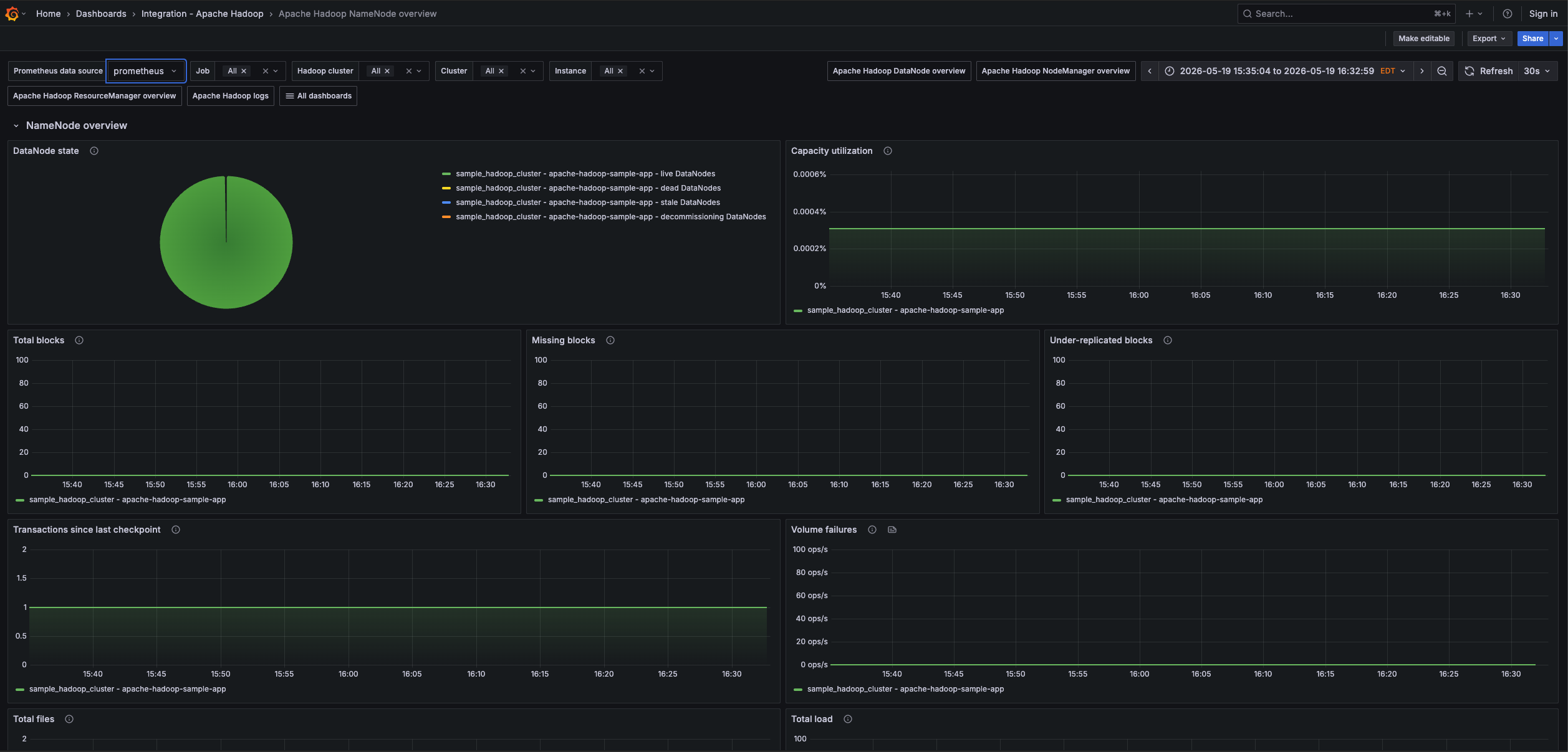

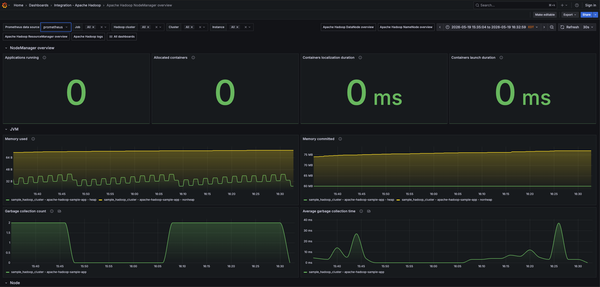

The Apache Hadoop integration installs the following dashboards in your Grafana Cloud instance to help monitor your system.
- Apache Hadoop DataNode overview
- Apache Hadoop NameNode overview
- Apache Hadoop NodeManager overview
- Apache Hadoop ResourceManager overview
Apache Hadoop NameNode overview (1/2)
Apache Hadoop DataNode overview (1/1)
Apache Hadoop NodeManger overview (1/2)
