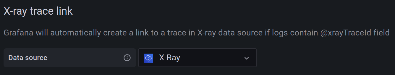

To automatically add links in your logs when the log contains the @xrayTraceId field, link an X-Ray data source in the “X-Ray trace link” section of the data source configuration.
Trace link configuration
The data source select contains only existing data source instances of type X-Ray. To use this feature, you must already have an X-Ray data source configured. For details, see the X-Ray data source docs.

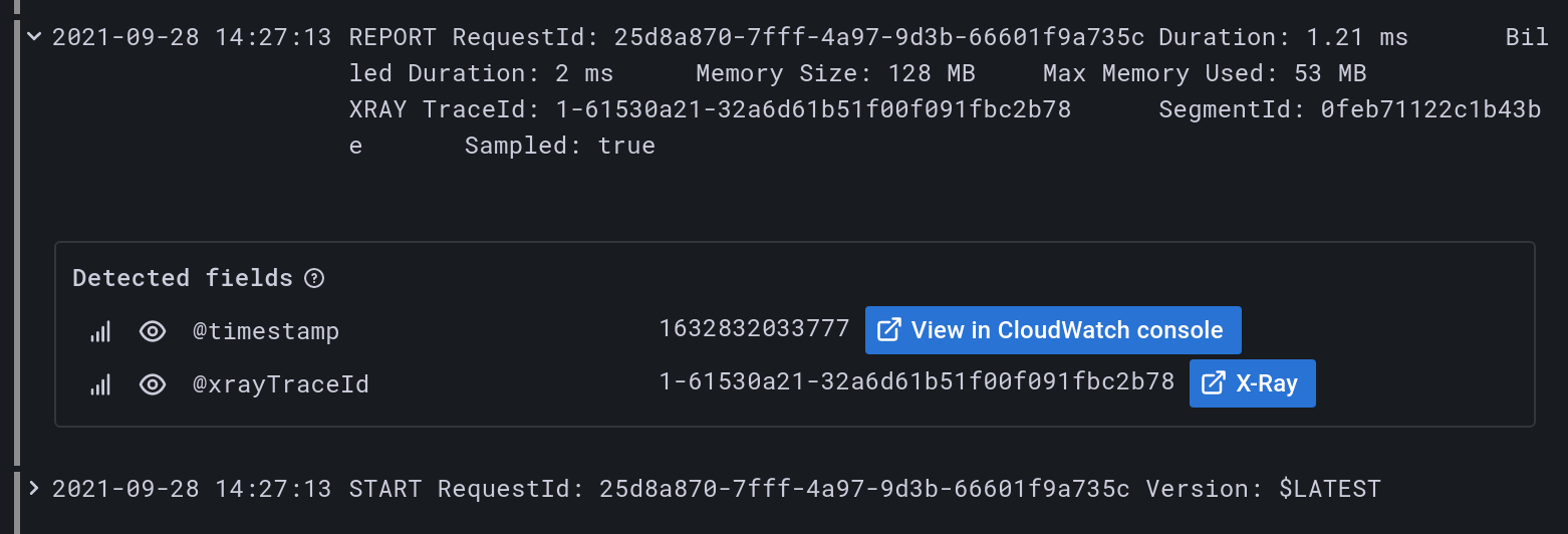

To view the X-Ray link, select the log row in either the Explore view or dashboard Logs panel to view the log details section.
To log the @xrayTraceId, see the AWS X-Ray documentation.
To provide the field to Grafana, your log queries must also contain the @xrayTraceId field, for example by using the query fields @message, @xrayTraceId.
Trace link in log details

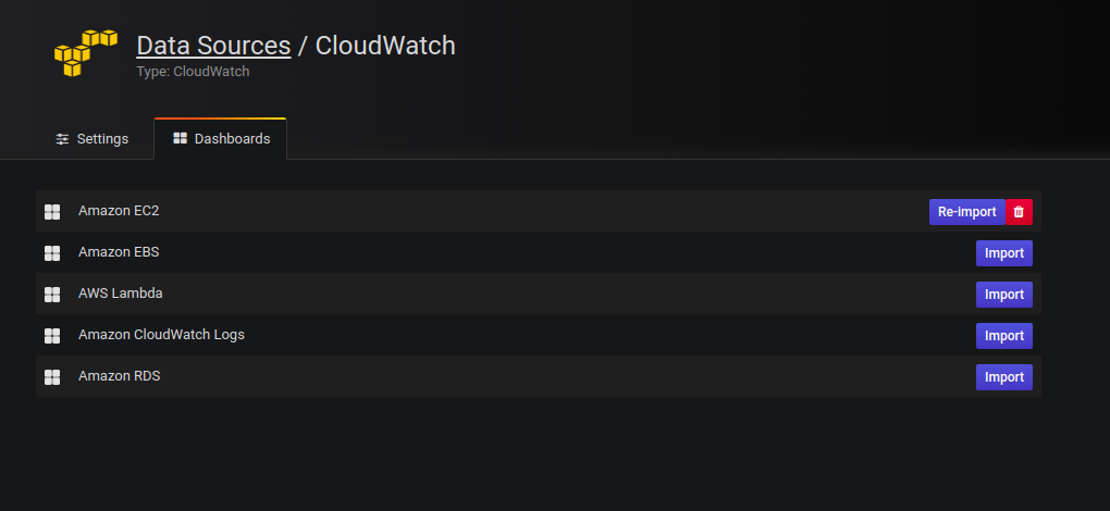

Import pre-configured dashboards
The CloudWatch data source ships with curated and pre-configured dashboards for five of the most popular AWS services:
  • Amazon Elastic Compute Cloud: Amazon EC2
  • Amazon Elastic Block Store: Amazon EBS
  • AWS Lambda: AWS Lambda
  • Amazon CloudWatch Logs: Amazon CloudWatch Logs
  • Amazon Relational Database Service: Amazon RDS
To import curated dashboards:
  1. Navigate to the data source’s configuration page.
  2. Select the Dashboards tab.
    This displays the curated selection of importable dashboards.
  3. Select Import for the dashboard to import.
CloudWatch dashboard import
To customize an imported dashboard:
To customize one of these dashboards, we recommend that you save it under a different name. If you don’t, upgrading Grafana can overwrite the customized dashboard with the new version.
