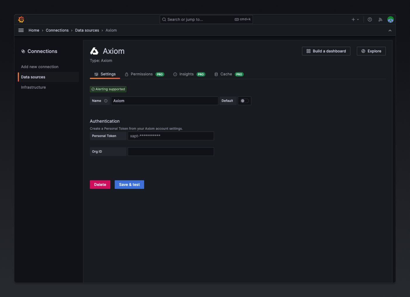

Configuration
- Add a new data source in Grafana
- Select the Axiom data source plugin
- Enter your Axiom advanced API token
- Confirm the Edge URL for your Axiom deployment. The default is
https://us-east-1.aws.edge.axiom.co - Save and test the data source

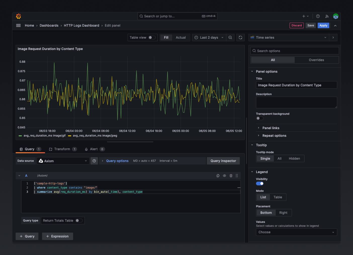

Visualizing data
The Axiom data source plugin provides a custom editor to query and visualize event data from Axiom.
- Create a new panel in Grafana
- Use the query editor to filter, transform and analyze your data
