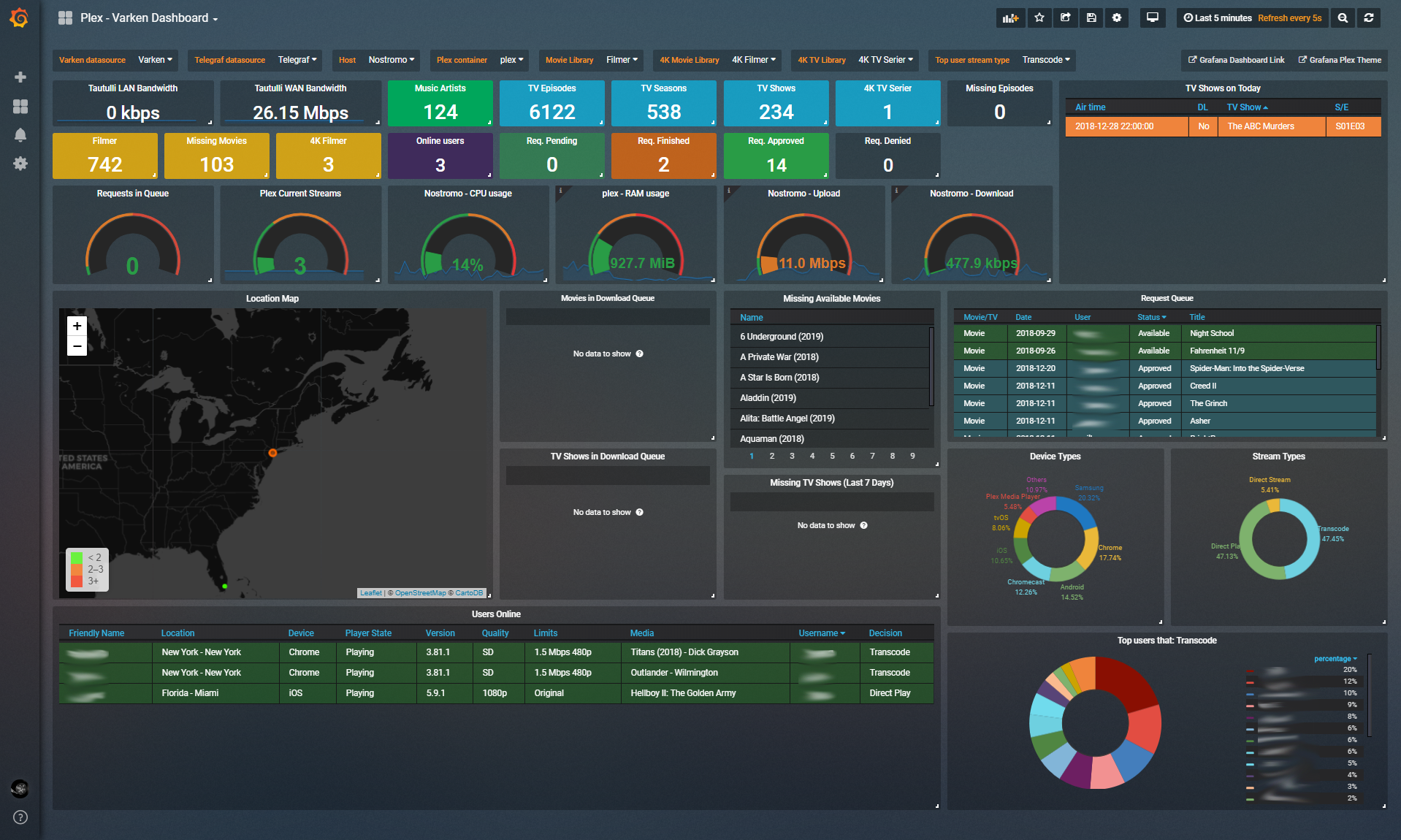

A Grafana dashboard for Varken
[Unofficial]
A Grafana dashboard for displaying Plex stats using the Varken and Telegraf docker containers.

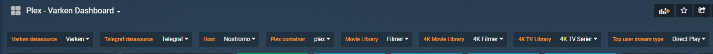

Use the variables to set the different data sources.

Screenshot
