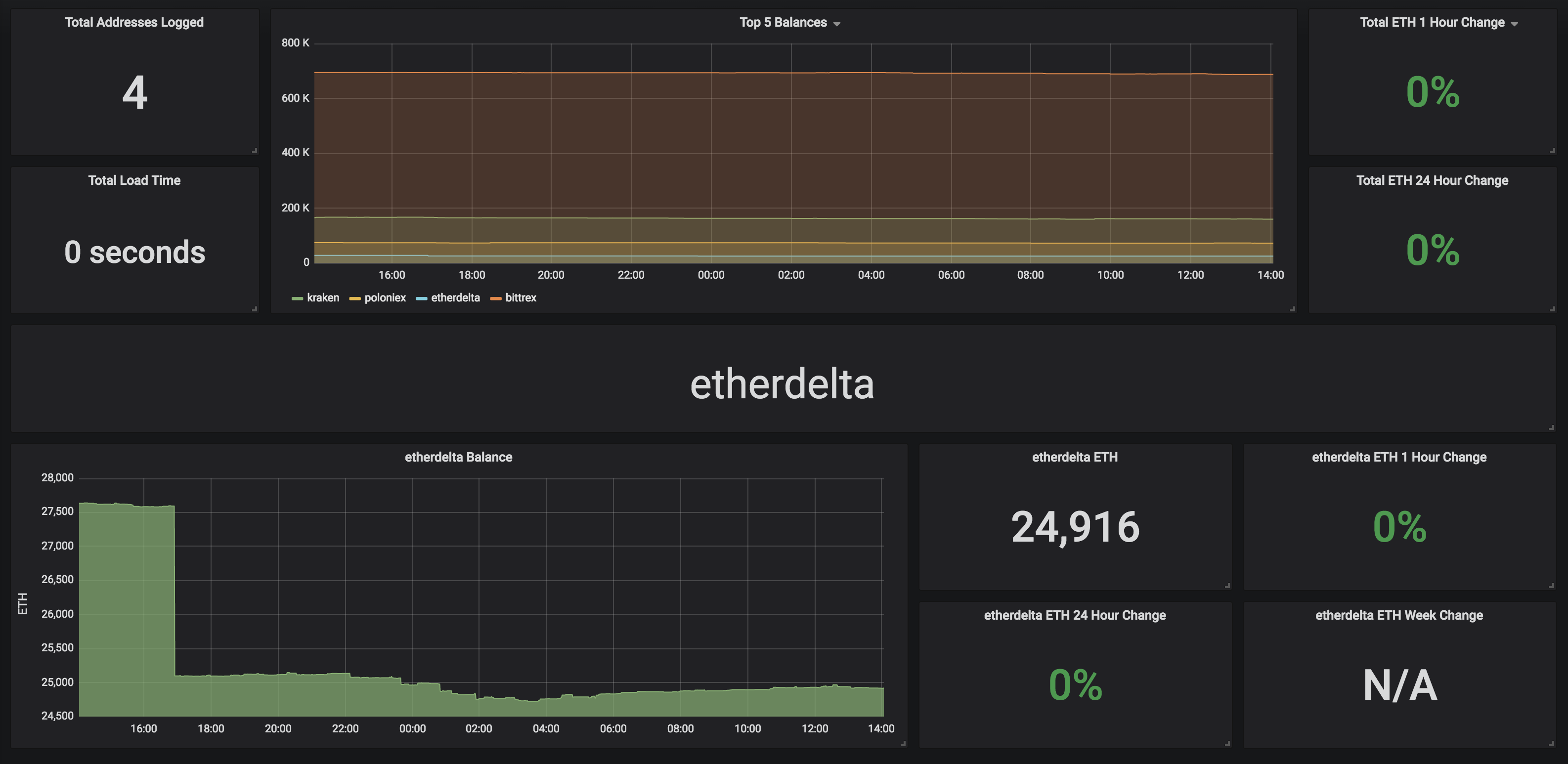

Graph Ethereum Wallet Balances with ease
Ethereum Exporter
A lightweight Prometheus exporter that will output Ethereum wallet balances from a list of addresses you specify. ETHexporter attaches to a geth server to fetch ethereum wallet balances for your Grafana dashboards. Many of you probably want to chart your ERC20 token balances, feel free to use TOKENexporter. If you also want a Bitcoin prometheus exporter, you can use BTCexporter which uses blockchain.info API.
View ETHexporter Github Repo to learn how to get this running quickly within a Docker container.

Prometheus Exporter Response
This is the /metrics response from the ETH Exporter with sample addresses.
eth_balance{name="etherdelta",address="0x8d12A197cB00D4747a1fe03395095ce2A5CC6819"} 24919.37437
eth_balance{name="bittrex",address="0xFBb1b73C4f0BDa4f67dcA266ce6Ef42f520fBB98"} 687509.5097
eth_balance{name="poloniex",address="0x32Be343B94f860124dC4fEe278FDCBD38C102D88"} 72284.47401
eth_balance{name="kraken",address="0x267be1c1d684f78cb4f6a176c4911b741e4ffdc0"} 159592.0022
eth_balance_total 944305.360280000022612512
eth_load_seconds 1.15
eth_loaded_addresses 4
eth_total_addresses 4
