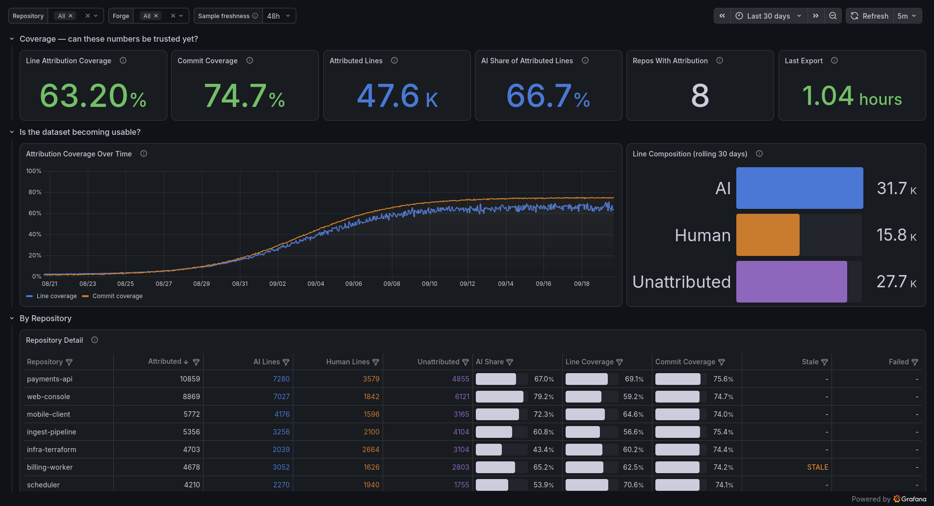

Read coverage before you read anything else
git-ai can only attribute commits made after it was installed, so on a real repository almost every line starts out unattributable. A straight "% AI written" would read near zero for weeks and tell you nothing.
So the dashboard leads with coverage, meaning the share of lines and commits that carry any attribution at all, and every percentage sits next to the sample size behind it. Until coverage is worth something, read this as an adoption dashboard and not a productivity one. The repository table sorts on attributed lines, not on AI share, for the same reason. A repo with three attributed lines shouldn't look authoritative.
Panels
The top row is coverage: line and commit coverage, the attributed-line count, AI share of attributed lines, repos reporting, and how long ago the exporter last ran.
Below it, coverage over time, which is the panel that answers whether any of this is becoming worth reading. Beside that, the absolute split of AI, human and unattributed lines.
One row per repository follows, carrying its attributed lines, AI share, both coverage figures, and whether the numbers are stale or missing entirely.

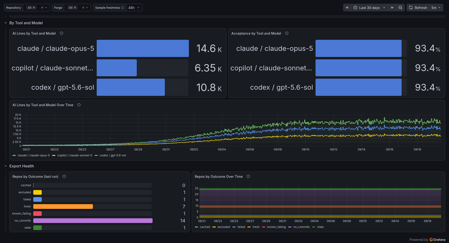

Tool and model pairs stay distinct. Collapsing them on the model name merges Copilot serving Sonnet with Claude Code serving Sonnet, and their acceptance rates aren't the same.
Last comes export health: every repo by outcome, fresh, cached, stale, failed, excluded or no commits in the window, with a run timestamp. Without it, a repo that vanishes from a chart and a repo the exporter couldn't read look identical.
