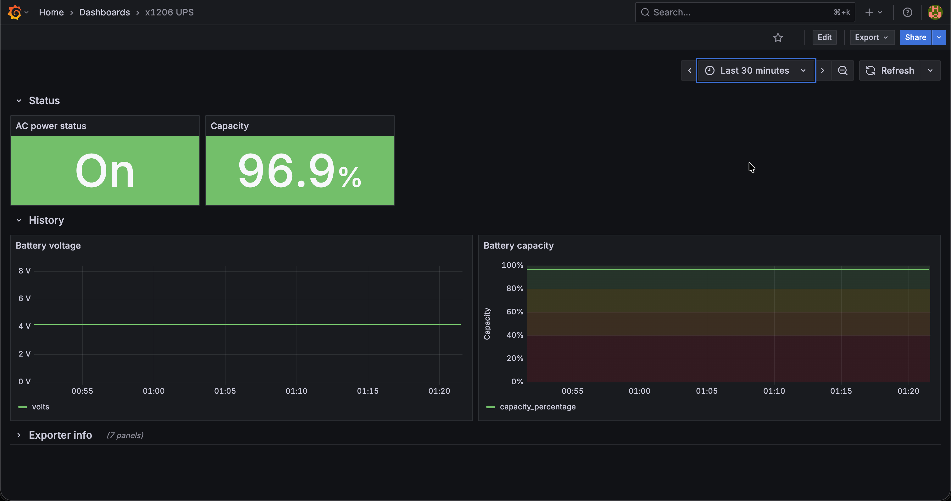

Dashboard to monitor Suptronics X1206 UPS mounted on Raspberry PI5. This board requires exporter from simonjur/x1206-docker-nodejs-rpi5-monitor.
Dashboard provides:
UPS overview: battery voltage and capacity (%) stats
Timeseries data - same as above only plotted on timeline

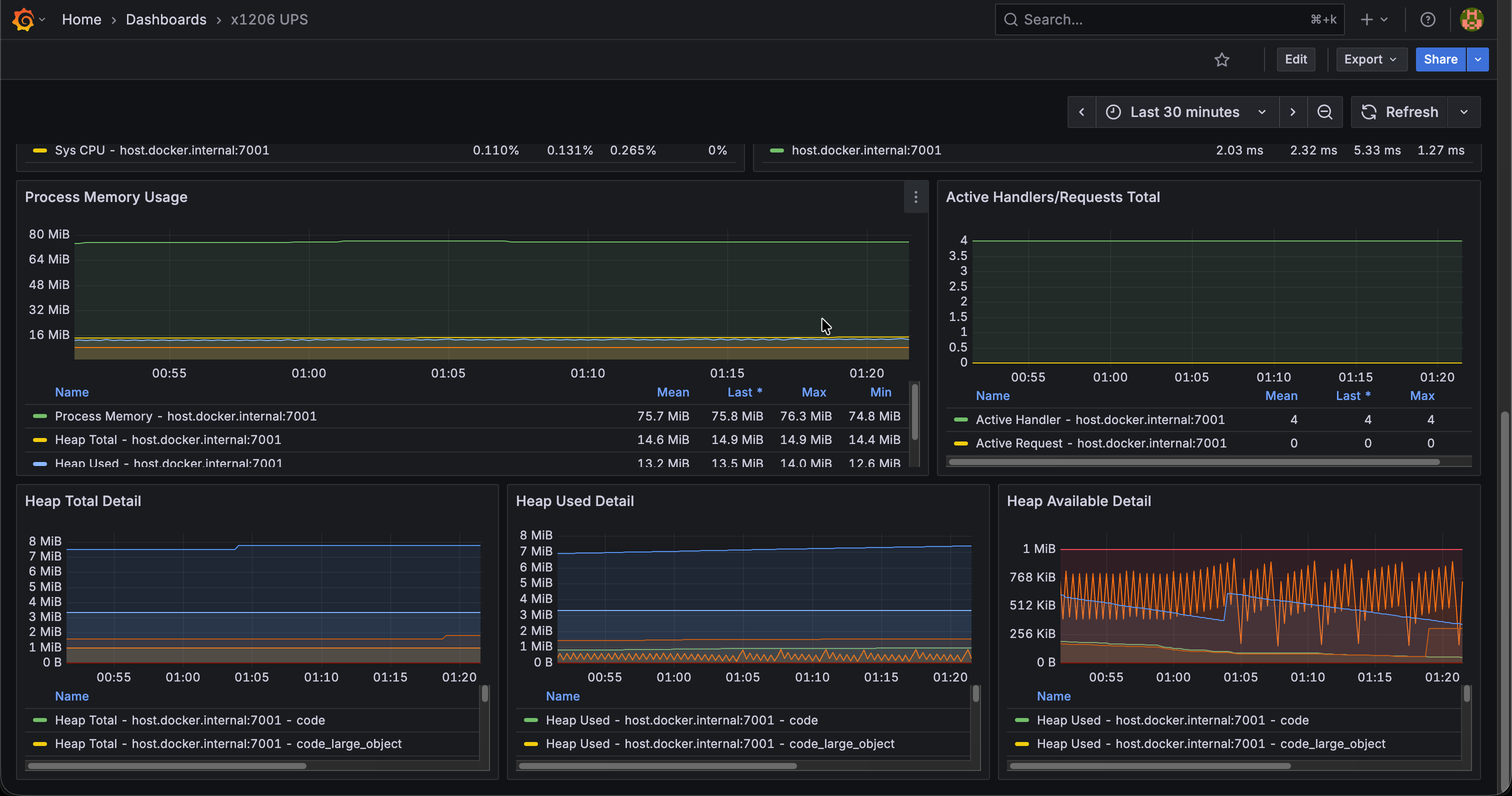

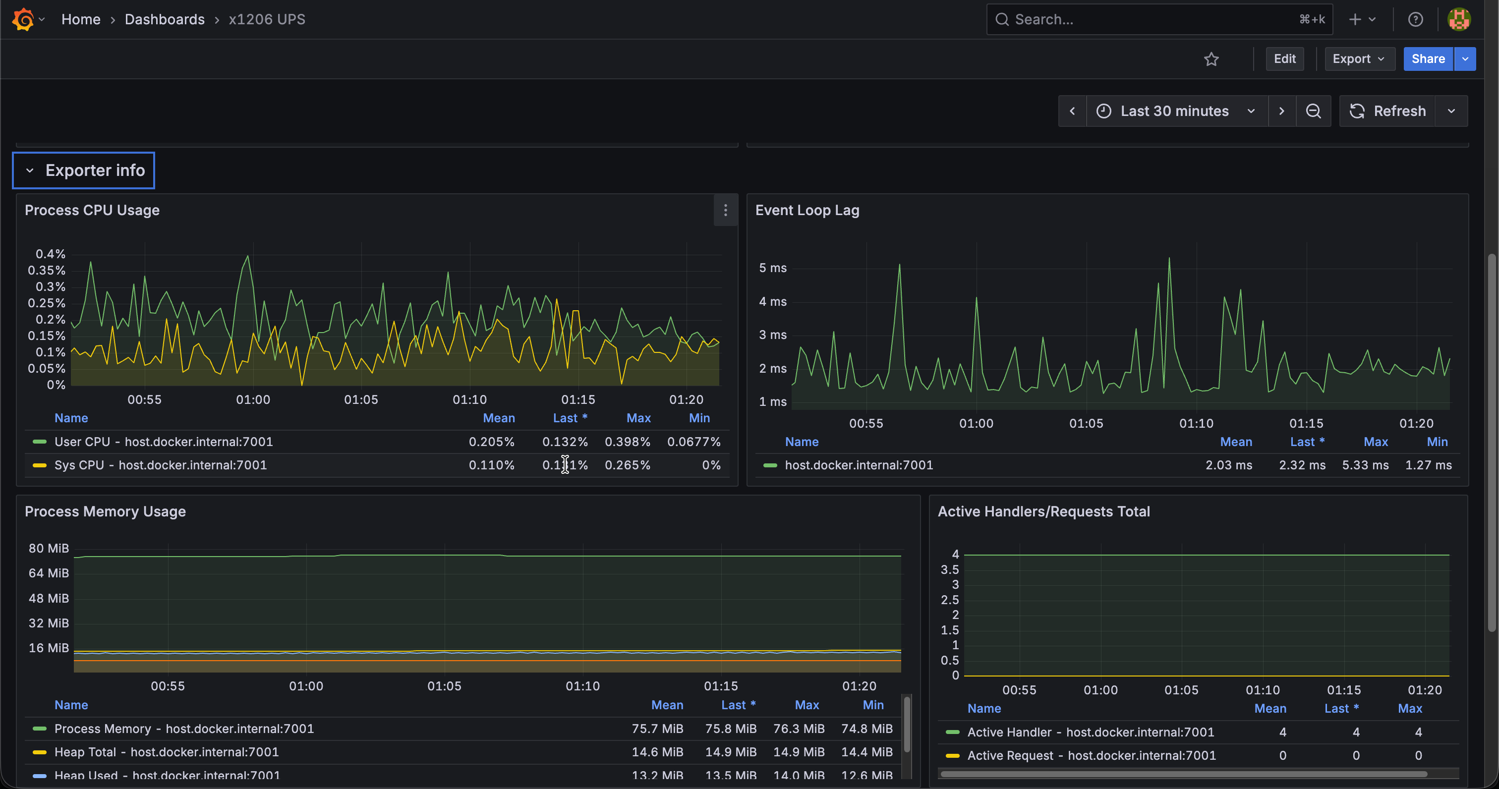

Exporter info - some stats of nodejs process running in docker container (taken from nodejs dashboard)

- to make node process stats work, you have to specify exporter hostname with port as it is available to prometheus (in my case it runs on localhost, port 7001, so within docker this will be host.docker.internal:7001)
