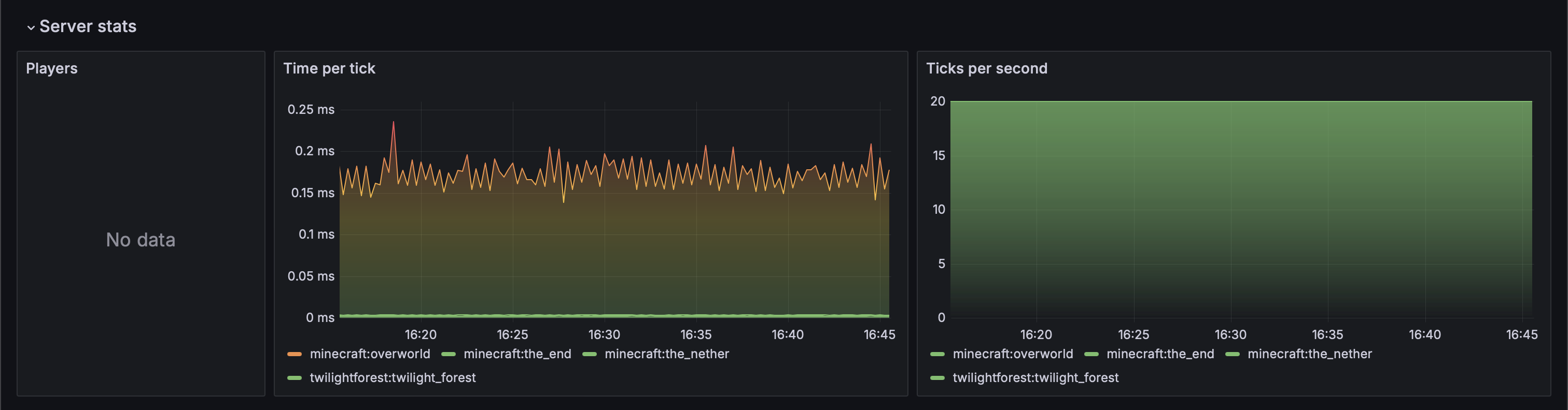

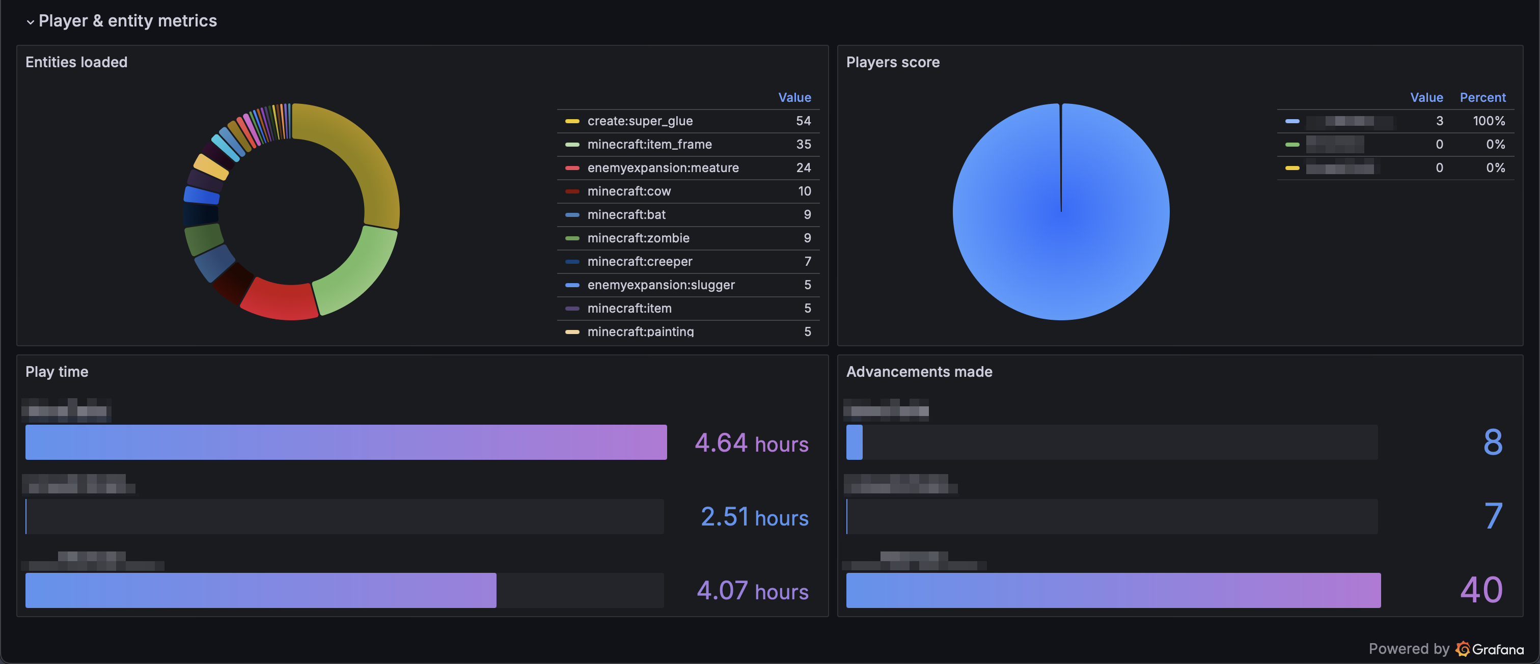

Minecraft server stats [Prometheus]
Modern dashboard for minecraft-prometheus-exporter https://github.com/Joshi425/minecraft-exporter
Minecraft server stats [Prometheus] screenshot 1
Minecraft server stats [Prometheus] screenshot 2
