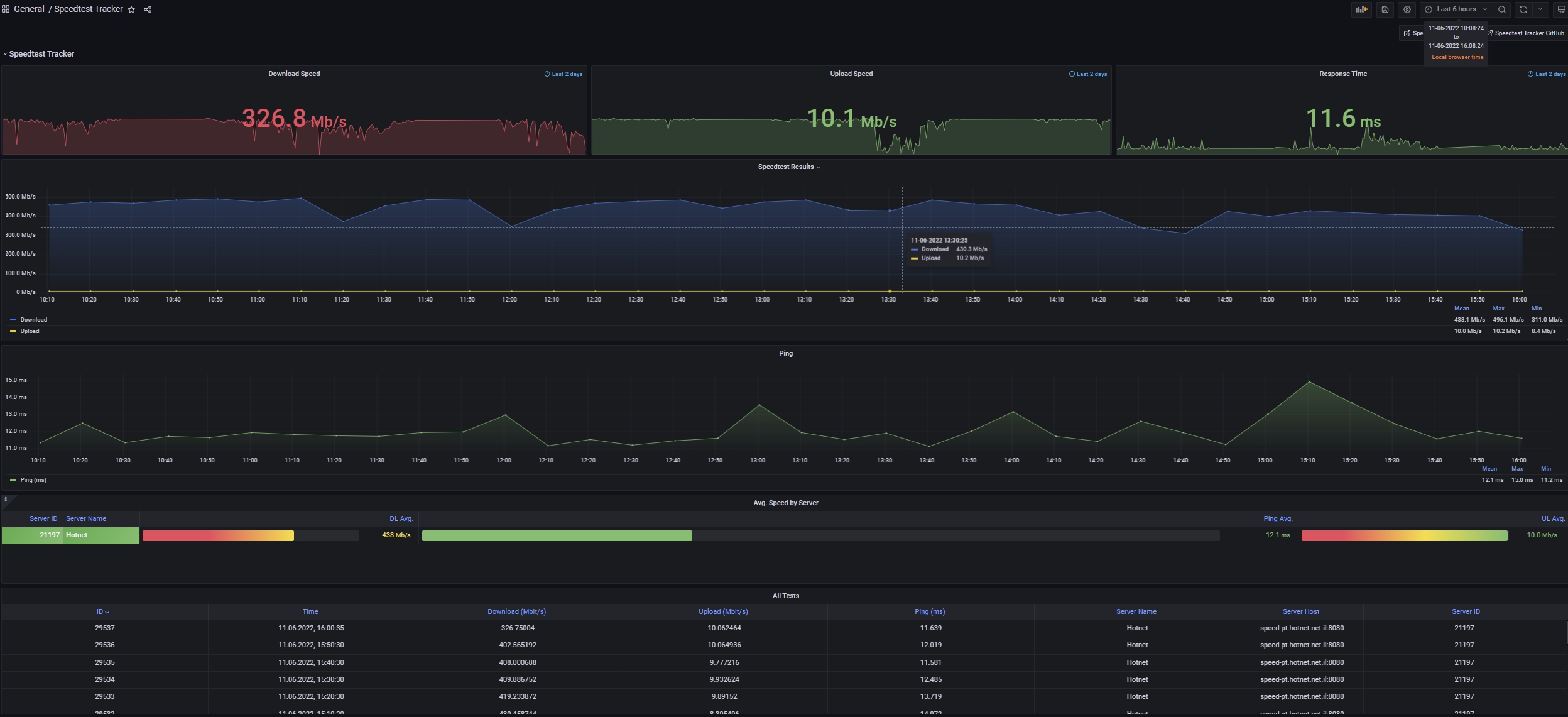

A dashboard to display data exported by Speedtest Tracker to InfluxDBv1 on bucket in InfluxDBv2. (So we can use InfluxDBv2 with Speedtest Tracker witch support only InfluxDBv1 , for now)
Guide for using Influxdb v2 with Speedtest-Tracker Avalible Now at Grafana Dashboard 16428 (https://grafana.com/grafana/dashboards/16428-speedtest-tracker) (https://github.com/masterwishx/speedtest-tracker-influxdbv2)
This dashboard shows data collected by Speedtest Tracker (https://github.com/henrywhitaker3/Speedtest-Tracker) and exported in an InfluxDBv1 database witch is connected to InfluxDBv2 bucket.

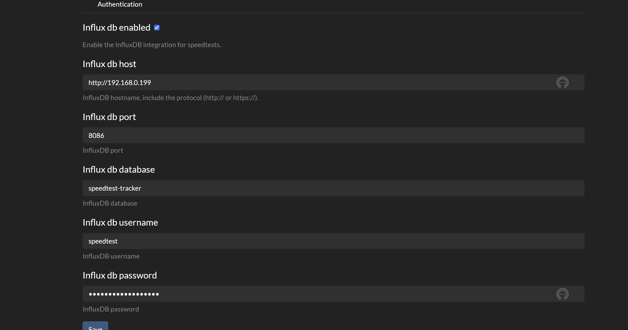

  1. Config Client of InfluxDBv1(Speedtest-tracker) by entered data : db username, db pass , etc …

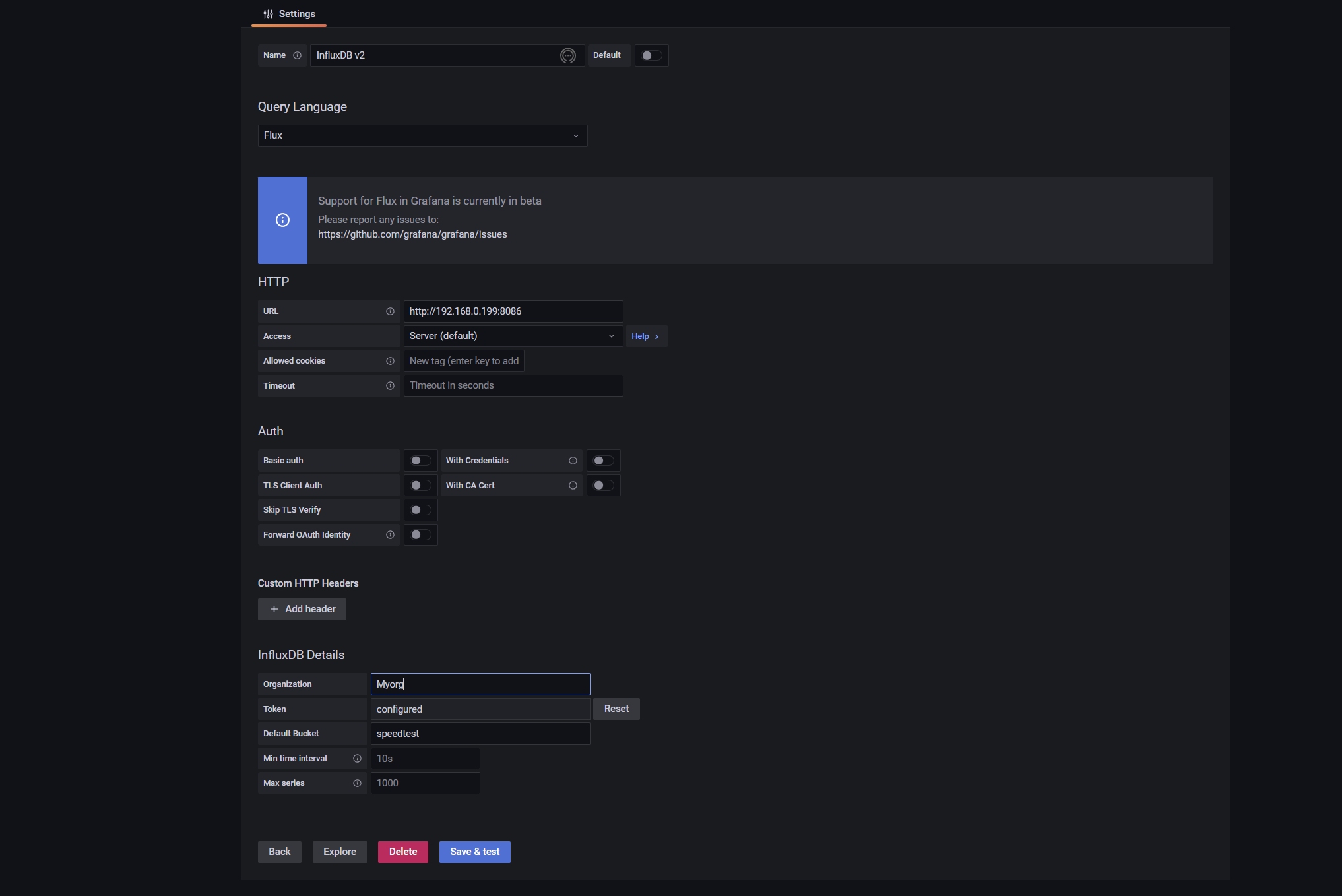

  4. Configure Grafana to use with data from InfluxDBv2 ( select datasource = InfluxDB , Query Language = Flux ,Organization = yourorg , Bucket = speedtest , Token = yourtoken for bucket )
  5. import this script in Grafana Dashboard .
  6. Enjoy
Based on https://grafana.com/grafana/dashboards/16339
