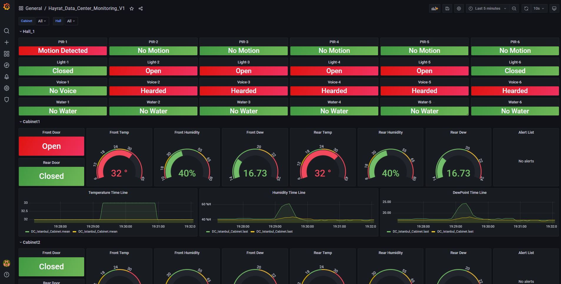

Data Center Temperature, Humidity, DewPoint, Cabinet Door Access, Voice, Light and Water Sensor Monitoring on Grafana Dashboard.
Hayrat Data Center Monitoring
Data Center Temperature, Humidity, DewPoint, Cabinet Door Access, Voice, Light and Water Sensor Monitoring on Grafana Dashboard. This project is the cheapest monitoring solution in the world. :) It can be scalable using multiple base units and aggregate in a central database. Different sensors can be added and Thousands of sensors can be tracked. Have a good time!

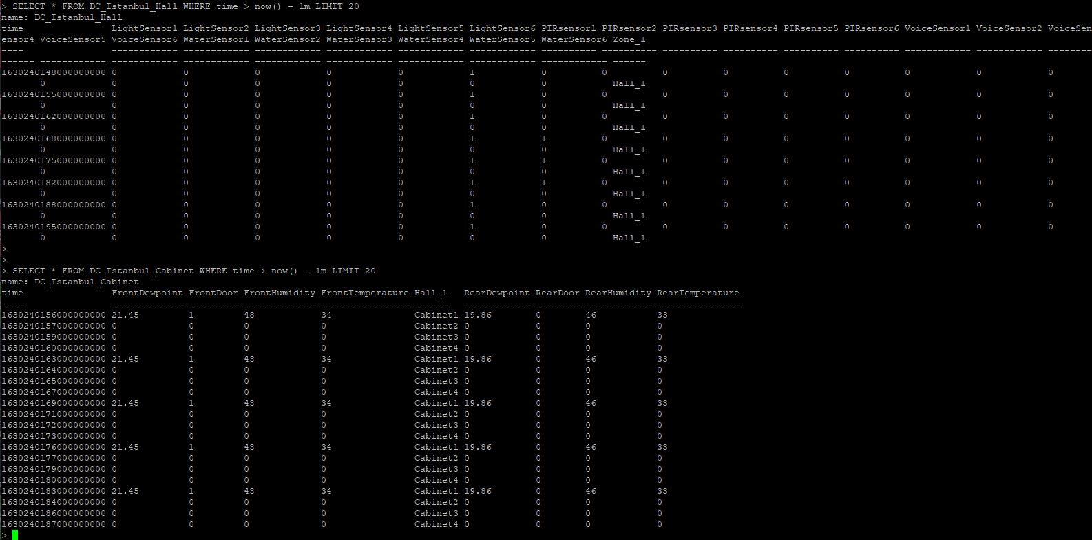

- InfluxDB (Time Series Database)
- Grafana (Dashboard)
