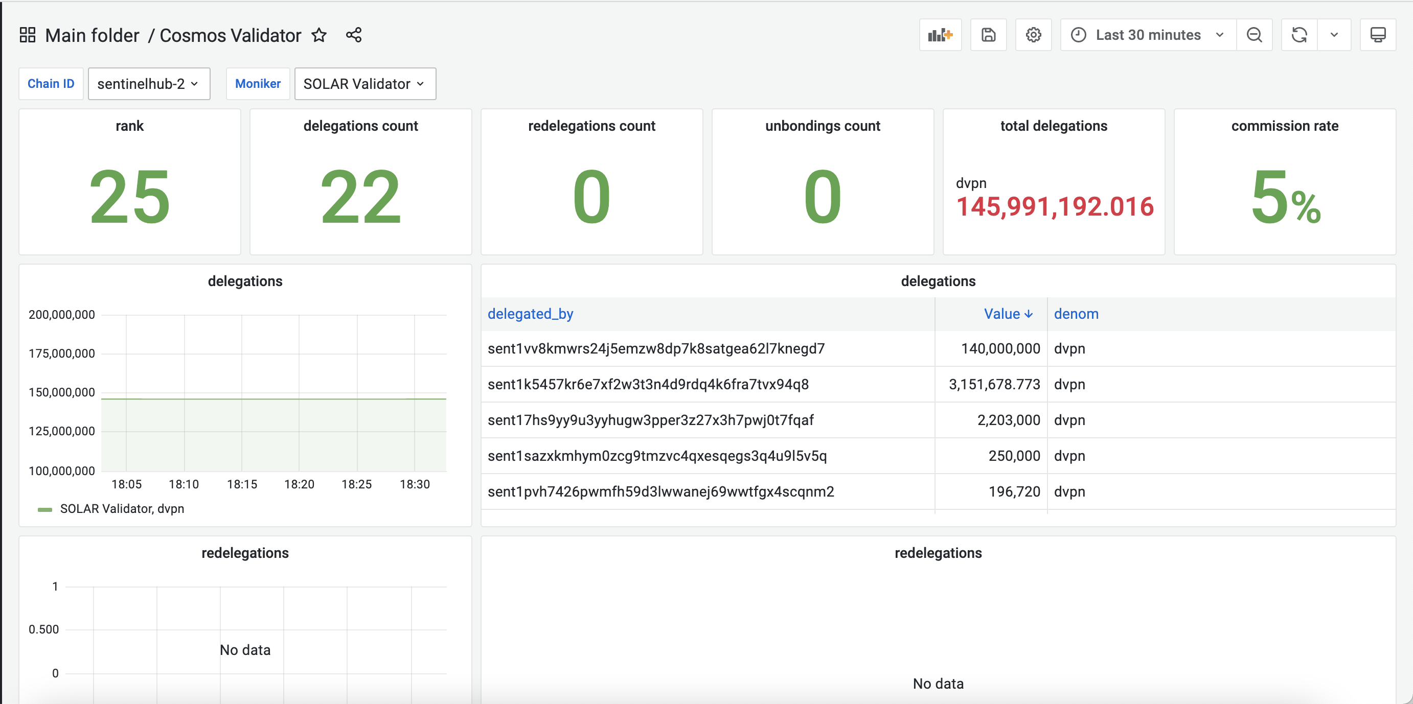

Stats of a Cosmos validator
Display the stats of a validator on a Cosmos-based blockchain (such as Sentinel, Cosmos, Persistence, Osmosis, Akash etc.).
Made by SOLAR Labs with <3.
To set it up, you’ll need a few things:
  • Grafana
  • Prometheus
  • cosmos-exporter - a Prometheus scraper for Cosmos-based blockchain written by us
  • a full node of the chain (preferably not the validator node, as it consumes quite a lot of resources)
  • cosmos-exporter scraping port (9300 by default) should be accessible from the Prometheus host, consider that if you’re using a firewall
Then it should be sufficient to just set up Grafana to use Prometheus as a data source and this should work out of the box.
