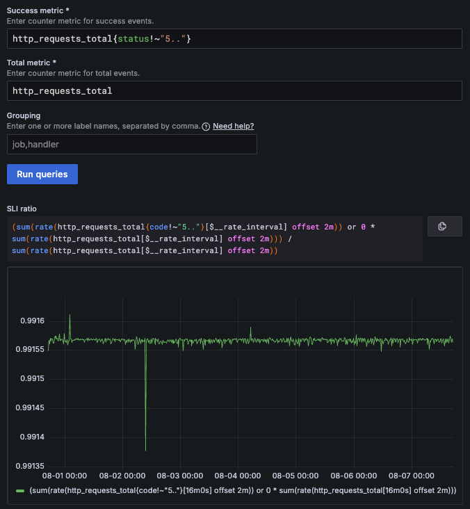

Ratio query builderValueDescription
Success metrichttp_requests_total{status!~"5.."}Metric for success requests
Total metrichttp_requests_totalMetric for total requests
Grouping(leave empty)Creates a single SLI dimension
See the multidimensional SLI example
Click Run queries to generate the final SLI ratio query:
promql
# rate of successful events
  sum(rate(http_requests_total{status!~"5.."}[$__rate_interval] offset 2m))
  or 0 * sum(rate(http_requests_total[$__rate_interval] offset 2m))
# rate of total events
The auto-generated SLI query includes several common elements for building reliable SLIs and uses the ratio of successful event rates formula:
Success ratio = rate of successful events (over a period)
                rate of total events (over a period)
Numerator: rate of successful events
promql
# rate of successful events over the rate interval
  • http_requests_total{status!~"5.."}: Returns only successful requests.
  • rate(...[$__rate_interval]): Calculates the per-second rate of successful requests over the recommended rate interval.
  • offset 2m: Shifts the query two minutes into the past to account for scrape or data ingestion delays.
  • sum(...): Aggregates across all series (dimensions) to get the total success rate.
  • or 0 * sum(rate(http_requests_total...)): Fallback for missing data. If the success metric returns no data, it returns 0 when dividing by total events.
Denominator: rate of total events
promql
# rate of total events over the rate interval
The denominator calculates the rate of all events. It applies the same rate function and offset as the numerator to ensure alignment.
The final SLI query returns a ratio between 0 and 1, representing the proportion of successful requests. The Grafana SLO wizard displays the final SLI query and a graph of its results:
Screenshot of the Grafana SLO wizard creating an SLI for HTTP availability
Note that you can also use the Advanced option to create the same SLI query directly.
