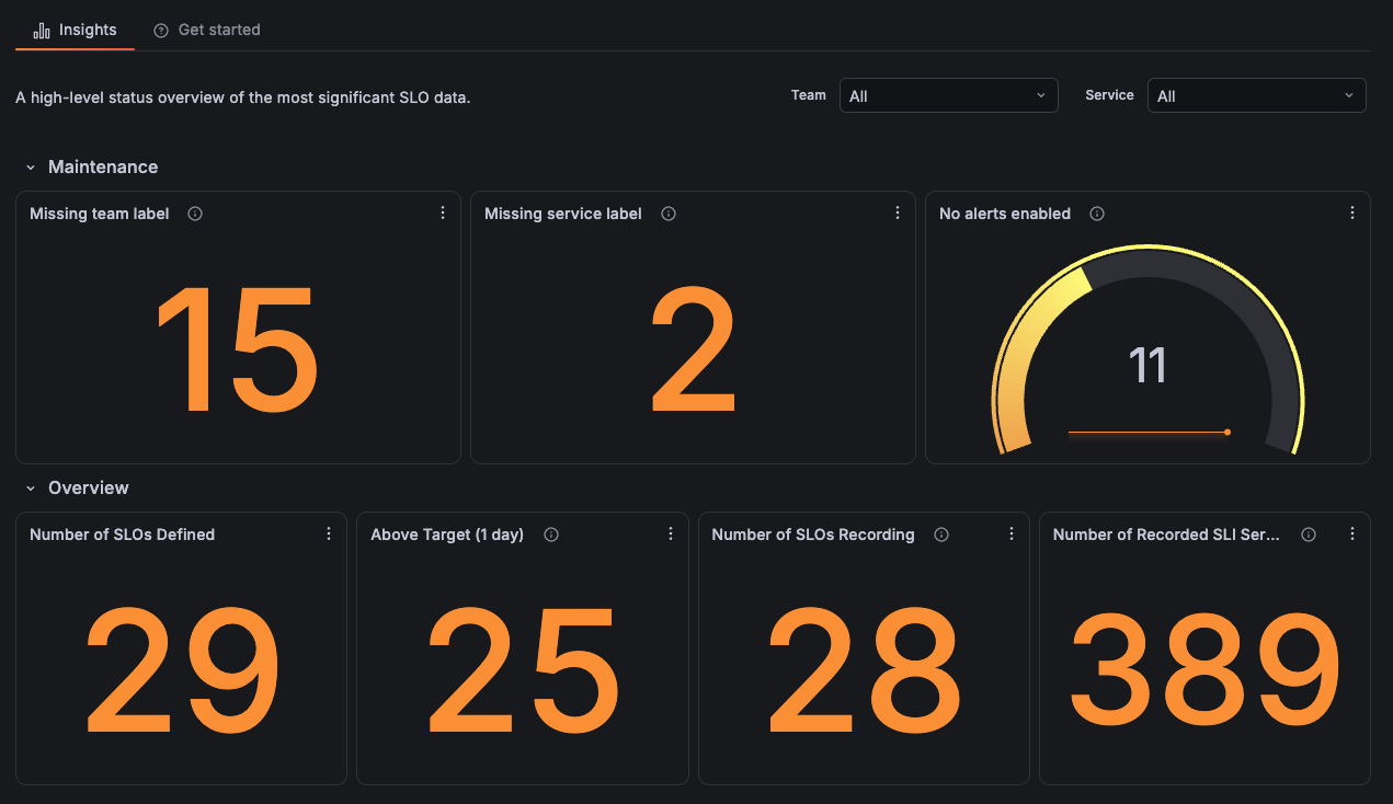

To view the number of active series generated by your SLOs, open the Insights tab on the SLO homepage and check Number of Recorded SLI Series:
![Grafana SLO Insights tab showing the number of recorded SLI series]()

Number of Recorded SLI Series × (cost per 1,000 active series ÷ 1,000)In the example above, 29 SLOs generate 389 active SLI series. At a price of $6.50 per 1,000 active series, the estimated cost is $2.52 per month.
389 × ($6.50 ÷ 1,000) = $2.52SLO limits
