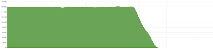

Before proceeding to the next step, use the following query to ensure that there are no write requests to the ingesters from zone-a:
sum by(route) (
  rate(
    cortex_request_duration_seconds_count{
      namespace="<your-namespace>",
      container="ingester",
      pod=~"ingester-zone-a-.*",
      route="/cortex.Ingester/Push"}[5m]
You should see something like this:
No More Write Requests
