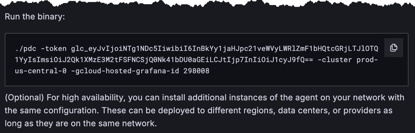

  3. If you are using the standalone binary, in Grafana Cloud copy the command in the Run this binary field.

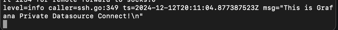

  4. If you are using the standalone binary, in your server terminal run the command you copied.
    You should receive a success message indicating that the PDC agent is running.
