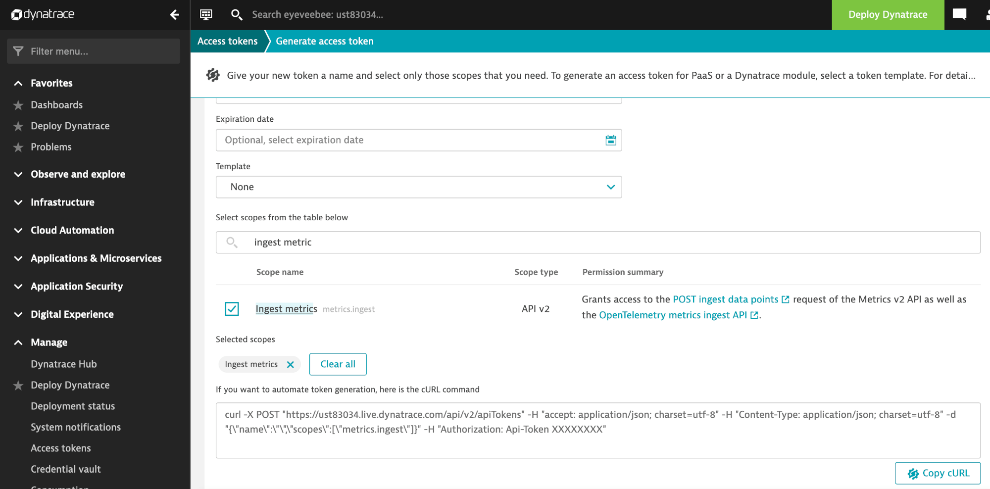

Create a Dynatrace API token to send the data.
Caution
The Dynatrace API Token must have the scope name “metrics.ingest” (scope type
API v2).
You can use the Dynatrace UI:
Or a curl command (replace <environment-id> and the Api-Token):
curl -X POST "https://<environment-id>.live.dynatrace.com/api/v2/apiTokens" -H "accept: application/json; charset=utf-8" -H "Content-Type: application/json; charset=utf-8" -d "{\"name\":\"\",\"scopes\":[\"metrics.ingest\"]}" -H "Authorization: Api-Token XXXXXXXX"Use the previously built k6 binary and run the test passing the Dynatrace URL and API token as follows:

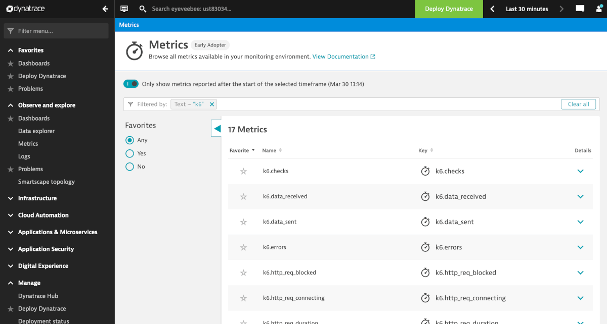

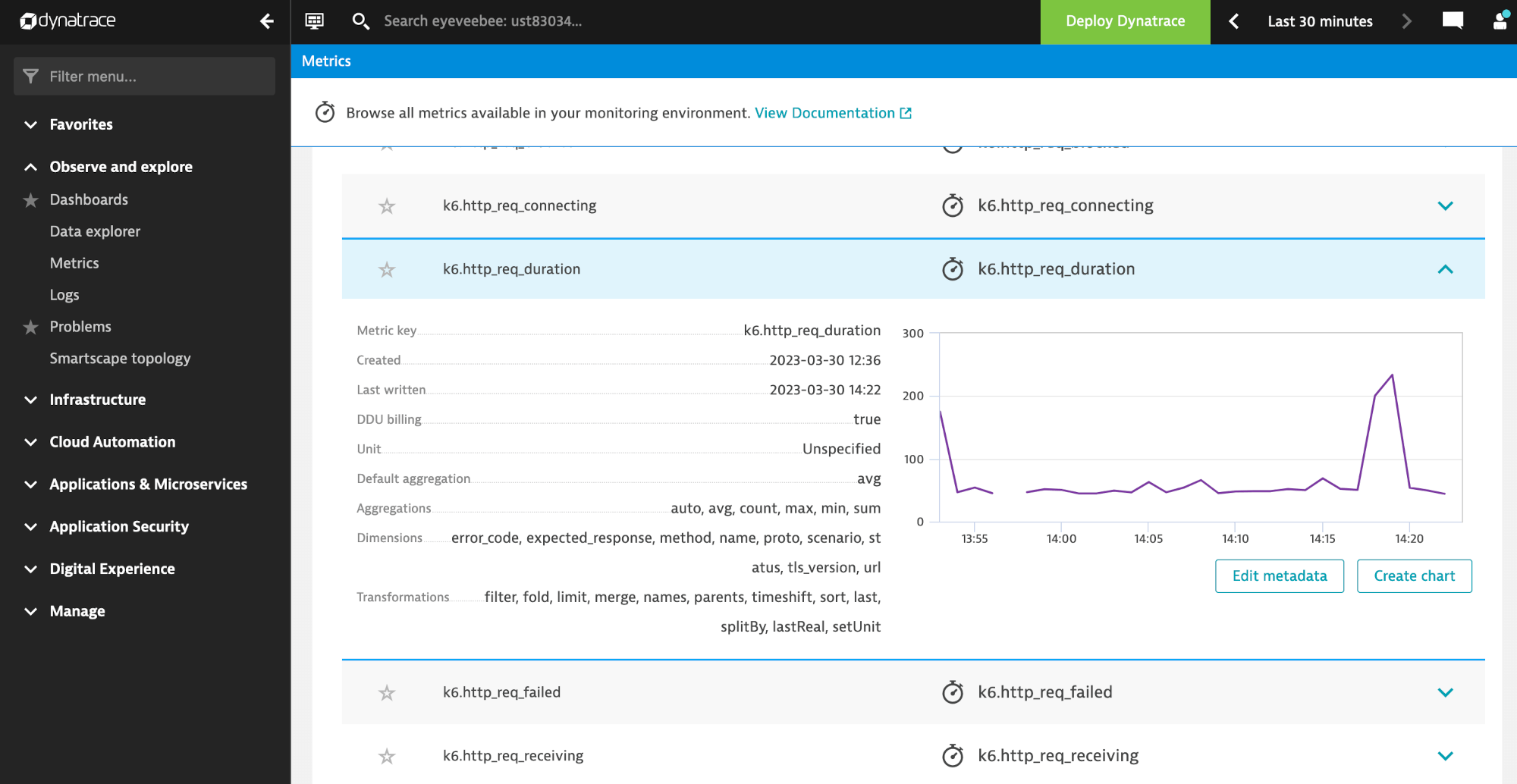

./k6 run script.js -o output-dynatraceCheck the metrics in your Dynatrace environment, filtering for k6:
