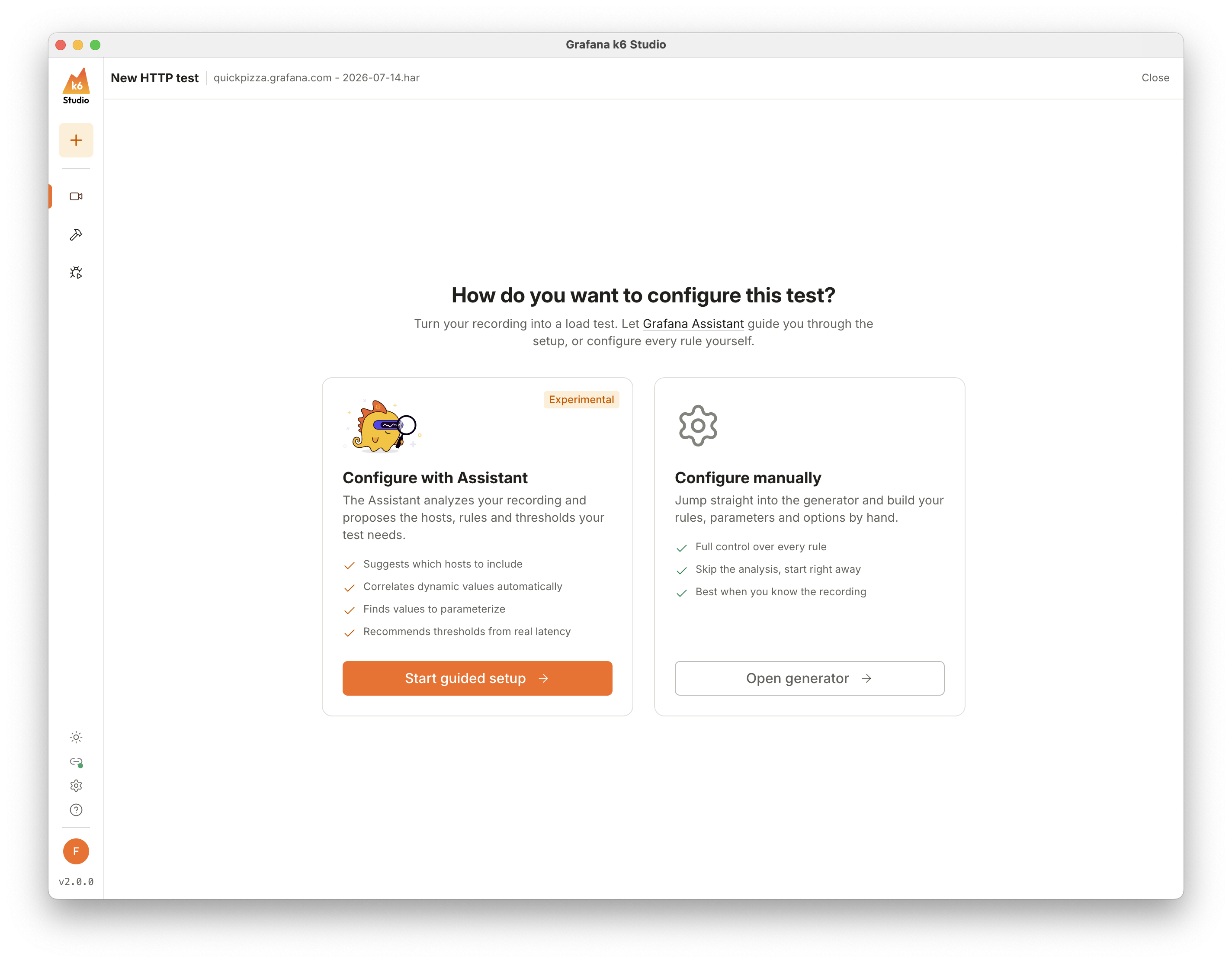

You can start guided setup from a recording or from an existing test generator.
To start from a recording:
  1. Open the recording and click Create test > HTTP test.
  2. On the How do you want to configure this test? screen, click Start guided setup. If you’d rather configure every rule yourself, click Open generator to go straight to the Generator.
k6 Studio choice screen asking how you want to configure the test, with Configure with Assistant and Configure manually cards
To start from an existing test generator, click Configure with Assistant at the top of the Generator. The wizard opens directly on the first step, so you can use it to reconfigure a test you’ve already created.

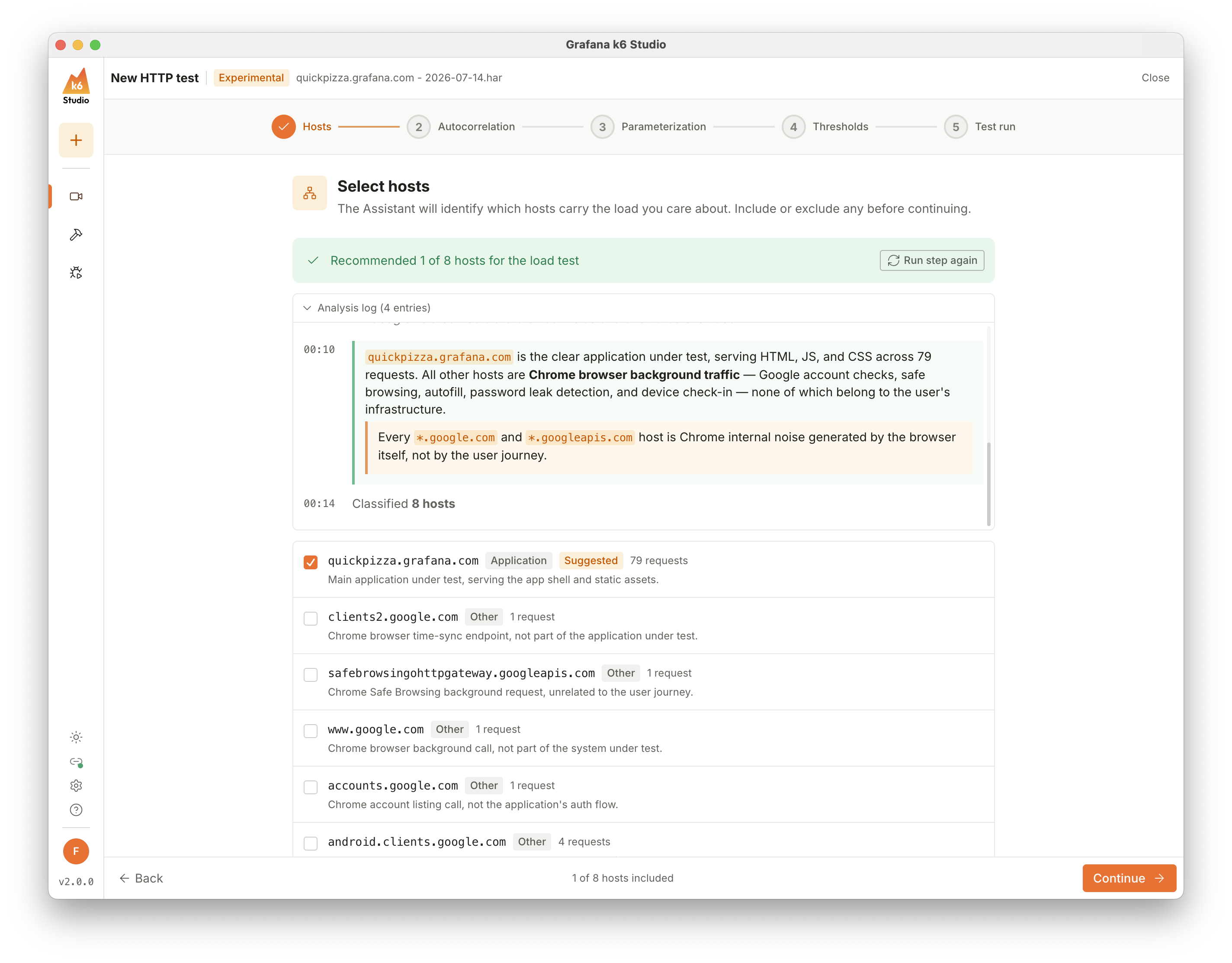

Select hosts
The Assistant identifies which hosts in your recording carry the load you care about, and suggests which ones to include, with a reason for each. Include or exclude hosts before continuing, and use Include requests for static assets (images, fonts, scripts) if you want to keep those requests. The hosts you select become the allowed hosts for the test.
Select hosts step in guided setup, showing the stepper, the actions log, and the host suggestions from the Assistant

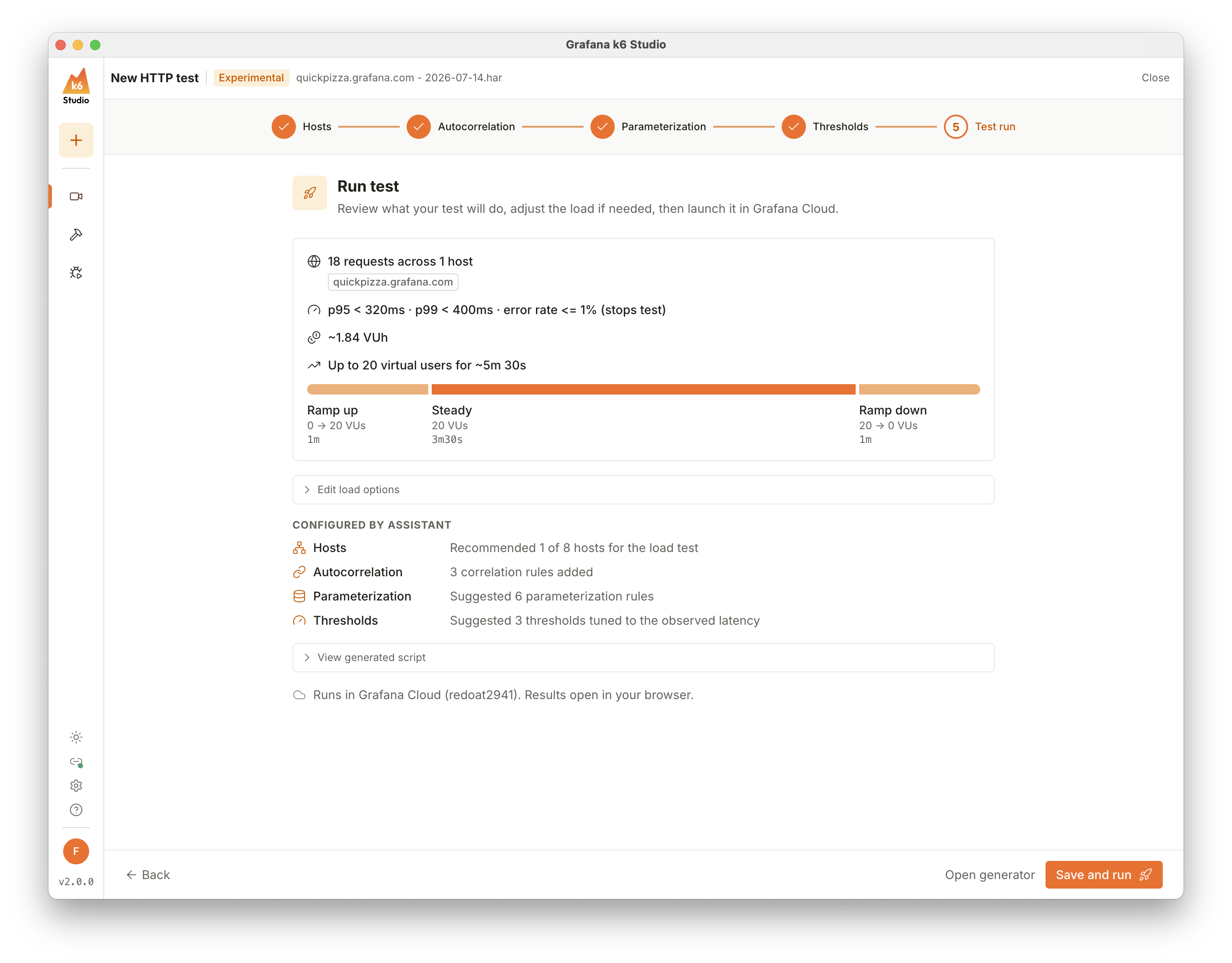

Run test
The last step summarizes what your test will do before you launch it:
  • The number of requests and the hosts they run against.
  • The thresholds that decide whether the test passes or fails.
  • The estimated cost of the run in virtual user hours (VUH), calculated by Grafana Cloud from your test options. If the configured load exceeds your project limits, a warning appears instead of the estimate.
  • The load profile, with a timeline of the ramp-up, steady, and ramp-down stages.
Run test step in guided setup, summarizing requests, thresholds, estimated virtual user hours (VUH), and the load stage timeline
You can also expand Edit load options to adjust the load profile, review the Configured by Assistant summary of the earlier steps, and expand View generated script to inspect the k6 script.
To launch the test, click Save and run. k6 Studio saves the test generator and opens the Run in Grafana Cloud dialog box. When the run starts, the test results open in your browser. Refer to Run in Grafana Cloud k6 for more details.
To finish without running the test, click Open generator.
