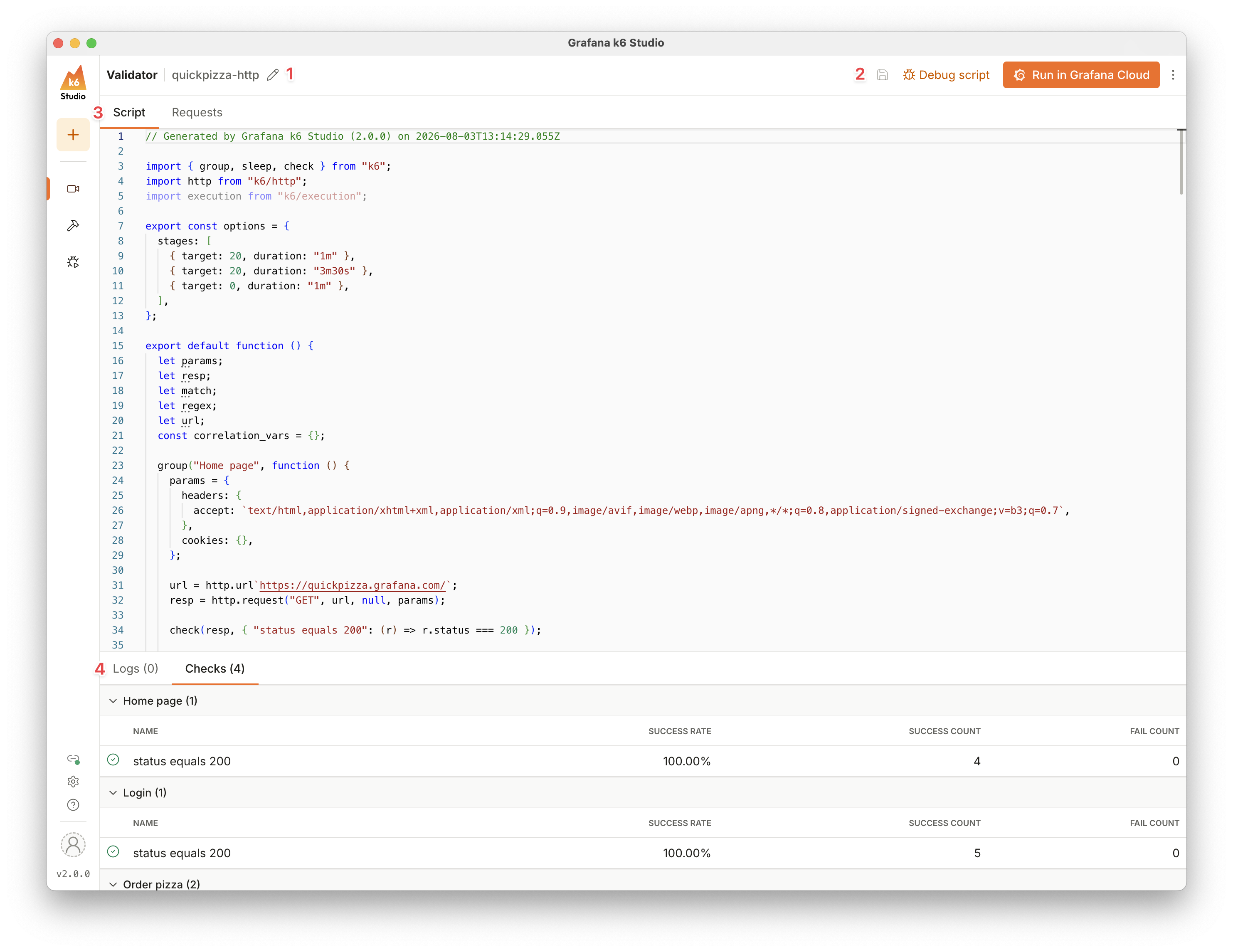

The content of the Debugger window depends on the type of test script. The basic layout is:
k6 Studio Debugger window, showing a test script that has been executed, with a list of executed checks at the bottom, and the script preview
  1. Test script name
    The name of the test script.
  2. Debugger actions
    On the top-right you can see the action buttons for the Debugger. From here you can:
    • Click Debug script to run one iteration of your test script.
    • Click Run in Grafana Cloud to run your test in Grafana Cloud k6.
    • Click the menu icon to:
      • Open external script: Open a k6 test script from your computer. After opening it, click Debug script to run one iteration of the test.
      • Move to Trash: Moves the selected test script to the Trash.
  3. Main view
    Below the test script name is the main view of the Debugger. From here, you can inspect the opened script and any data generated during a debug session.
  4. Debug panel
    This panel contains additional information about the test results, such as the logs emitted during its execution, or console messages for browser tests.

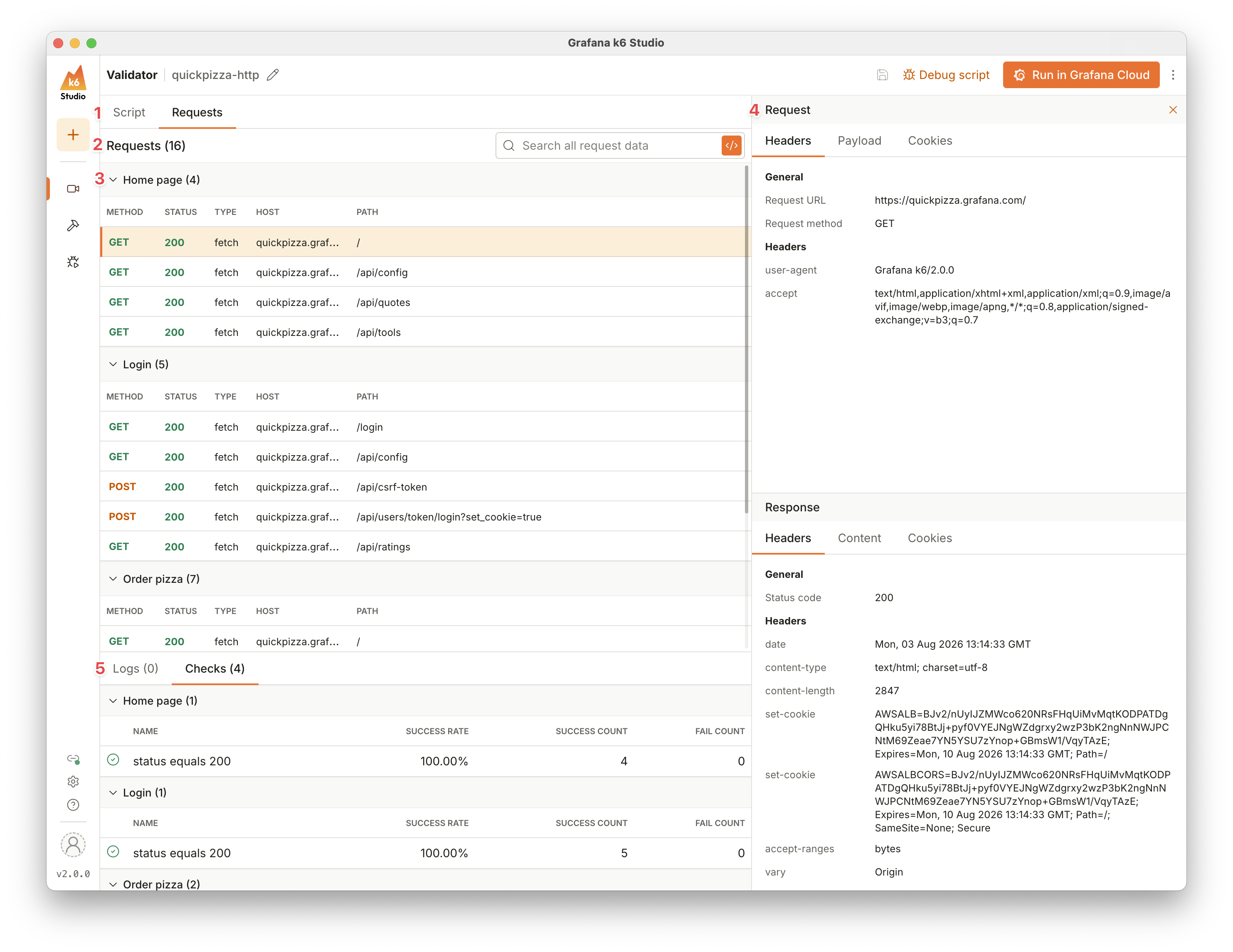

HTTP test
k6 Studio Debugger window, showing the results of an HTTP test run with the requests list open, and a request and response inspector on the right side
  1. Tabs
    From here, you can switch between viewing the executed script and the list of requests made during execution.
  2. Debugger options
    Below the tabs, you can see:
    • Requests: The total number of requests executed from the test script run.
    • Search: A search box that lets you search the list of requests by URL, method (such as GET or POST), and status code. You can also use the toggle to search across all request data.
  3. Requests and groups list
    The list of requests, and groups if any, that were executed in the test run. The requests are organized by time, and you can see the method, status code, host, and path for each one. You can also collapse and expand groups to inspect them more easily.
  4. Request and response inspector
    When you click on a request from the requests list, a panel opens on the right side which shows the request and response details for that request. You can use it to inspect the headers, payload, cookies, and content of the requests.
  5. Logs and checks
    Any logs or checks generated by test run can be found on their respective tabs.

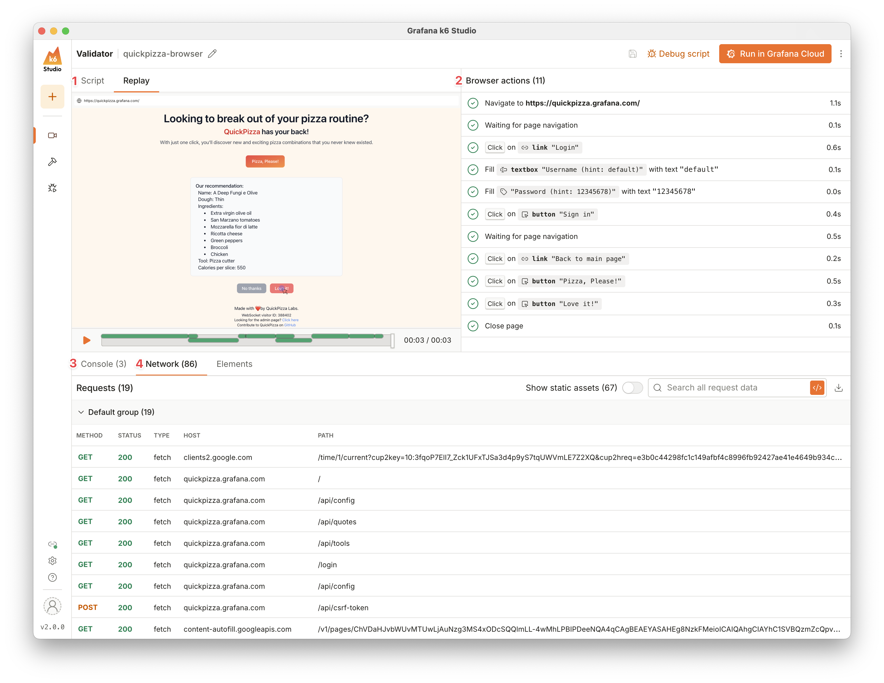

Browser test
k6 Studio Debugger window, showing the results of a browser test run with the session replay open, and a list of browser actions on the right side
  1. Script and Replay
    From here, you can inspect the executed script, or view the session recording.
  2. Browser actions
    This panel shows the interactions made by the script and their outcomes. If an interaction failed, the reason for the failure is shown.
  3. Console
    Any logs emitted either by the browser or the test script.
  4. Network
    A list of requests made by the browser. This is similar to the request list in an HTTP test.
