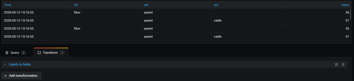

Transformations process the result set of a query before it’s passed on for visualization. They allow you to rename fields, join separate time series together, do math across queries, and more. For users, with numerous dashboards or with a large volume of queries, the ability to reuse the query result from one panel in another panel can be a huge performance gain.
The transformations feature is accessible from the Transform tab of the Grafana panel editor.

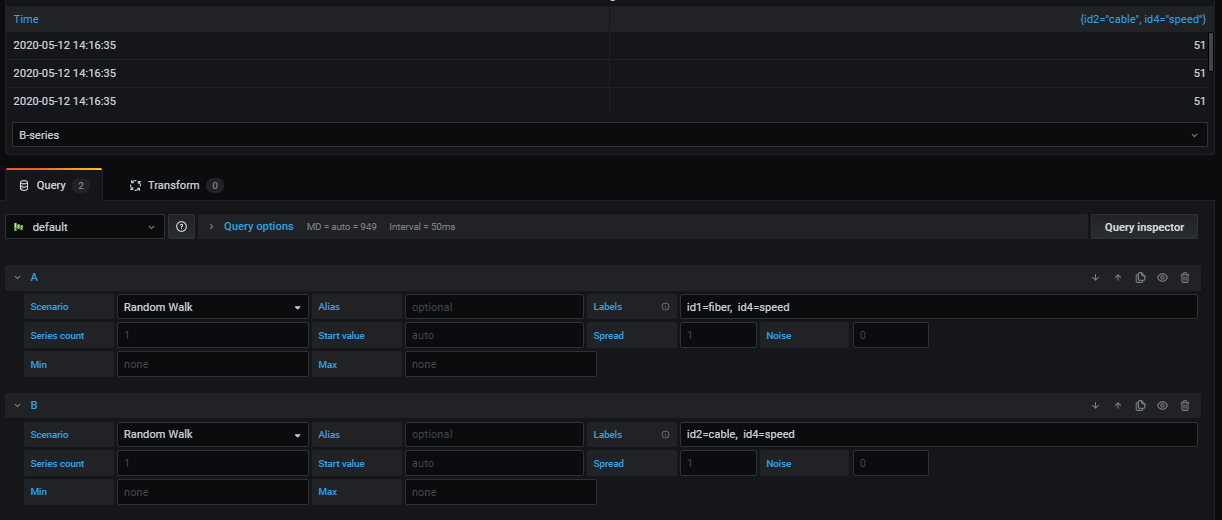

You must have entered a query and returned data from a data source. For more information on queries, refer to Queries.
You must have chosen a visualization that supports your query result and chosen transforms. Different transformations can result in a data structure that only some visualizations can render. For example, Graph visualization cannot show reduced data (that results from the Reduce transform). If your current visualization does not show you what you expect after applying a transform, switch to the Table visualization to check the result. For more information on the different types of visualizations, refer to:
