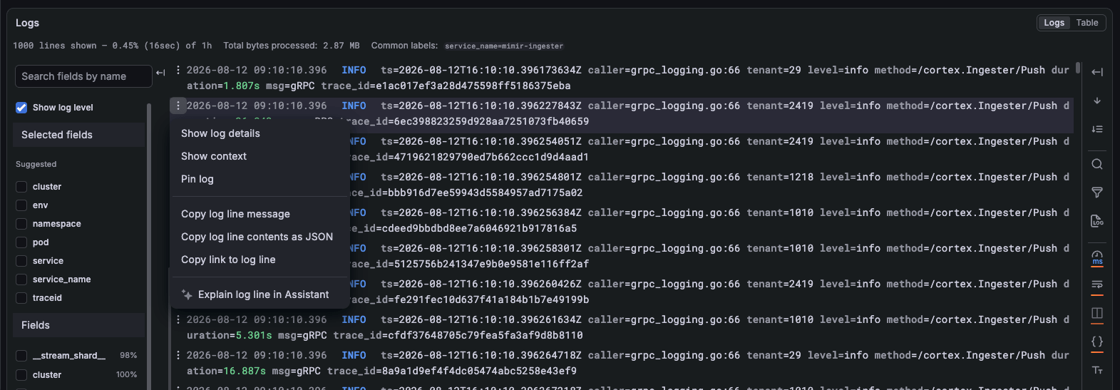

Log line menu
Click the menu icon (three vertical dots) at the start of a log line to open the log line menu.
A log line menu open over the log list, showing the Show log details, Show context, and Pin log options, followed by copy options and Explain log line in Assistant
The log line menu
The menu includes the following options:
  • Show log details: Opens log details for the log line. When details are already open, the option reads Hide log details.
  • Show context: Displays the log lines that arrived before and after the selected line. Refer to Log context for more information.
  • Pin log: Keeps the log line pinned in the log list. To remove the pin, select Unpin log.
  • Copy log line message: Copies the log line text to your clipboard.
  • Copy log line contents as JSON: Copies the log line, including its fields, as a JSON object.
  • Copy link to log line: Copies a short link that opens Logs Drilldown focused on this log line, so you can share it.
  • Explain log line in Assistant: Sends the log line to Grafana Assistant for an explanation. This option only appears when Grafana Assistant is available.

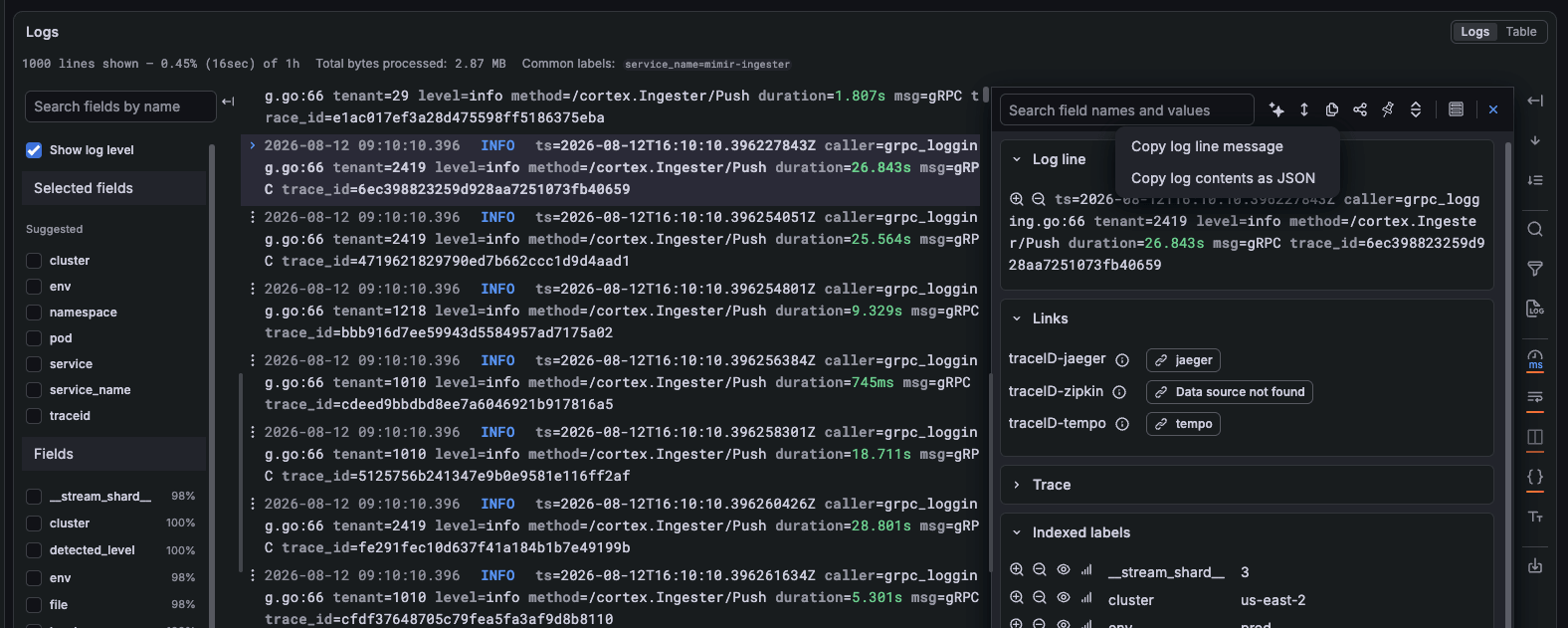

Log details
Log details show all the information attached to a single log line.
To open log details, click a log line or select Show log details from the log line menu.
The log details sidebar next to the log list, with the copy menu open and collapsible sections for the log line, links to tracing data sources, a trace, and indexed labels
Log details in sidebar mode
At the top of log details, use the Search field names and values field to narrow down what’s displayed. The copy icon opens a menu with Copy log line message and Copy log contents as JSON options.
Log details organize the information in collapsible sections:
  • Log line: The raw log line.
  • Links: Data links and correlations, which turn parts of the log line into links to related data or external resources, for example a trace ID linking to your tracing data source.
  • Trace: A preview of the trace, when the log line contains a trace link.
  • Fields, grouped by type for data sources that support it. For Loki, the groups are Indexed labels, Structured metadata, and Parsed fields.

Log details modes
There are two modes to view log details:
  • Inline displays the log details below the log line within the log list.
  • Sidebar displays the log details in a panel to the side of the log list.
To switch modes, use the mode icon in the log details header: Anchor to the right switches to the sidebar, and Display inline moves the details back into the list.
