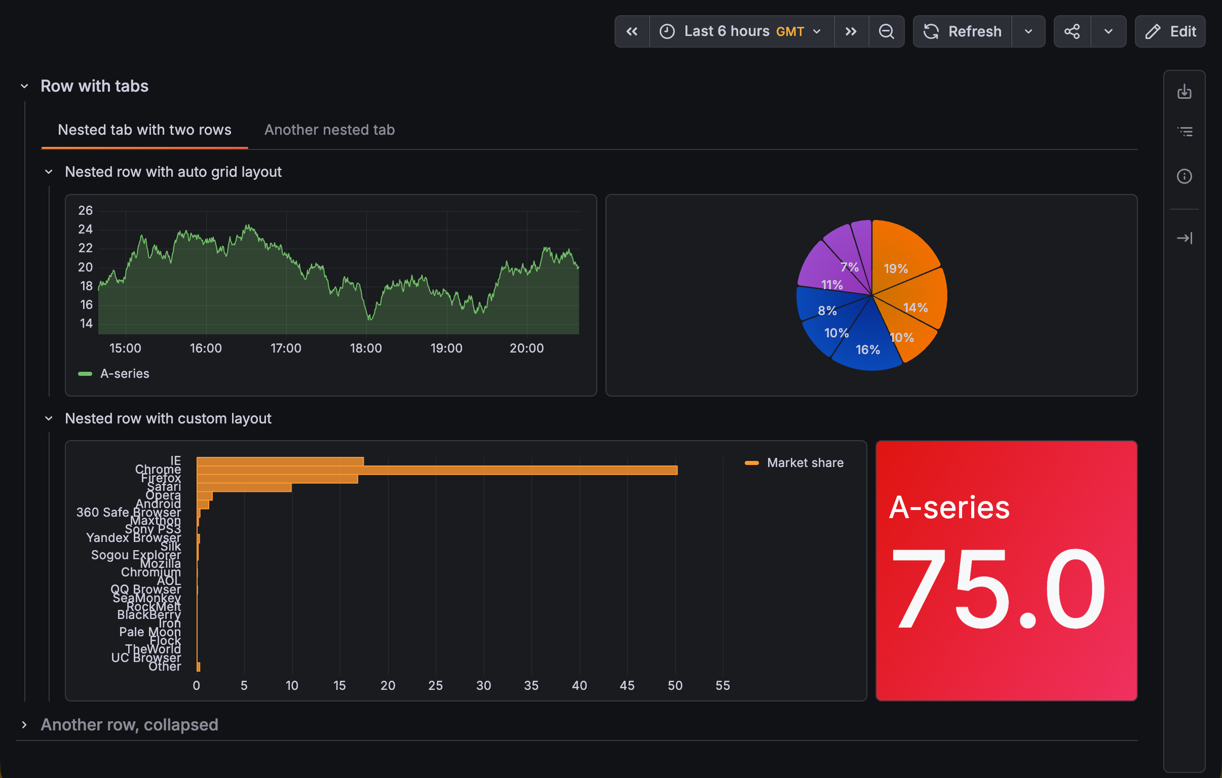

The following screenshot demonstrates how groupings work:
Dashboard with nested groupings
  1. You can only have one type of grouping at the first level. In this case, that’s two rows: Row with tabs and Another row, collapsed.
  2. Inside of those first-level groupings however, you have the freedom to add different dashboard elements. There are tabs nested in Row with tabs, but you could nest rows, tabs, or panels inside Another row, collapsed.
  3. Also, you can have different panel layouts in within a row or tab. In this dashboard, one tab contains two rows that have two different layouts.

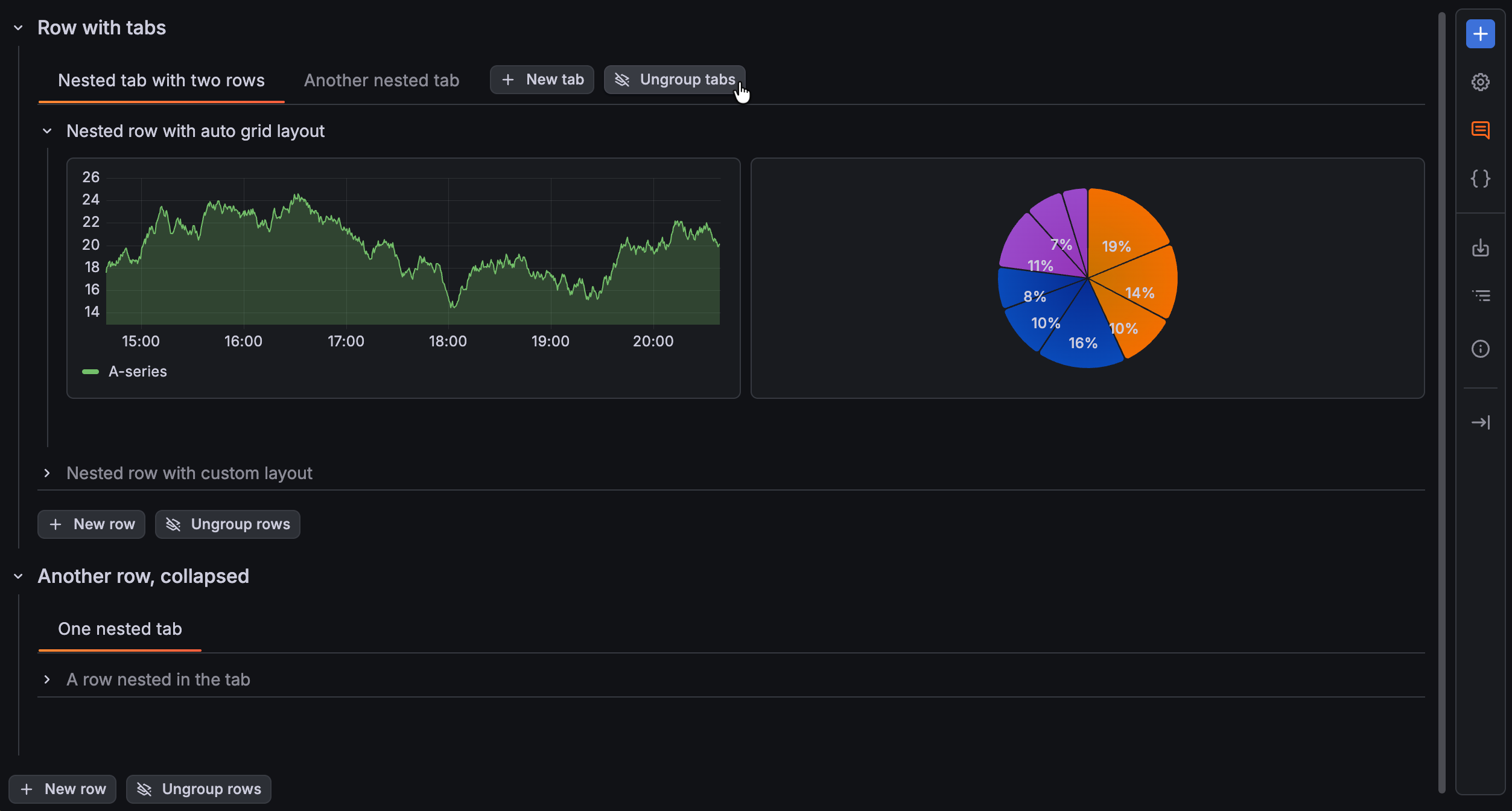

Ungroup panels
You can ungroup some or all of the dashboard groupings without losing your panels.
When you ungroup a row or tab, all the groupings inside it are ungrouped and the panels are moved into the next higher-level grouping. If there are no more groupings left, the panels are moved onto the dashboard.
Dashboard with ungrouping behavior annotated
  1. Ungroups all the rows inside Nested tab with rows leaving the panels in that tab.
  2. Ungroups all the tabs inside Row with tabs, leaving the panels in that row.
  3. Removes all groupings on the dashboard, leaving just the panels on the dashboard.
The Ungroup rows and Ungroup tabs buttons are only visible when you hover your mouse over the relevant part of the dashboard

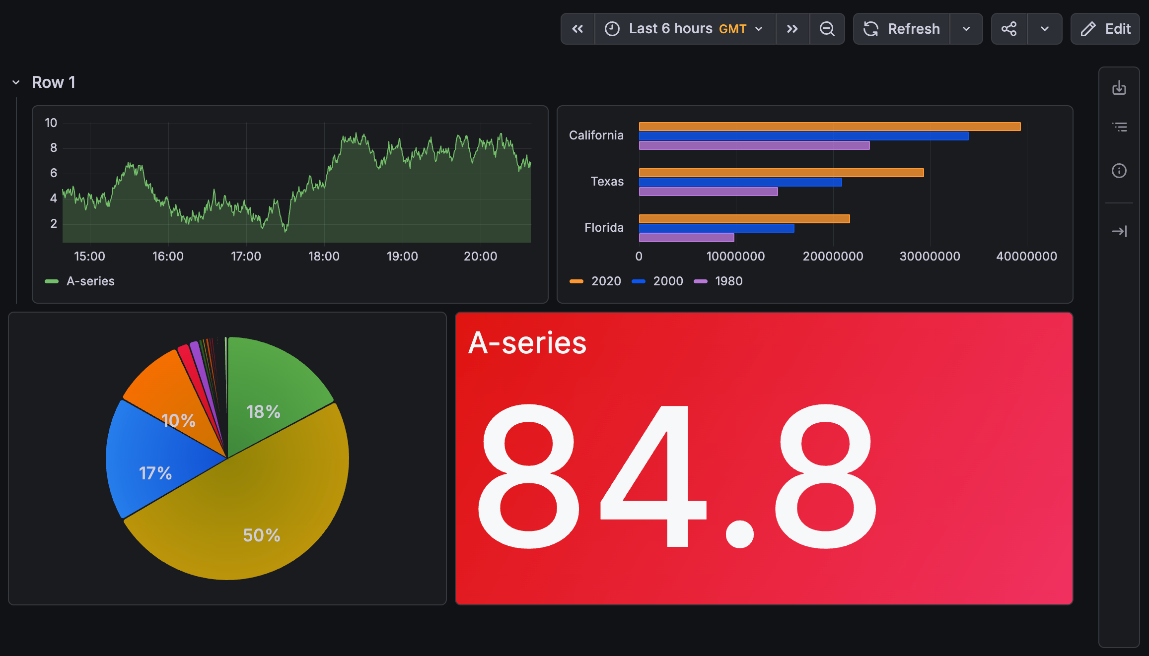

Place panels outside of groupings with headerless rows
If you have a row with panels, but you want the panels to appear ungrouped, you can use the Hide row header switch in the row configuration to achieve this.
In view mode, the row header is hidden, so that the panels in that row appear ungrouped. In the following image, the panels are grouped into two rows, but the header of the second row is hidden:
Dashboard including a row with a hidden header
When you hide the header of a row, you can’t collapse the row.

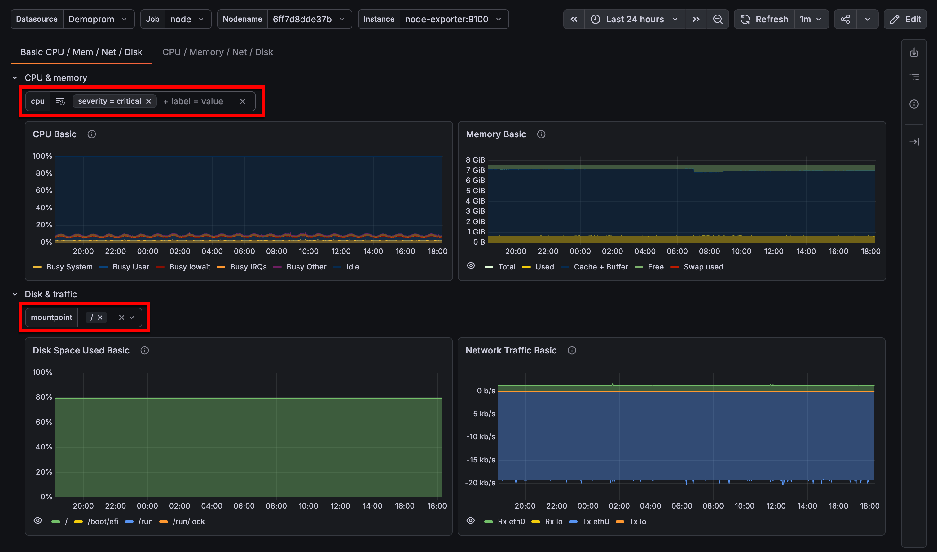

Section-level variables and filters
You can add variables and filters to groupings that apply only to the panels in that grouping.
For example, if your dashboard includes both an API gateway and a database, you might want to apply two different $instance variables. Section-level variables and filters for address this by letting each row or tab have its own independent scope. In the API gateway and database scenario, the API gateway grouping can use one set of instances, while a database grouping uses another set. However, both groupings still share the same time range, and the underlying dashboard remains unchanged.
The following image shows an example using two rows of panels:
A dashboard with two rows, each with its own variable filter above the panels
Panels in the grouping resolve section-level variables and filters first, then fall back to dashboard-level variables.
