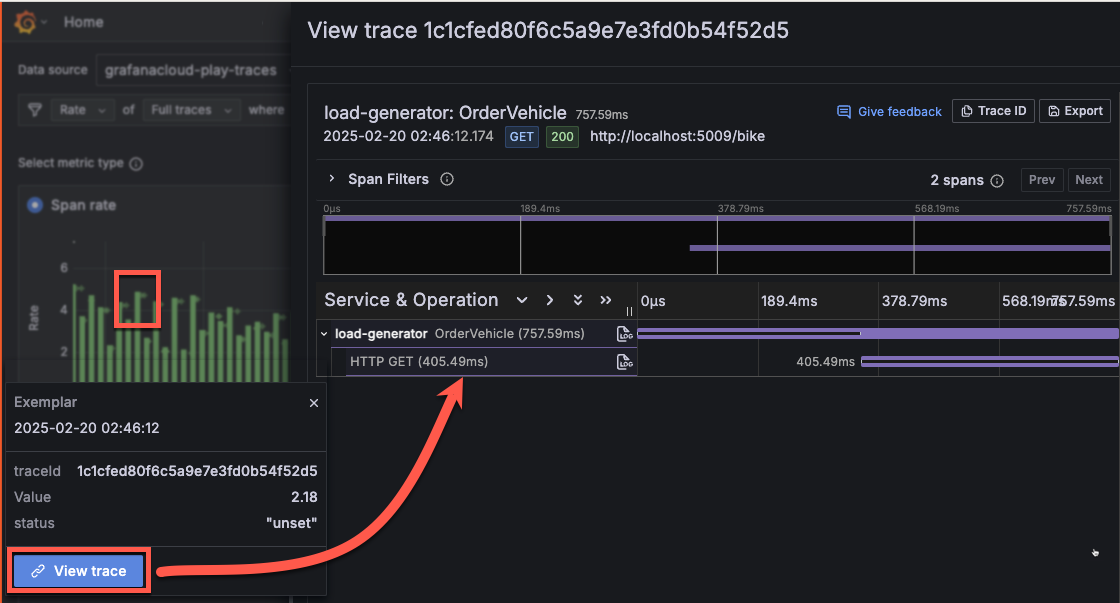

Exemplars in Traces Drilldown

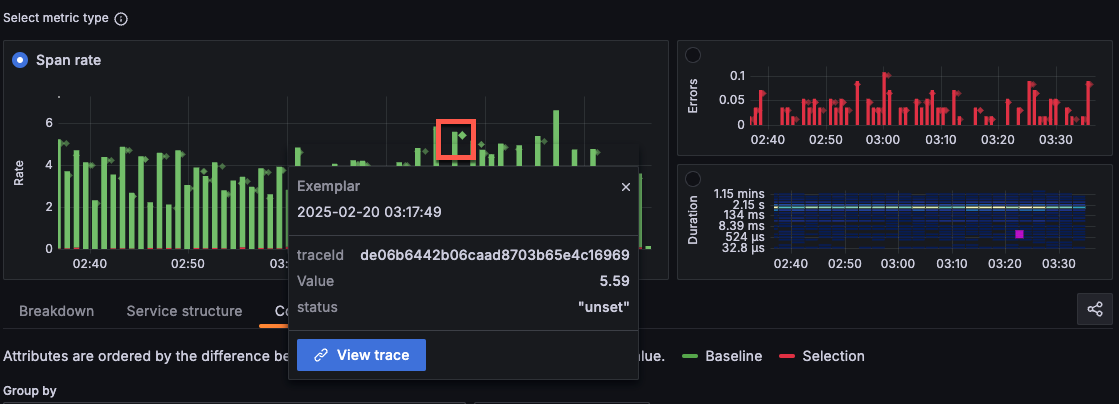

In Traces Drilldown, exemplar data is represented by a small diamond next to the bar graphs. You can view the exemplar information by hovering the cursor over the small diamond.
Exemplars appear on the Rate and Errors bar charts, including the per-attribute charts in the Breakdown tab. The Duration heat map doesn’t display exemplars.
As you view Rate or Errors metrics in the Breakdown, Service structure, or other investigation tabs, look for small diamond icons next to the bar chart metrics.
When you hover your cursor over a diamond, a tooltip appears showing:
- Exemplar details
- Trace information
- Timestamp and metadata
Tip
Not seeing exemplars? Refer to Exemplars in Grafana Cloud for information about how to enable them.
Select View trace to open a slide-out trace panel that displays:
- The full trace that the exemplar represents
- All spans within that trace
- Timing and performance details
- Service relationships
