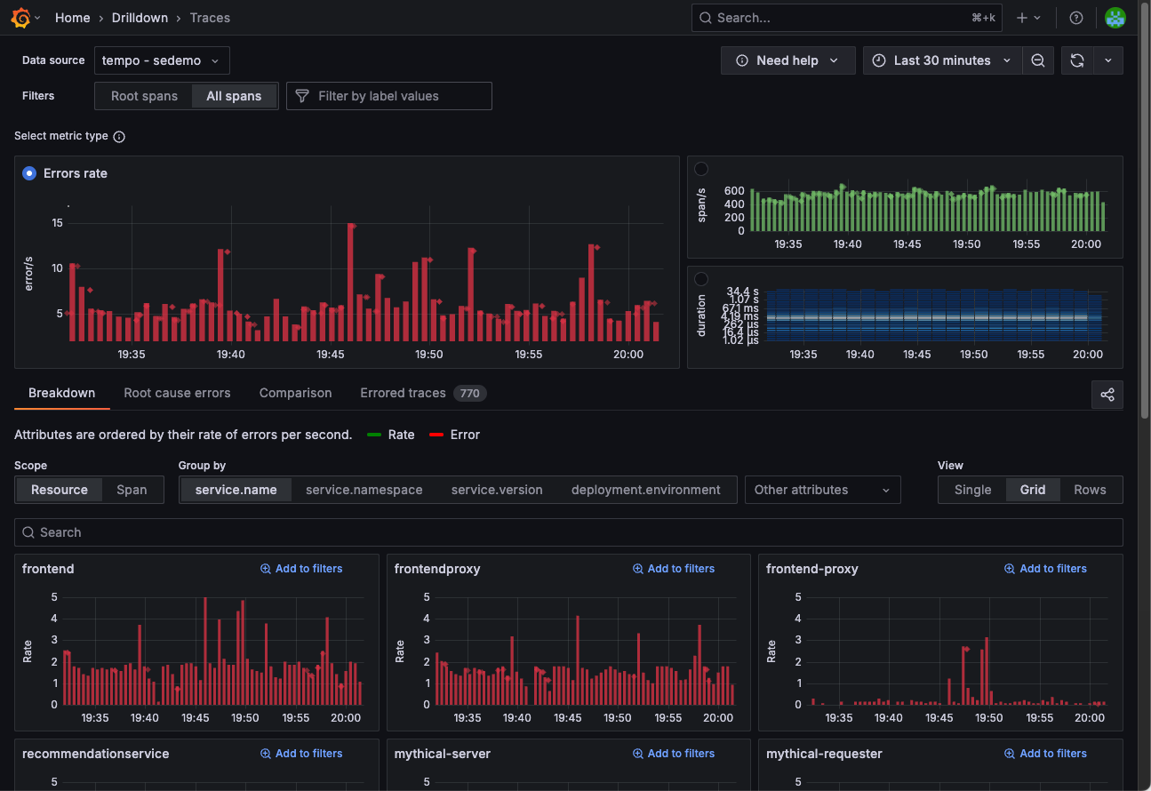

Choose the level of data and a metric
To identify the trouble spot, you want to use raw tracing data instead of only the root span, which is the first span of every trace. Select All spans in the Filters, then choose the Errors metric.
Select All spans to view all raw span data and Errors as your metric

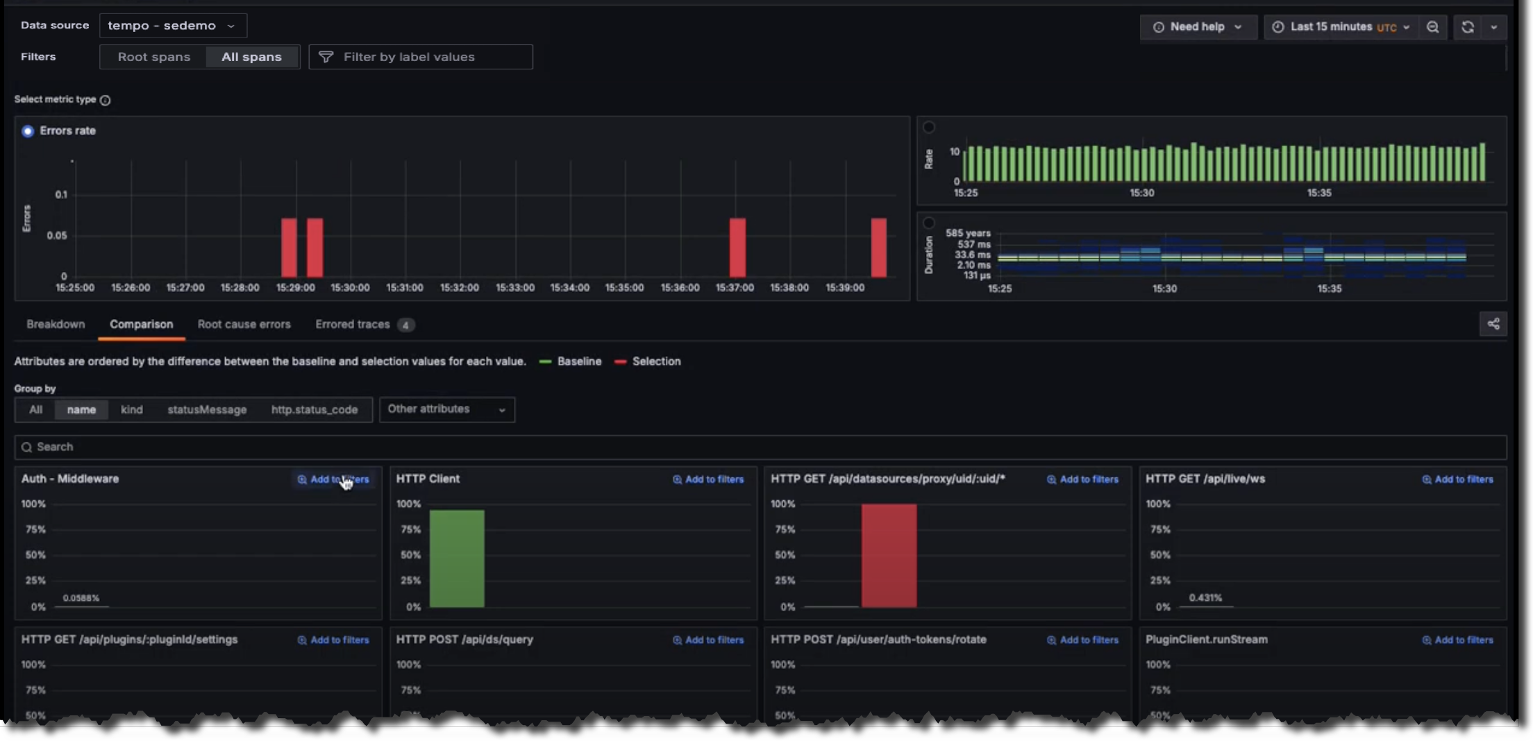

Correlate attributes

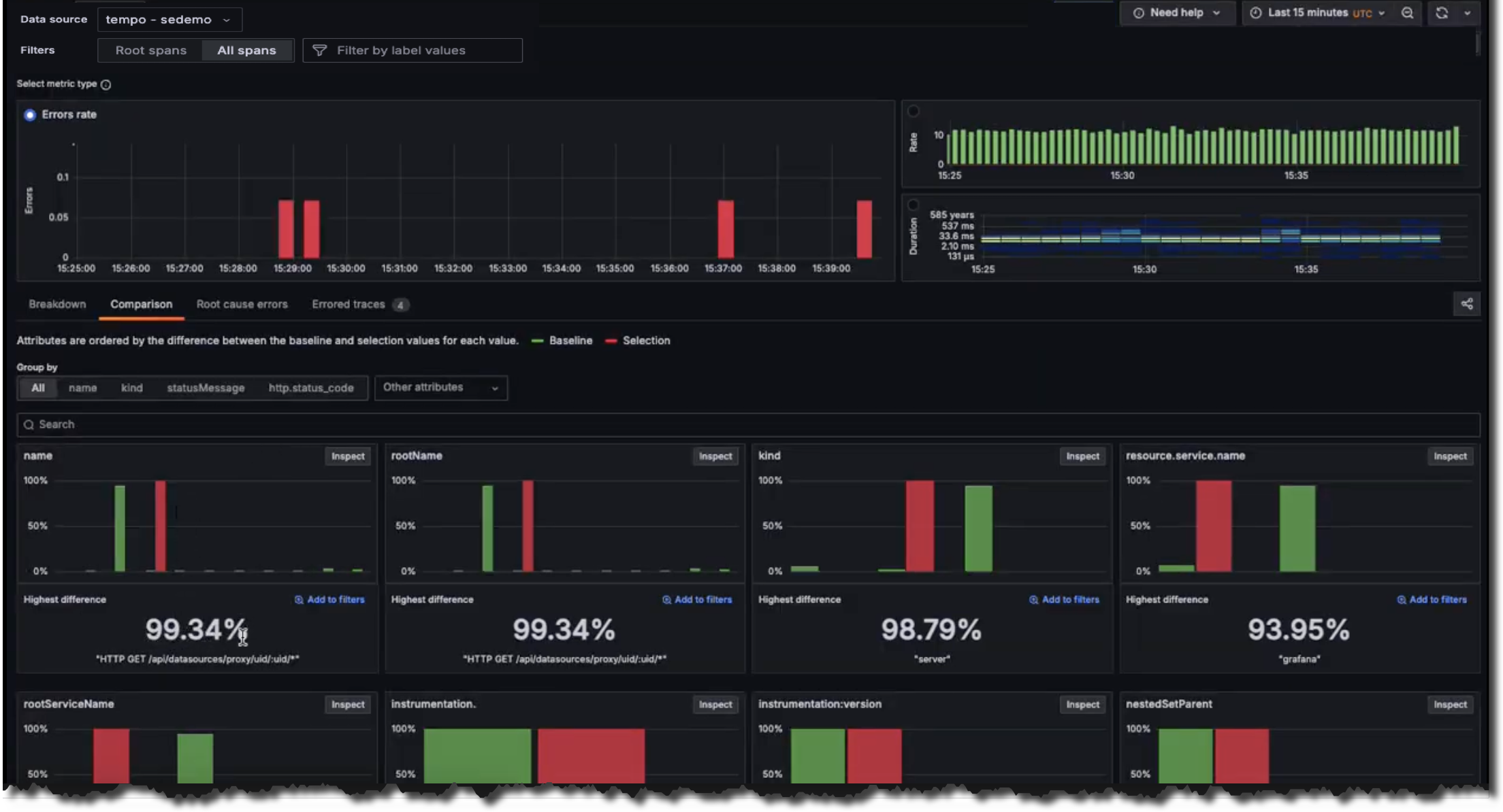

Use the Comparison tab to correlate attributes values with errors. The results are ordered by the difference in those attributes by the highest ones first. This helps you see what’s causing the errors immediately. The Comparison tab analyzes the difference between two sets of traces:
  • Blue bars (Baseline): Normal/healthy trace behavior
  • Red bars (Selection): Current selection with status = error filter
The view compares your selection (red) to the baseline (blue) and ranks attributes by the largest difference. This indicates a significant spike in HTTP 500 (Internal Server Error) responses during your selected time range. The visualization highlights that:
  • 500 errors aren’t normal for this system, they don’t appear in the baseline comparison
  • There were 500 traces containing HTTP 500 status codes during the error period
  • This represents a 100% deviation from normal behavior
Select Include to narrow the investigation to these values, or choose Inspect to explore the full distribution.
Errors are immediately visible by the large red bars
Hovering over any of the bars shows a tooltip with information about the value and the percentage of the total.
Tooltip showing the value and the percentage of the total

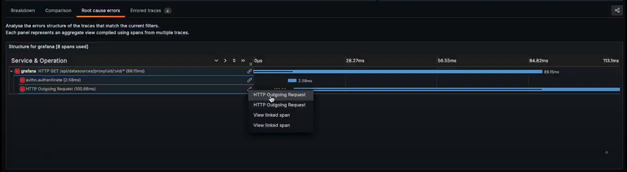

Use Root cause errors
Select Root cause errors for an aggregated view of all of the traces that have errors in them. This screen provides critical insights into where and how the HTTP 500 error occurred in your distributed system.
Using this view, you can see that the Frontend > Recommendations services have problems. Specifically, that the /api/pizza endpoint chain is failing.
Root cause errors tab

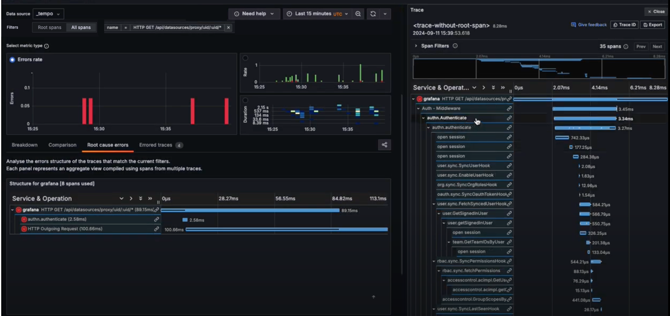

To view additional details, click the link icon and select View linked span to open the trace drawer.
View linked spans to see details of errors
Error spans have a red icon next to them. Select the down arrow next to the span with an error to see details.
