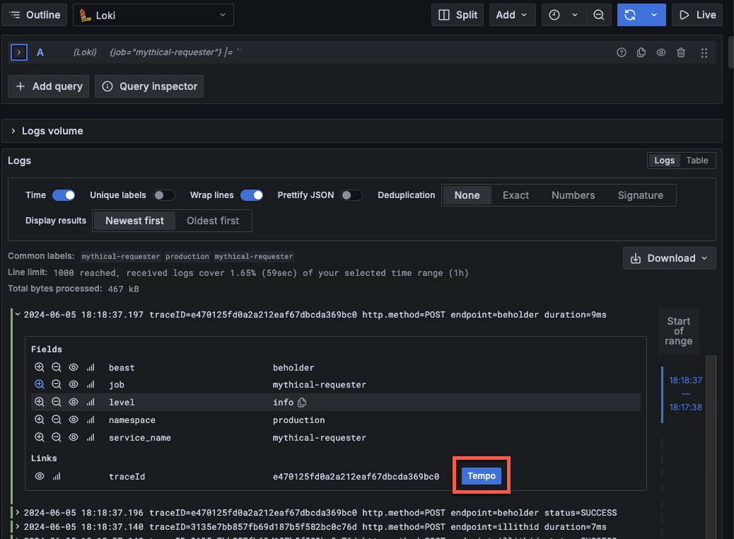

Or from traces to logs:
Use traces to go to a log entry

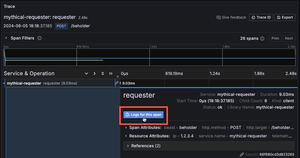

And vice versa, from logs to traces.
Use logs to go to a span
