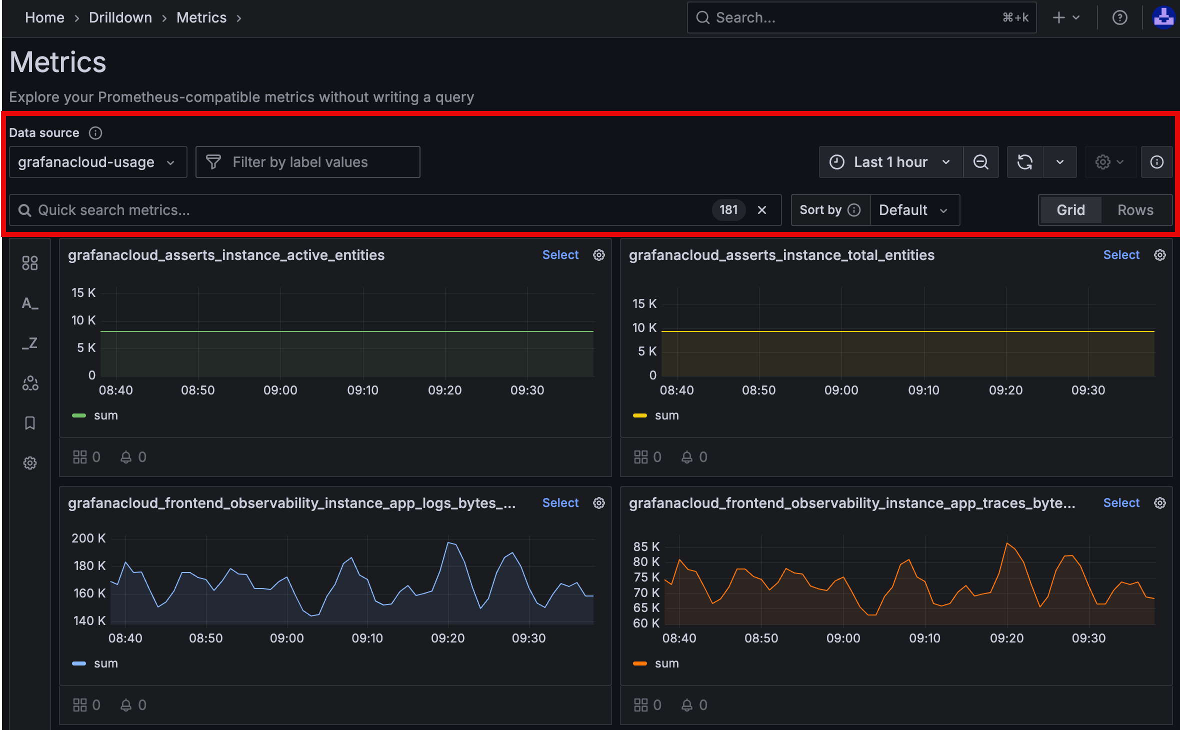

  1. Navigate to the Metrics Drilldown page in Grafana. Refer to Get started with Grafana Metrics Drilldown.
  2. From the Data source dropdown, select a data source to view related metrics. Supported data sources include Prometheus and Prometheus-compatible data sources.
  3. (Optional) In the Filters control, select Add label. Then, select a label name, an operator, and a value to build your filter.
    Note
    You can apply multiple filters to your metrics. If you don’t see a metric you expect, refer to Troubleshoot missing metrics.
    Grafana Metrics Drilldown with filters and metrics that contain data
  4. (Optional) To search for metrics, type keywords in the metric search bar.
  5. (Optional) From the Sort by dropdown, select how to sort metrics: Default (alphabetical, with recently selected metrics first), Alphabetical [A-Z], Alphabetical [Z-A], Dashboard Usage (by prevalence in dashboard panel queries), or Alerting Usage (by prevalence in alerting rules).
  6. Use the time picker to select a date and time range from the dropdown menu, or use an absolute time range.
  7. Select the refresh interval control next to the Refresh icon to set a refresh rate from the dropdown menu. By default, refresh is Off.

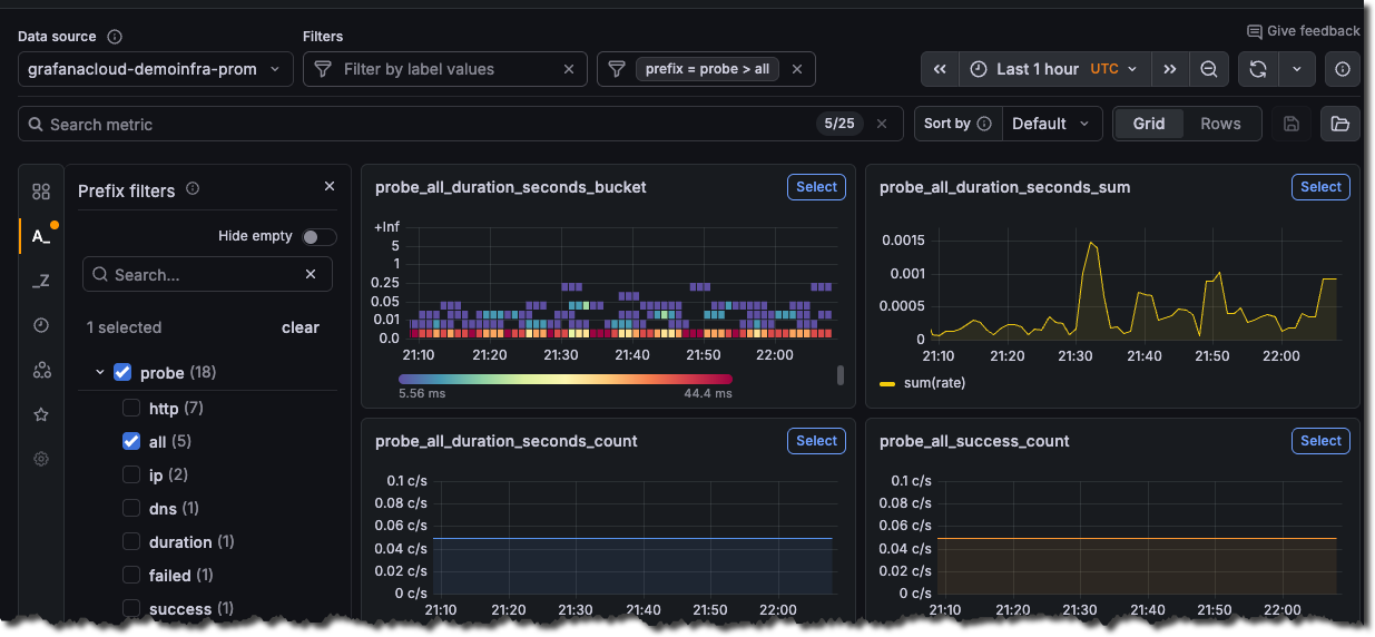

Apply advanced filters
Apply advanced filters to further refine the metrics that appear in Metrics Drilldown. Access the following advanced filters from the left-side menu of the Metrics Drilldown app.
Filter typeDescription
Rules filtersFilter metrics based on whether they are non-rules metrics or recording rules.
Prefix filtersFilter metrics based on their name prefix in the Prometheus namespace. Multiple selected prefixes use “OR” logic.
Suffix filtersFilter metrics based on their name suffix. Multiple selected suffixes use “OR” logic.
Recent metrics filtersFilter metrics based on when they started being ingested.
Group by labelsGroup metrics by their label values.
BookmarksView saved metrics.
Filter logic
Multiple selections for a filter apply “OR” logic, but selections between filters apply “AND” logic. For example, if you select both envoy and kafka as prefix filters, the app shows all metrics with a prefix of either envoy or kafka. Then, if you select count as a suffix filter, the app updates to only show metrics with the count suffix.

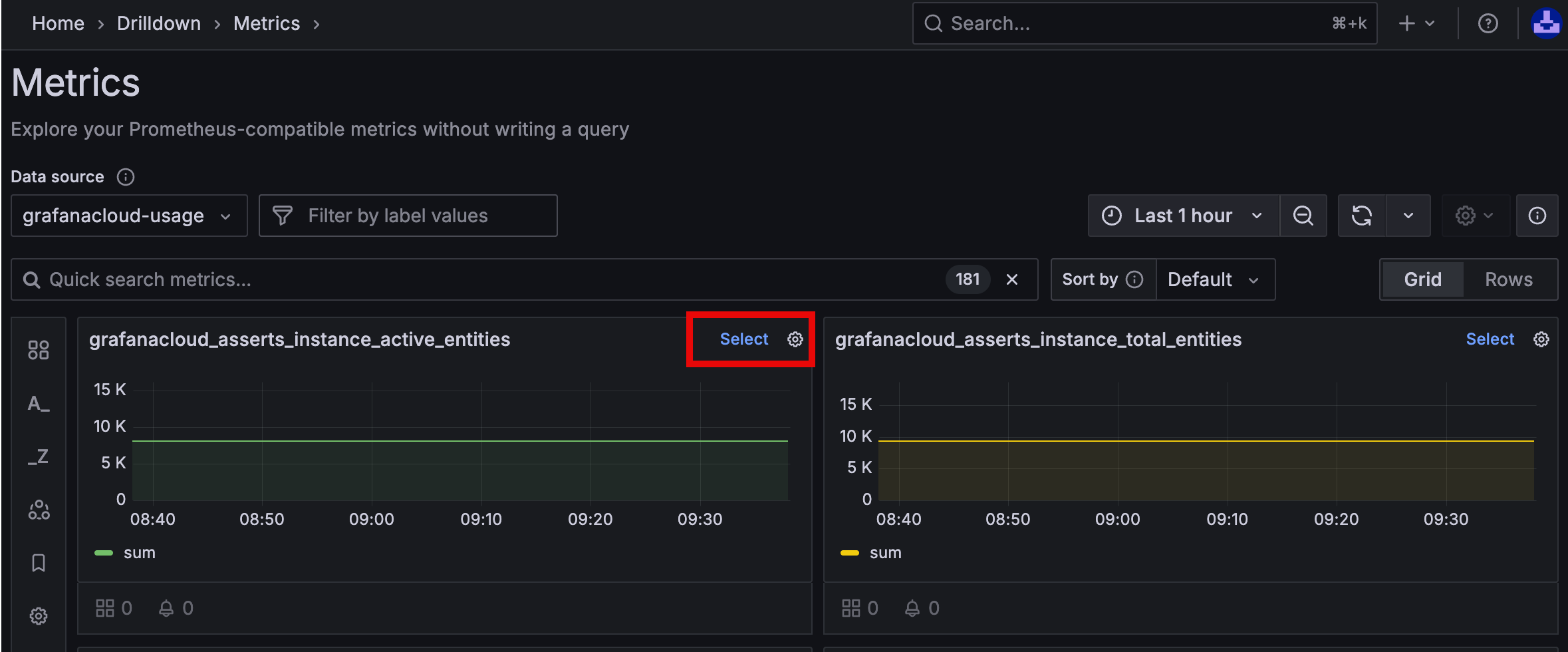

  1. From the Metrics Drilldown main page, locate the metric you want to investigate.
  2. From the upper-right corner of the metric panel, click Select.
A detailed view of the metric opens that shows the following details:
