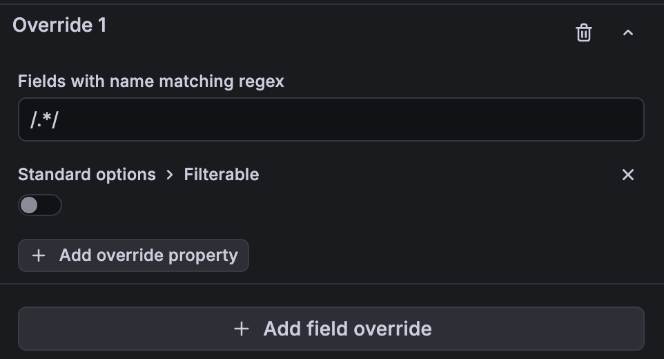

To enable this functionality, you need to add an override for every field by which you want to filter. In the override:
  • Select a field name.
  • Enable the Filterable switch.
Field override making some fields filterable
You can also do this programmatically by returning the data frame with the appropriate filterable property on the desired fields.
