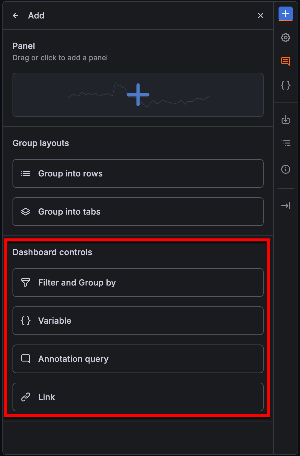

Add filters and group by controls
Note
The Filter and Group by feature renames the Ad hoc filters variable and extends it by adding grouping for Prometheus and Loki data sources. However, in the dashboard schema, it’s still referred to as "kind": "AdhocVariable" under the variables schema property.
To add filters and group by controls, follow these steps:
  1. Navigate to the dashboard you want to update.
  2. Select Editing in the dashboard mode drop-down list.
  3. Click the Add new element icon (blue plus sign).
  4. Click Filter and Group by.
  5. Enter a Name for the filter.
  6. (Optional) In the Label field, enter the display name for the filter drop-down list.
    If you don’t enter a display name, then the drop-down list label is the filter name.

Add variables
To add a variable, follow these steps:
  3. Click the plus sign Add new element icon in the sidebar and select Variable.
    You can also click the Add variable plus sign icon at the top of the dashboard.
  4. Choose a variable type from the list.
    You can update the variable type by clicking Change type in the sidebar.

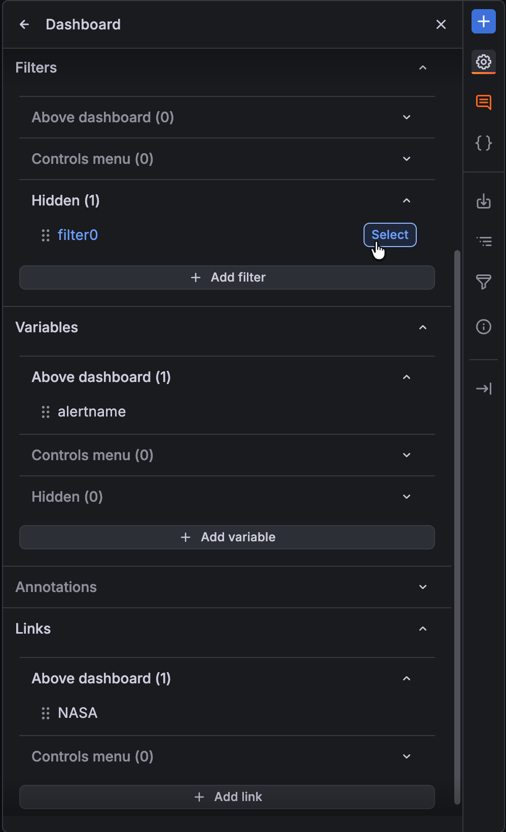

Manage dashboard controls
After you add dashboard controls, you can manage them from the dashboard options. In this view, the sidebar includes collapsible sections for filters, variables, annotations, and links, including hidden controls that aren’t otherwise visible on the dashboard:
Dashboard controls in the Dashboard options sidebar view
To manage dashboard controls, follow these steps:
  1. Click the Dashboard options icon in the sidebar.
  2. In the sidebar, expand the appropriate collapsible section.
  3. Do one or more of the following:
    • Edit: Click the Edit icon on the control to open it in the sidebar so you can make updates.
    • Reorder: Drag and drop controls to reorder them.
    • Change display: Drag and drop controls between sub-sections Above dashboard, Controls menu, and Hidden to update the control display option. Note that links can’t be hidden.
    Tip
    To get back to controls management from configuration, click the Dashboard options icon.
  4. Make any other changes as needed.
  5. Click Save.
  6. (Optional) Enter a description of the changes you’ve made.
  7. Click Save.
  8. Select Viewing in the dashboard mode drop-down list.
