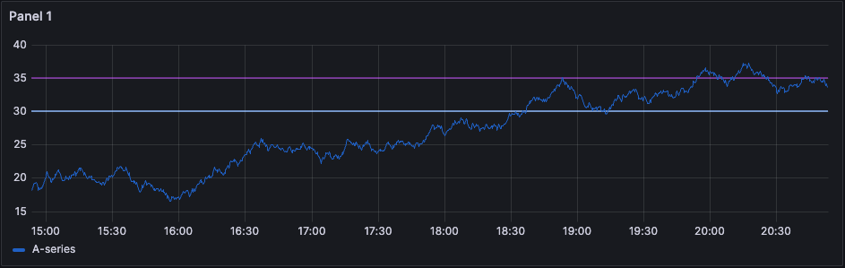

As lines
Visualization with threshold as a line

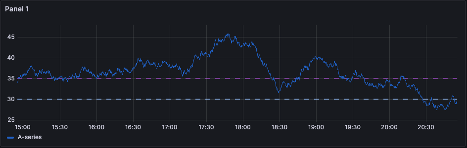

As lines (dashed)
Visualization with threshold as a dashed line

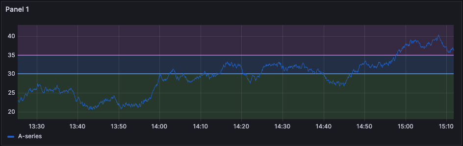

As filled regions
Visualization with threshold as a region
As filled regions and lines
Visualization with threshold as a region and line
