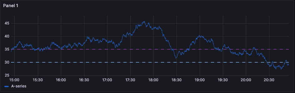

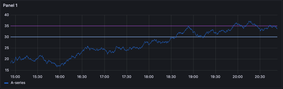

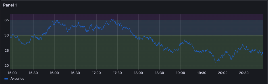

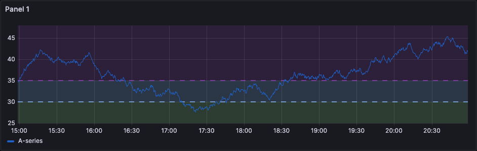

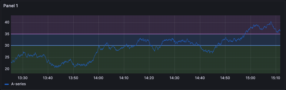

Using thresholds, you can color grid lines and regions in a time series visualization:
