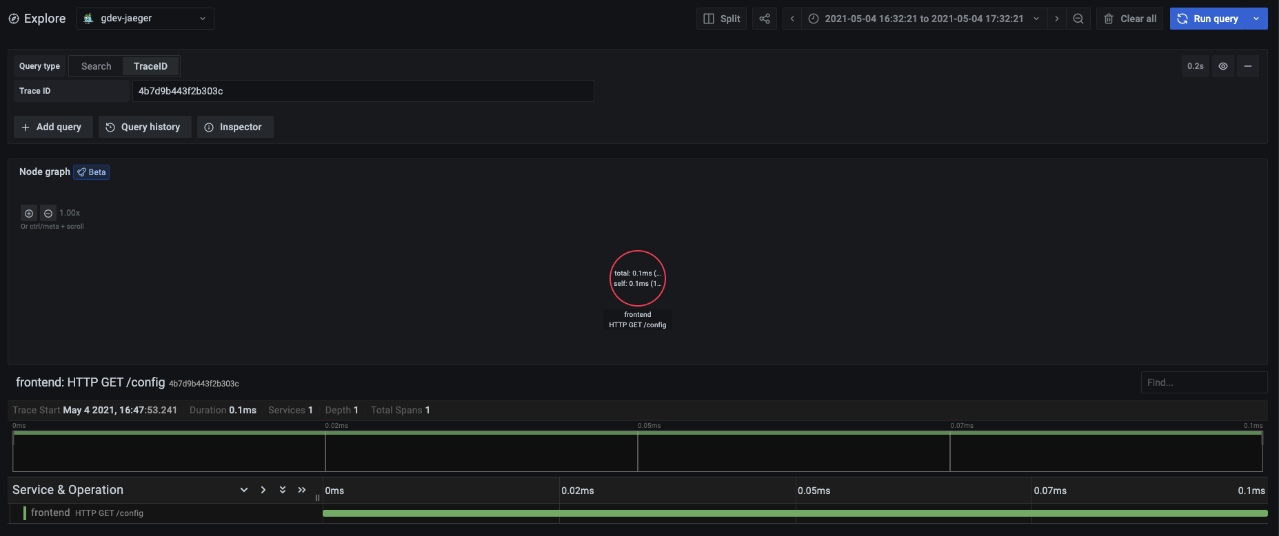

Query by trace ID
To query a particular trace:
  1. Select the TraceID query type.
  2. Enter the trace’s ID into the Trace ID field.
Screenshot of the Jaeger query editor with TraceID selected

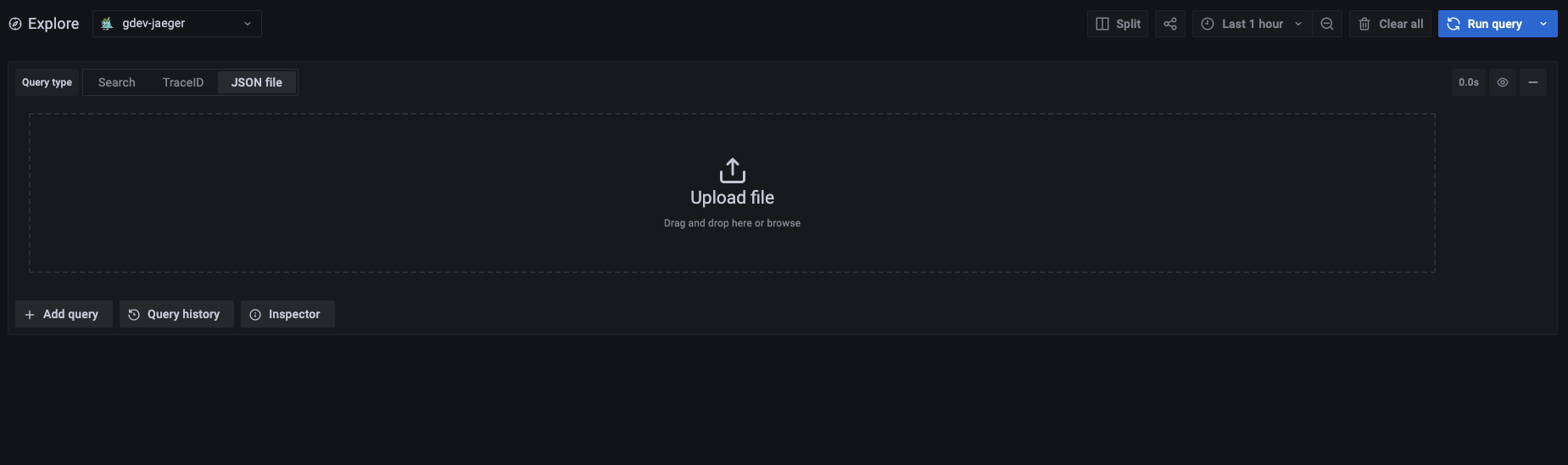

Upload a JSON trace file
You can upload a JSON file that contains a single trace and visualize it. If the file has multiple traces, Grafana visualizes its first trace.
Screenshot of the Jaeger data source in explore with upload selected
