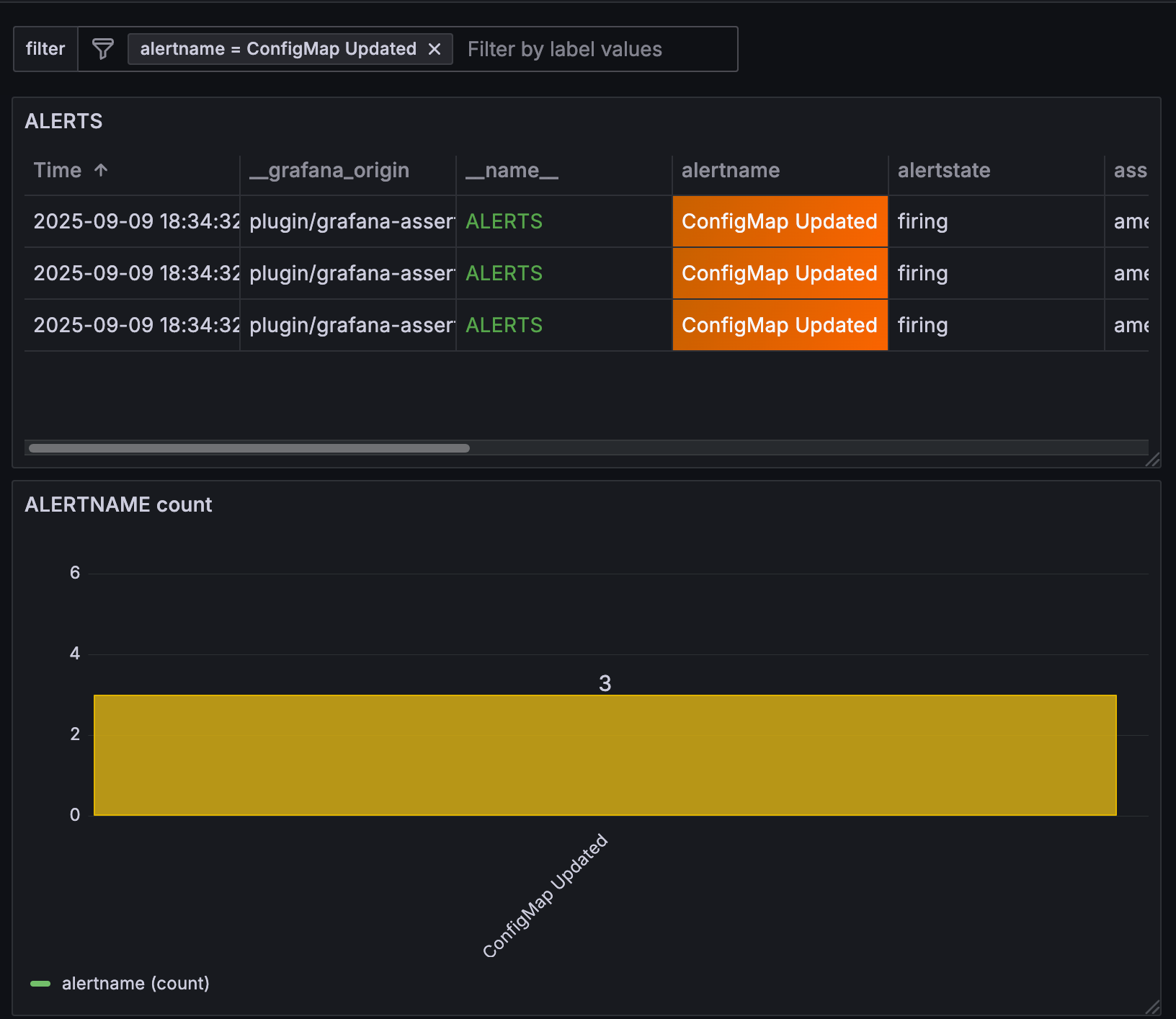

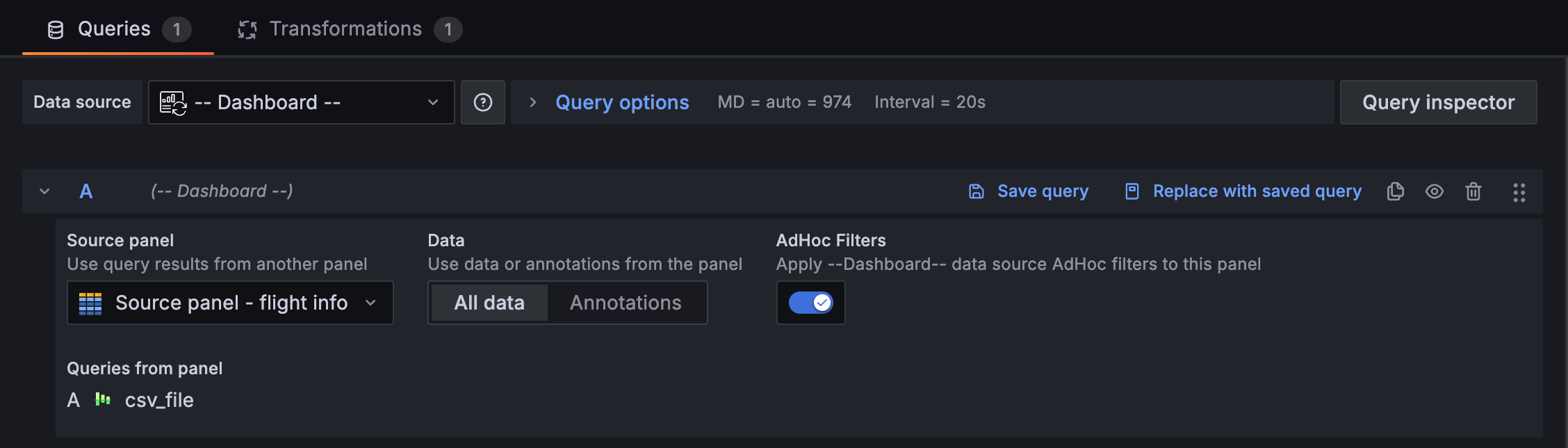

Note
In Grafana 13.1, Ad hoc filters have been renamed Filter and Group by and extended by adding grouping for Prometheus and Loki data sources. However, in the dashboard schema, they’re still referred to as "kind": "AdhocVariable".
For information on the Filter and Group by feature, refer to the documentation.
