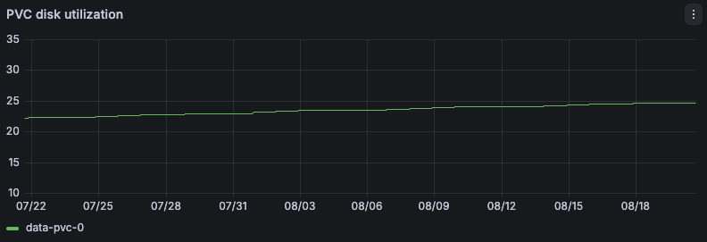

predict_linear is useful when a signal follows a relatively steady trend, such as disk utilization that is consistently increasing.
A stable trend signal suitable for predict_linear forecasts.
It is not suitable for signals with strong recurring patterns. For example, if a signal follows daily or weekly cycles, a straight-line projection might produce values that do not reflect the signal’s normal behavior.

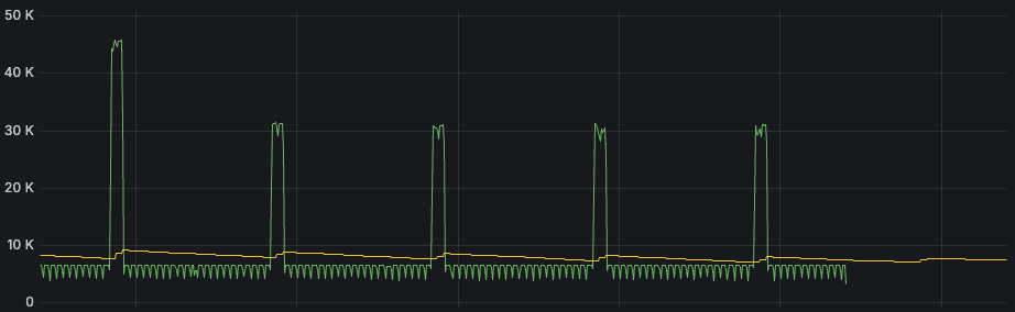

When a signal follows recurring patterns, such as daily or weekly traffic cycles, a linear forecast cannot accurately represent its future behavior.
A signal with seasonal patterns (green line) and its linear forecast (yellow line).
