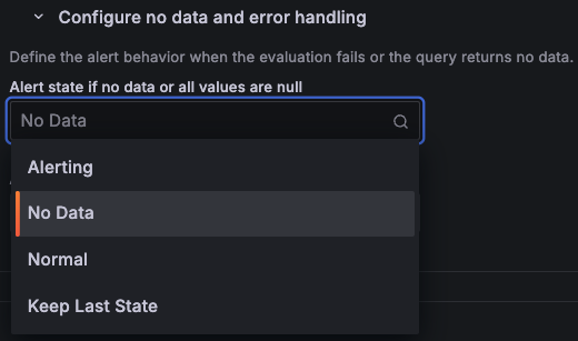

Similar to error handling, Grafana triggers a special No data alert by default and lets you control this behavior. In Configure no data and error handling, click Alert state if no data or all values are null, and choose one of the following options:
  • No Data (default): Triggers a new DatasourceNoData alert, treating No data as a specific problem.
  • Alerting: Transition each existing alert instance into the Alerting state when data disappears.
  • Normal: Ignores missing data and transitions all instances to the Normal state. Useful when receiving intermittent data, such as from experimental services, sporadic actions, or periodic reports.
  • Keep Last State: Leaves the alert in its previous state until the data returns. This is common in environments where brief metric gaps happen regularly, like with flaky exporters or noisy environments.
    A screenshot of the `Configure no data handling` option in Grafana Alerting.
