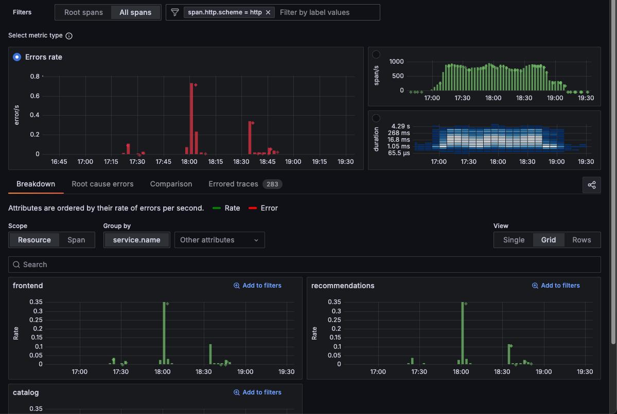

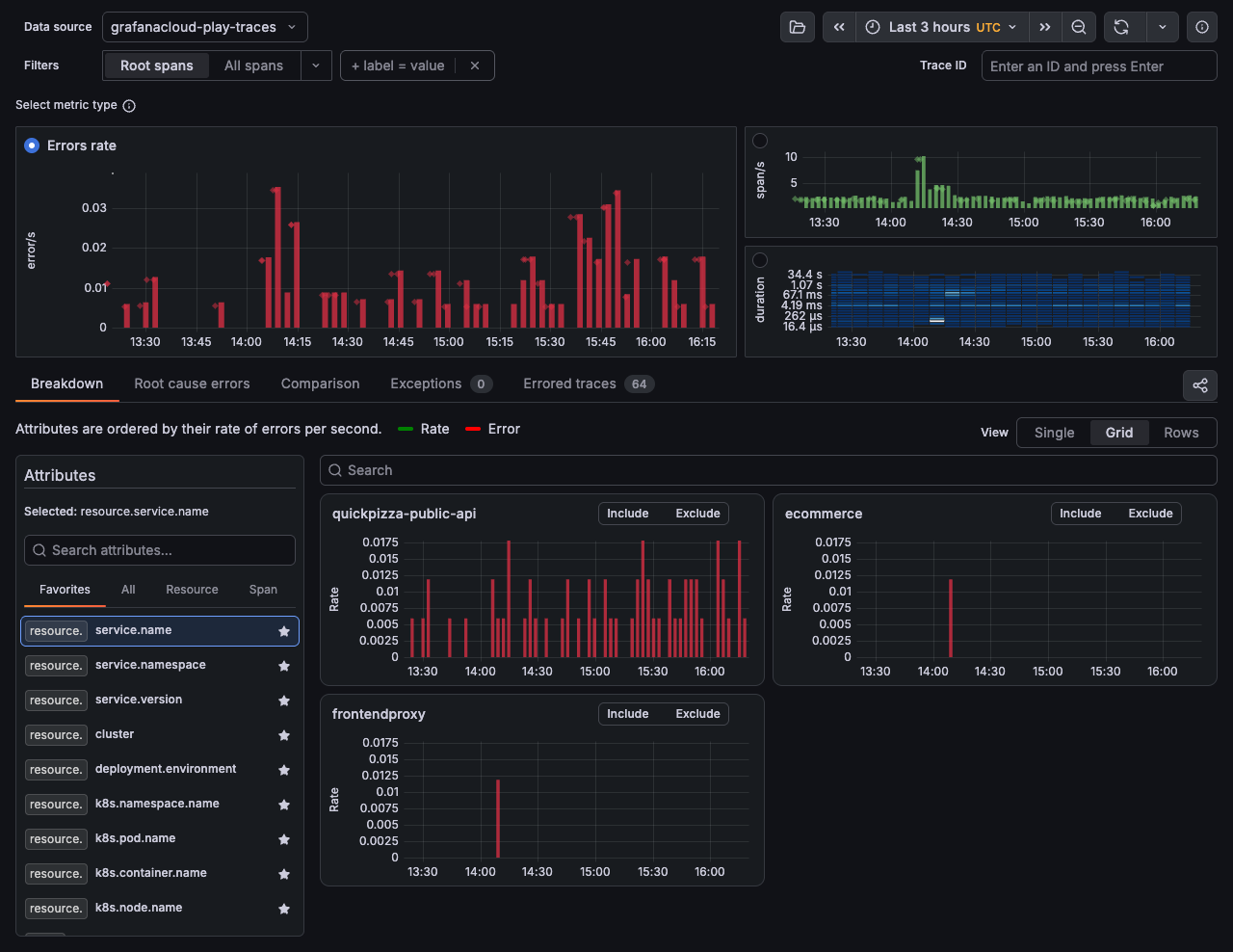

Use the Breakdown tab
The Breakdown tab splits the selected metric by the values of a chosen resource or span attribute. When you’re using Duration metrics, Breakdown shows the 90th percentile duration for every value of the selected attribute and orders values by average duration. When you select Rate, Breakdown orders the sequence of attributes by their rate of requests per second.
You can change the Scope to show Resource or Span.
Using the Attributes sidebar, you can group the selected metric by different attributes. For example, if you have selected Errors as a metric type and then choose the resource.service.name attribute, the displayed results show the number of errors sorted by the resource.service.name with the most matches.
Use the Attributes sidebar to select the attribute for Group by. You can search, scope by Resource or Span, and use Favorites for quick access. Attributes already in your Filters are listed at the top of the Attributes sidebar.
Errors metric showing the Breakdown tab without filters
By default, the selected attribute is your first Favorite or resource.service.name. You can reorder Favorites to change this default. The Attributes sidebar displays other commonly used resource level attributes such as cluster, environment, and namespace.

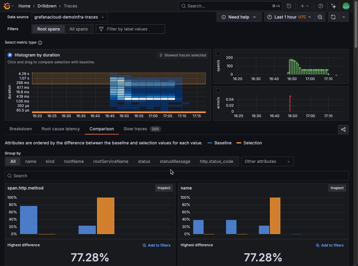

Use the Comparison tab
The Comparison tab helps you surface and rank which span attributes are most correlated with the selected metric so you can spot what’s driving your trace-level issues.
Comparison view
Upon selecting a metric, the tab computes, for each resource or span attribute, how strongly that attribute value differs between the selected subset (selection) and all other spans (baseline). It lists attribute‑value pairs in descending order of that difference, so the top entries are those most uniquely associated with your signal of interest.
  • If you’re viewing the Rate or Errors metrics, the selection contains all spans with errors, while the baseline contains all spans without errors.
  • If you’re viewing the Duration metric, by default the selection contains the slowest spans above the 90th percentile, while the baseline contains all other spans. You can manually adjust the selection on the duration heat map by clicking and dragging, or select Select slowest traces to reset the selection to the slowest spans.
The behavior of the comparison also differs depending upon the RED metric you’ve chosen. For example, if you’re viewing Errors metrics, the comparison shows the attribute values that correlate with errors. However, if you’re viewing Duration metrics, the comparison shows the attributes that correlate with high latency.
Use the Attributes sidebar to switch between All (overall differences) and a specific attribute (per‑value differences). Favorites, search, and scope controls work the same as in Breakdown.
Select Hide baseline-only to hide attribute values that appear only in the baseline, so you can focus on the values present in your selection.

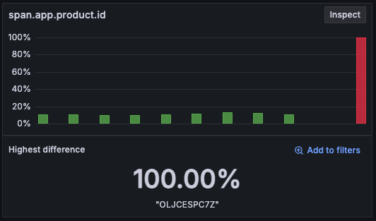

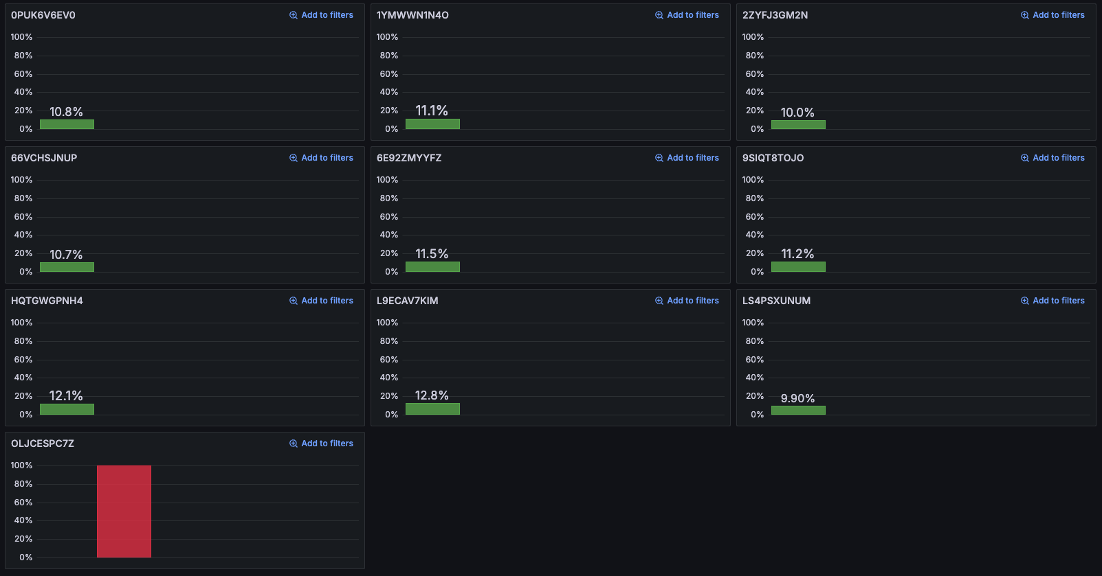

Focus on individual attributes with Inspect
Inspect lets you break down and view individual attribute values from a comparison. The overview shows each attribute with its single highest-difference value and an Inspect button, but you can’t see all values for that attribute at once.
Select Inspect on an attribute
When you select Inspect, the app focuses on that one attribute and shows a visualization for every value it contains. For example, selecting Inspect on resource.service.name shows every service with its baseline and selection bars, so you can immediately see which services are most correlated with the selected metric.
Inspect focuses the results on the selected attribute

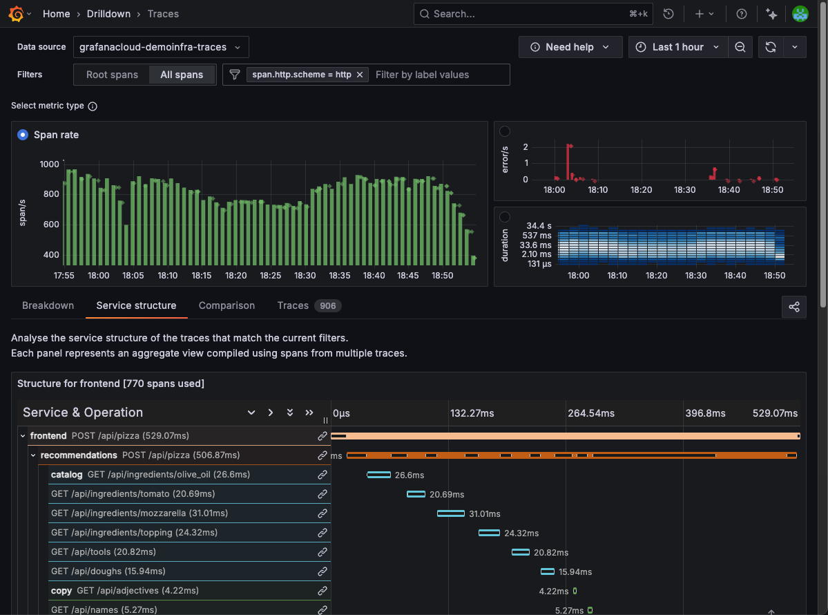

Use the Structure tab
The Structure tab lets you extract and view aggregate data from your traces. The tab name differs depending on the metric you’re viewing:
  • Rate provides Service structure
  • Errors provides Root cause errors
  • Duration provides Root cause latency
For Rate, the Service structure tab shows you how your applications talk to each other to fulfill requests. Use this tab to analyze the service structure of the traces that match the current filters.

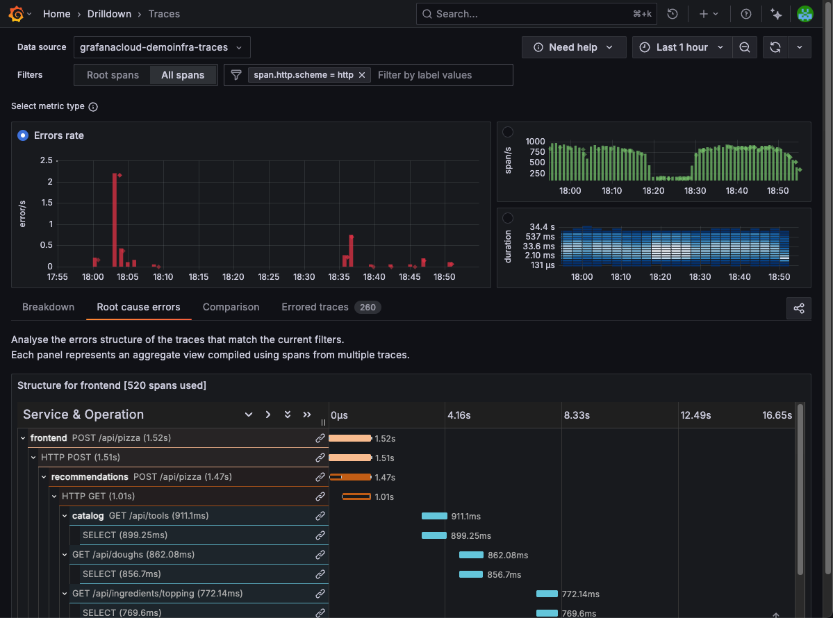

For Errors, the Root cause errors tab shows the structure of errors beneath your selected filters. Use this tab to immediately see the chain of errors that are causing issues higher up in traces.
Link to span data from Root cause errors

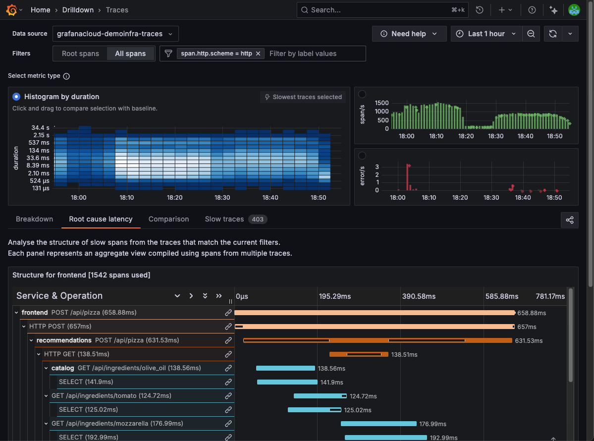

When you select Duration metrics, the Root cause latency tab shows the structure of the longest running spans so you can analyze the structure of slow spans.
The pictured spans are an aggregated view compiled using spans from multiple traces.
