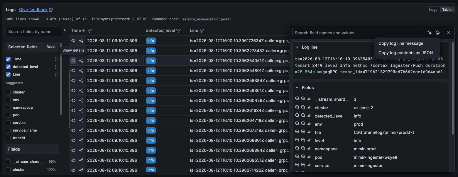

To give the table more room, collapse the sidebar with the Collapse sidebar icon. You can also resize the sidebar, the columns, and the log details sidebar by dragging their edges. Logs Drilldown remembers your column selection and sizes.
View log details
Each row has a Show details eye icon at the start of the line.
Select Show details to open the log details sidebar, where you can search fields, copy the log line, filter for or out field values, and view field statistics. Refer to View logs for explanations.
In the table view:
- Log details always open as a sidebar on the right, which you can resize or close with the Close log details sidebar icon or the Escape key.
- The copy icon at the top of the sidebar opens a menu with Copy log line message and Copy log contents as JSON options, as shown in the previous image.
- Opening details for several rows creates a tab for each log line, so you can compare them.
- Use the up and down arrow keys to move the details view to the previous or next log line.
Rows also have a Copy link to log line icon that copies a short link to that log line to your clipboard.
