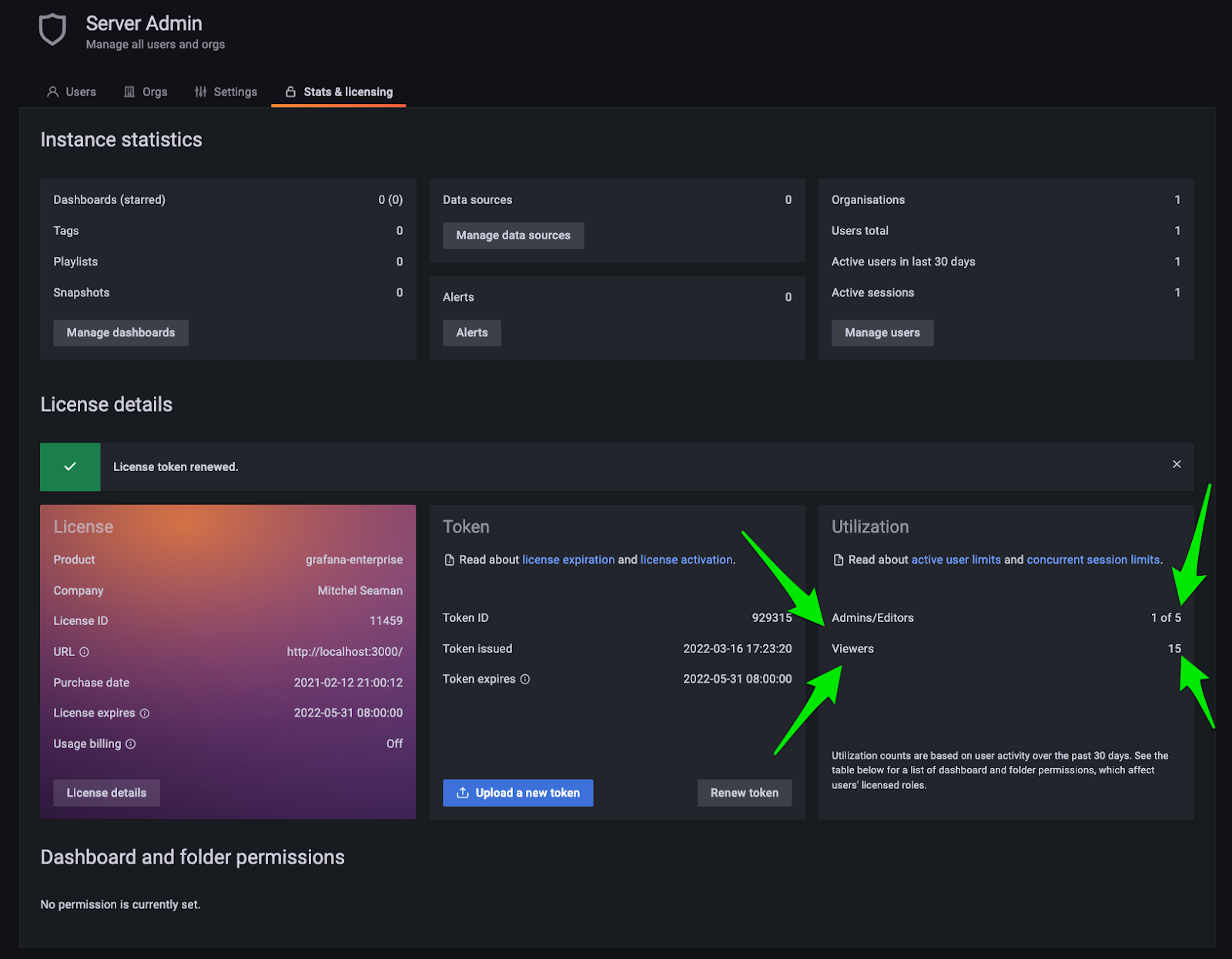

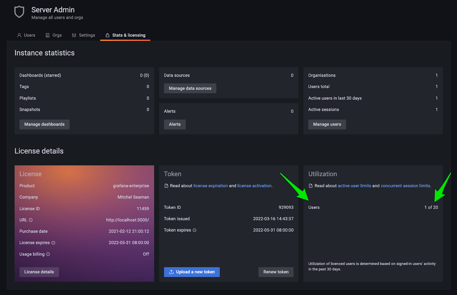

A note on Grafana Enterprise licensing
When we release Grafana 9.0 on June 14th, Grafana will no longer enforce viewers and editor-admins differently. That means that regardless of whether your Grafana Enterprise license is tiered or combined, instead of seeing this on the Stats & Licensing page:
![Separate license Separate license](/static/img/docs/enterprise/separate-licenses.png)
You will see this:
![Combined license Combined license](/static/img/docs/enterprise/combined-licenses.png)
It also means that Grafana will count all users the same, regardless of their role, including org roles (Viewer, Editor, Admin) and fine-grained roles (Dashboard Editor, Reports Editor, etc.). You won’t see a separate warning banner or see users locked out if you hit your limit of viewers or editor-admins, only your total combined limit of active users.
For example, if you have a license for 10 active admins and 100 active viewers in your Grafana Enterprise license, then starting in v9.0 you will have a limit of 110 active users, and it doesn’t matter what roles those users have, they will all be counted and enforced the same.
This is a more permissive policy than before.
