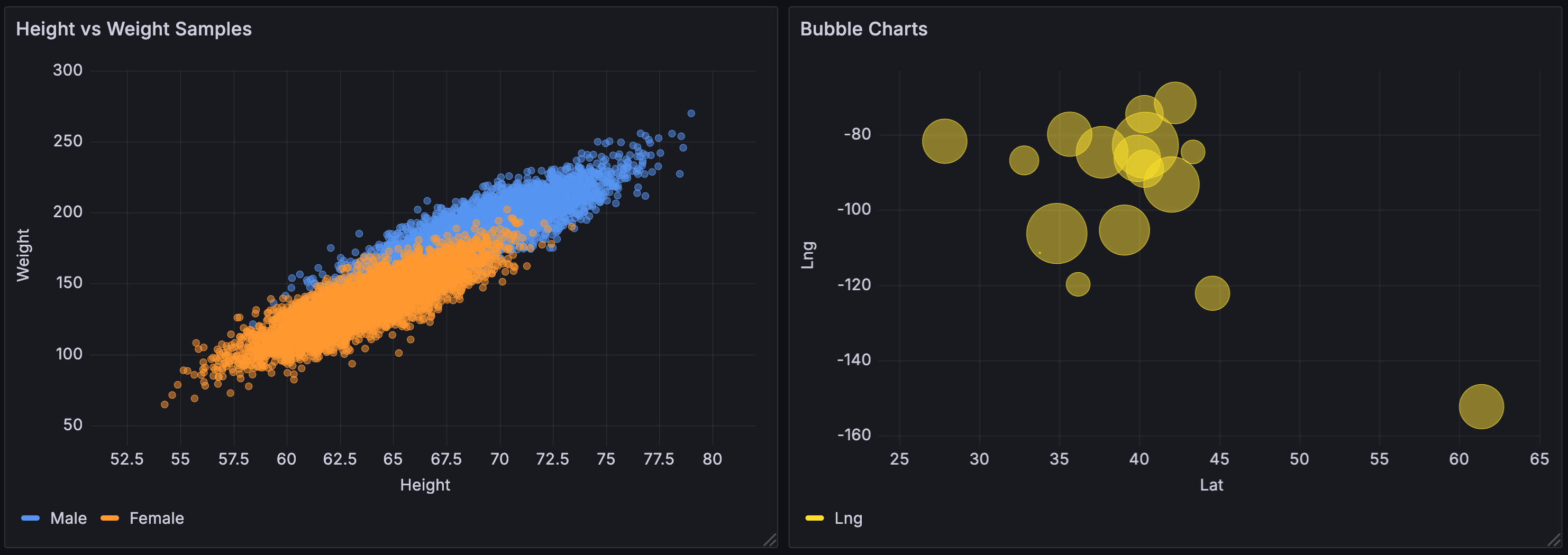

XY charts provide a way to visualize arbitrary x and y values in a graph so that you can easily show the relationship between two variables. XY charts are typically used to create scatter plots. You can also use them to create bubble charts where field values determine the size of each bubble:
An xy chart showing height weight distribution
Supported data formats
You can use any type of tabular data with at least two numeric fields in an xy chart. This type of visualization doesn’t require time data.

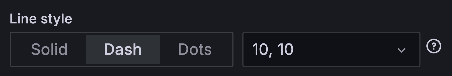

Line style
Set the style of the lines that connect points. To change the color, use the standard Color scheme field option.
Line style options
  • Solid - Display a solid line. This is the default setting.
  • Dash - Display a dashed line. When you choose this option, a drop-down list is displayed where you can select the length and gap setting for the line dashes. By default, the length and gap are set to 10, 10.
  • Dots - Display dotted lines. When you choose this option, a drop-down list is displayed where you can select dot spacing. By default, the dot spacing is set to 0, 10 (the first number represents dot length, which is always zero).
