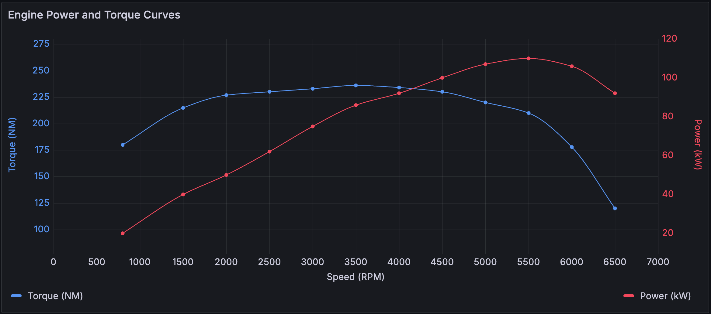

Trend visualizations should be used for datasets that have a sequential, numeric x-field that is not time. Some examples are function graphs, rpm/torque curves, supply/demand relationships, and elevation or heart rate plots along a race course (with x as distance or duration from start).
For example, you could represent engine power and torque versus speed where speed is plotted on the x-axis and power and torque are plotted on the y-axes:
Trend engine power and torque curves

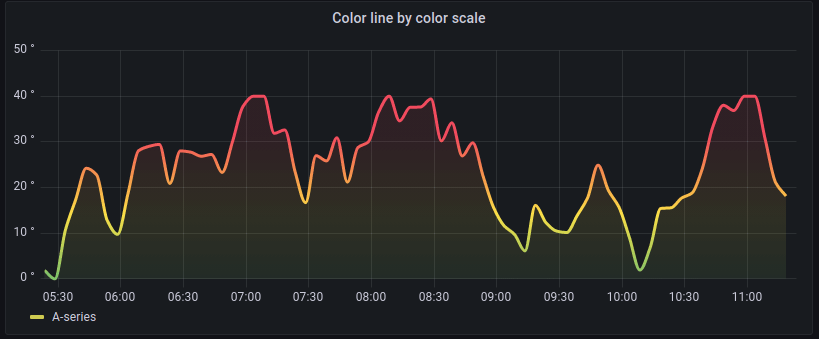

Scheme gradient mode
In Scheme gradient mode, the line or bar receives a gradient color defined from the selected Color scheme option in the visualization’s Standard options.
The following image shows a line chart with the Green-Yellow-Red (by value) color scheme option selected:
Color scheme: Green-Yellow-Red

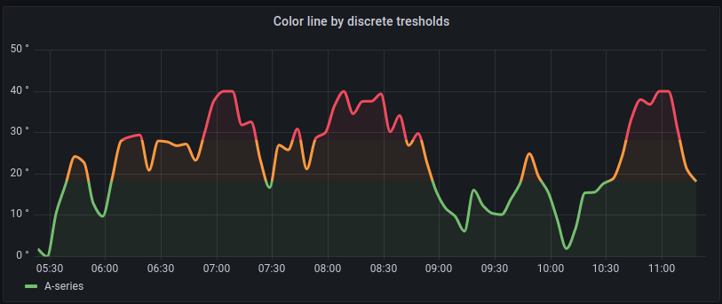

If the Color scheme is set to From thresholds (by value) and Gradient mode is set to Scheme, then the line or bar color changes as it crosses the defined thresholds:
Colors scheme: From thresholds

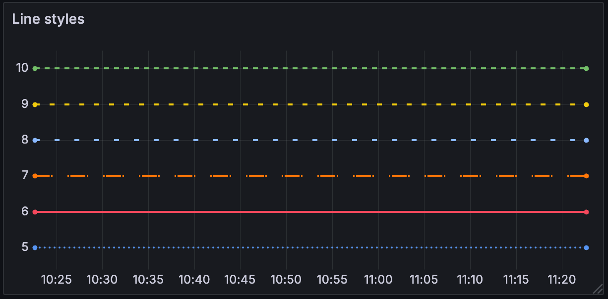

Line style
Choose a solid, dashed, or dotted line style:
  • Solid - Display a solid line. This is the default setting.
  • Dash - Display a dashed line. When you choose this option, a list appears for you to select the length and gap (length, gap) for the line dashes. Dash spacing is 10, 10 by default.
  • Dots - Display dotted lines. When you choose this option, a list appears for you to select the gap (length = 0, gap) for the dot spacing. Dot spacing is 0, 10 by default.
