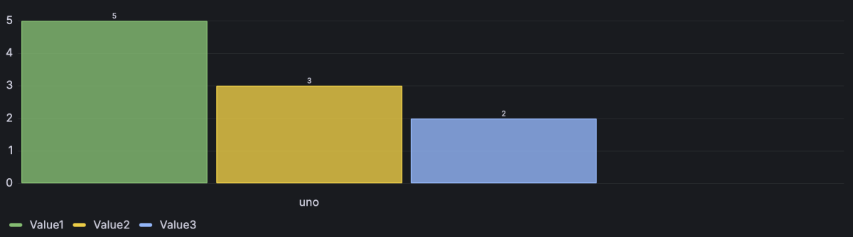

Example 1
GroupValue1Value2Value3
uno532
Bar chart single row example
If you have more than one text or time field, by default, the visualization uses the first one, but you can change this in the x-axis option as described in the Bar chart options section.

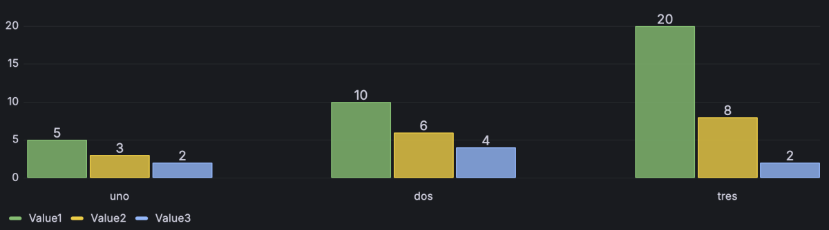

Example 2
If your dataset contains multiple rows, the visualization displays multiple bar chart groups where each group contains multiple bars representing all the numeric values for a row.
uno532
dos1064
tres2082
Bar chart multiple row example

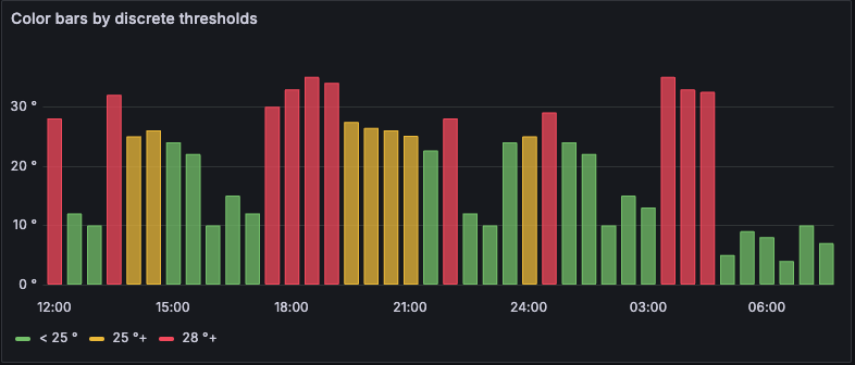

Gradient modeSet the mode of the gradient fill. Fill gradient is based on the line color. To change the color, use the standard color scheme field option. Gradient appearance is influenced by the Fill opacity setting.
Gradient mode
Set the mode of the gradient fill. Fill gradient is based on the line color. To change the color, use the standard color scheme field option. Gradient appearance is influenced by the Fill opacity setting. Choose from:
  • None - No gradient fill. This is the default setting.
  • Opacity - Transparency of the gradient is calculated based on the values on the y-axis. Opacity of the fill is increasing with the values on the Y-axis.
  • Hue - Gradient color is generated based on the hue of the line color.
  • Scheme - The bar receives a gradient color defined by the Standard options > Color scheme selection.
    • From thresholds - If the Color scheme selection is From thresholds (by value), then each bar is the color of the defined threshold.
      Color scheme From thresholds
      Color scheme: From thresholds

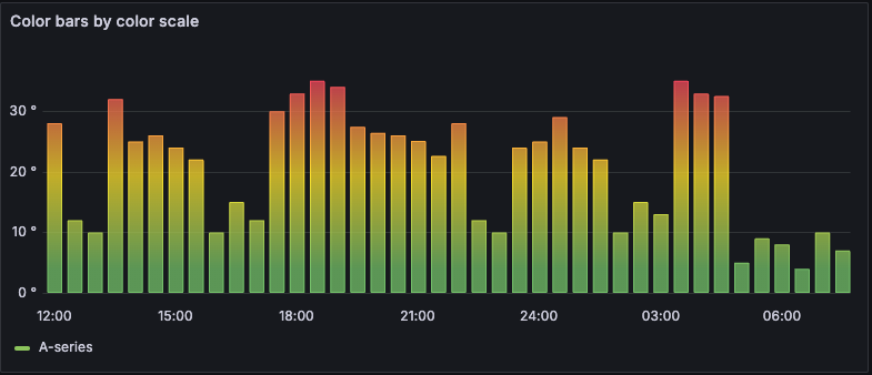

    • Gradient color schemes - The following image shows a bar chart with the Green-Yellow-Red (by value) color scheme option selected.
      Color scheme Green-Yellow-Red
      Color scheme: Green-Yellow-Red

Thresholds
A threshold is a value or limit you set for a metric that’s reflected visually when it’s met or exceeded. Thresholds are one way you can conditionally style and color your visualizations based on query results.
For each threshold, set the following options:
OptionDescription
ValueSet the value for each threshold.
Thresholds modeChoose from Absolute and Percentage.
Show thresholdsChoose from a variety of display options including not displaying thresholds at all.
To learn more, refer to Configure thresholds.
