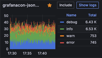

To interact with the JSON view, select the Show Logs button for your service in Logs Drilldown.

Show Logs button
From there, select JSON in the Logs format menu. This will show your logs in a structured, collapsible way, enabling you to sort, filter, and otherwise adjust your log data in the visualizations for your logs.
Show Logs button on a JSON logging service
