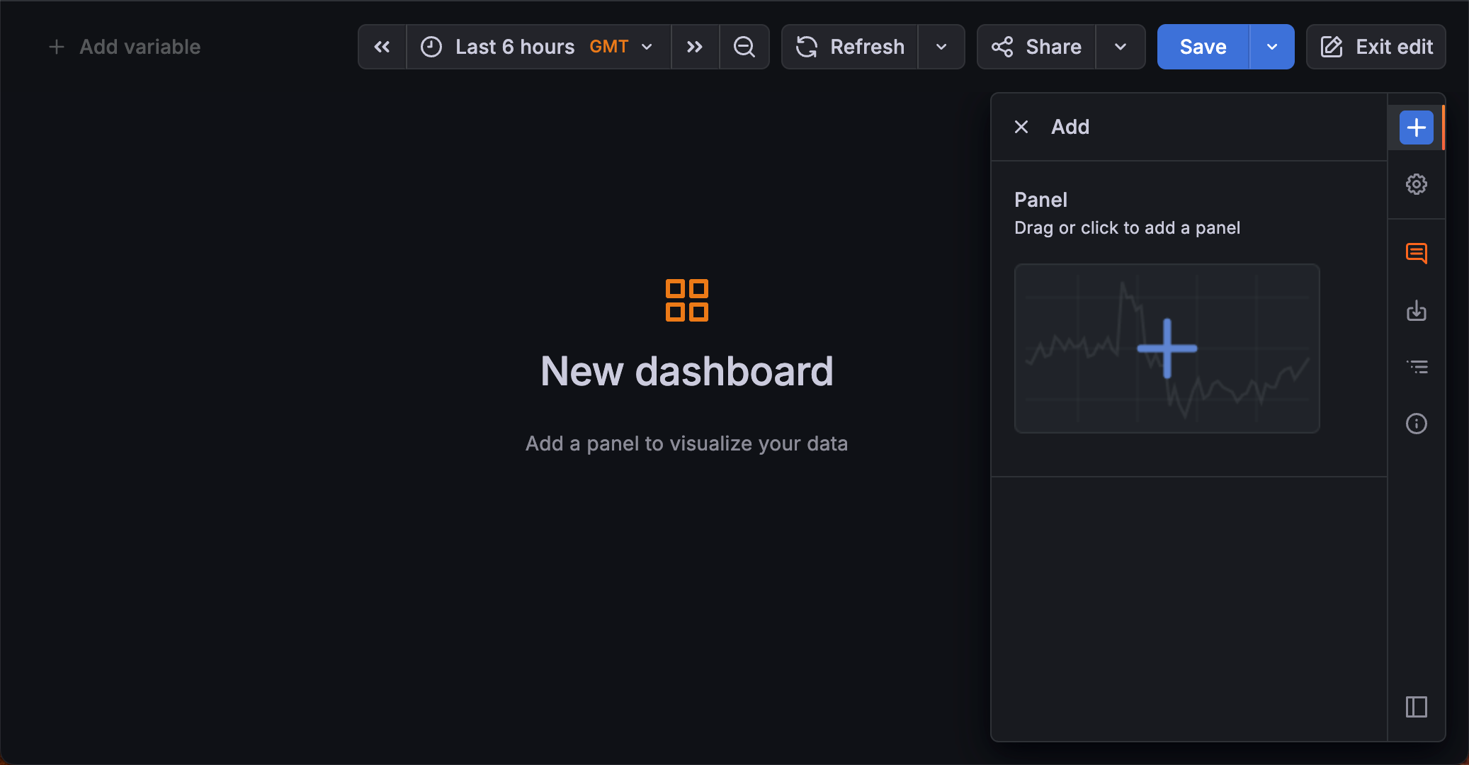

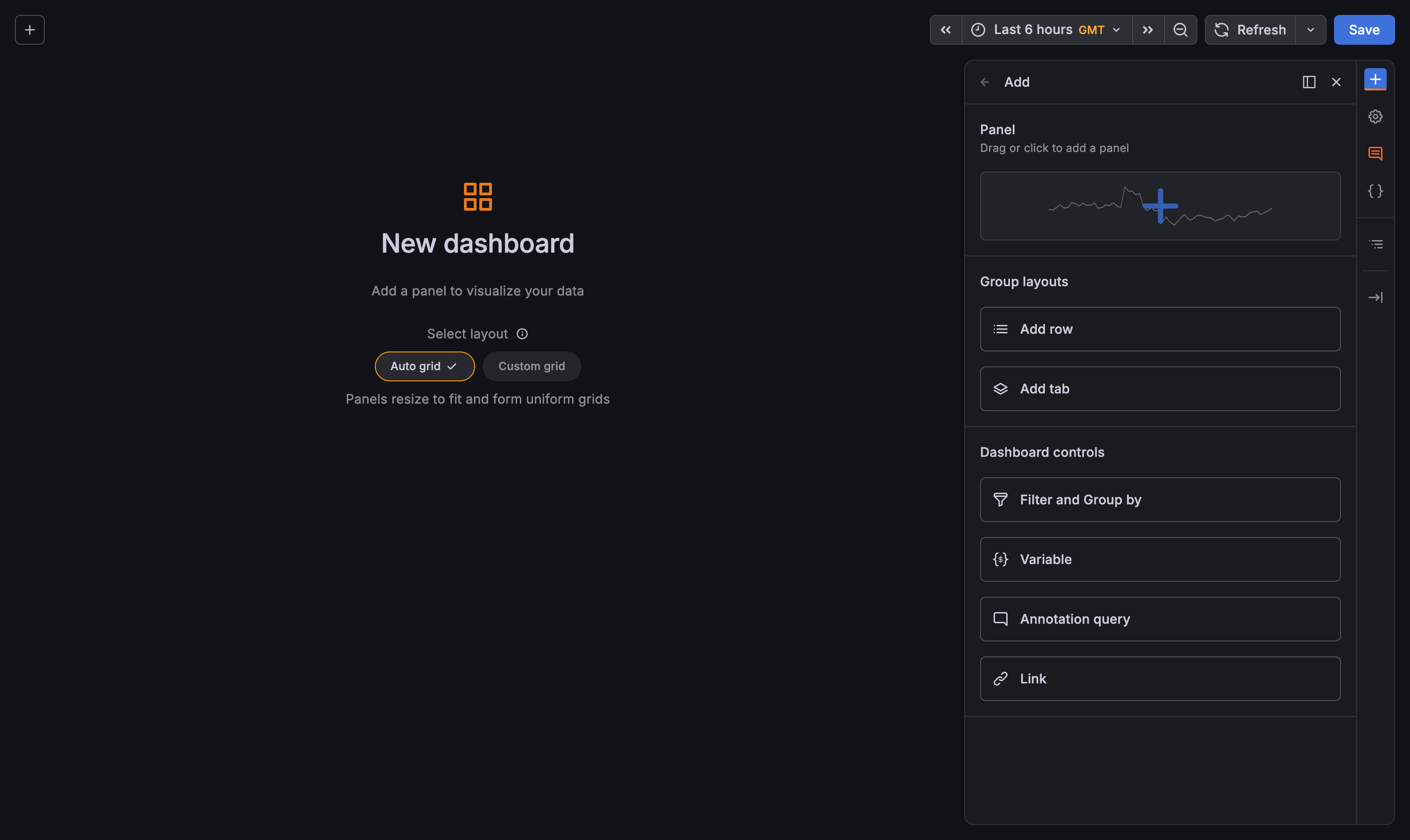

  1. Click Dashboards in the main menu.
  2. Click New and select New dashboard.
  3. Click the Add new element icon (blue plus sign) and click or drag a panel onto the dashboard.
    Empty dashboard with sidebar open

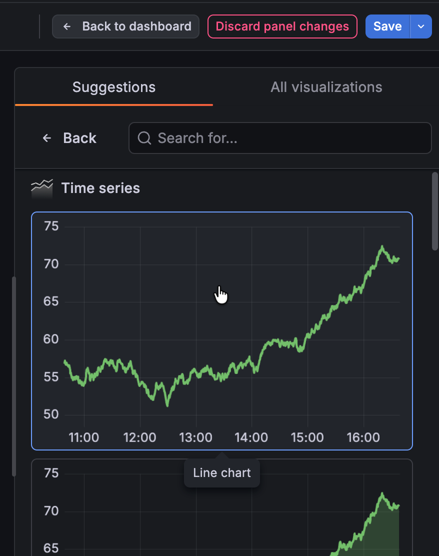

  10. Select a suggested visualization or click All visualizations and select one from the full list.
    Visualization selector
    Grafana displays a preview of your query results with the visualization applied.

The sidebar and toolbar
The sidebar allows you to make changes without leaving the dashboard, by displaying options associated with the part of the dashboard that’s in focus.
The toolbar is next to the sidebar, and it includes options that are useful to have available all the time.
The following image shows the parts of the sidebar and the toolbar. Hover your cursor over the numbers to display descriptions of the toolbar options (descriptions also follow the image):
An annotated image of the sidebar and toolbar
  1. Add new element: Click to open the sidebar with add options. Click again to close. Edit mode only.
  2. Dashboard options: Click the icon to open the sidebar and access dashboard options. Click again to close. Edit mode only.

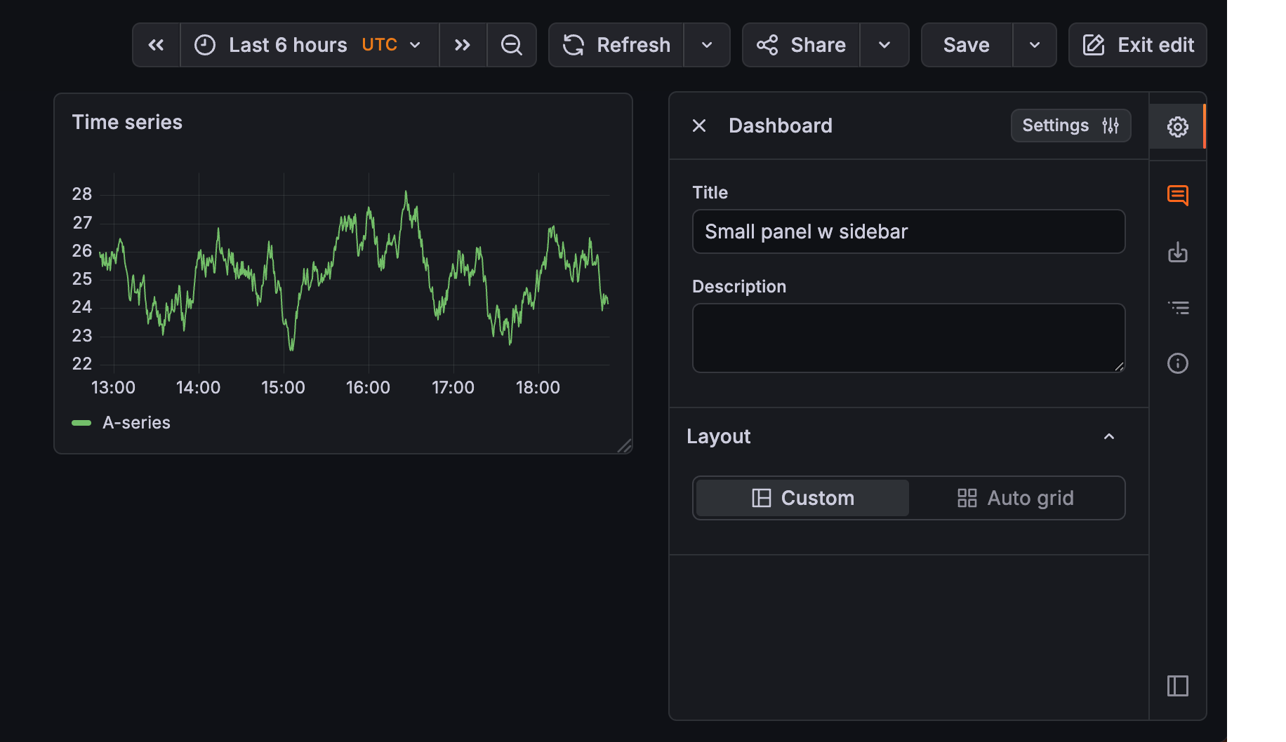

The toolbar is displayed in both edit and view mode, but the Dashboard options and Feedback icons aren’t available in view mode.
The available configuration options in the sidebar differ depending on the selected dashboard element:
  • Dashboards: High-level options are in the sidebar and further configuration options are in the Settings page.
  • Groupings (rows and tabs): All configuration options are available in the sidebar.
  • Panels: High-level options are in the sidebar and further configuration options are in the Edit panel view.
Docked and undocked sidebar

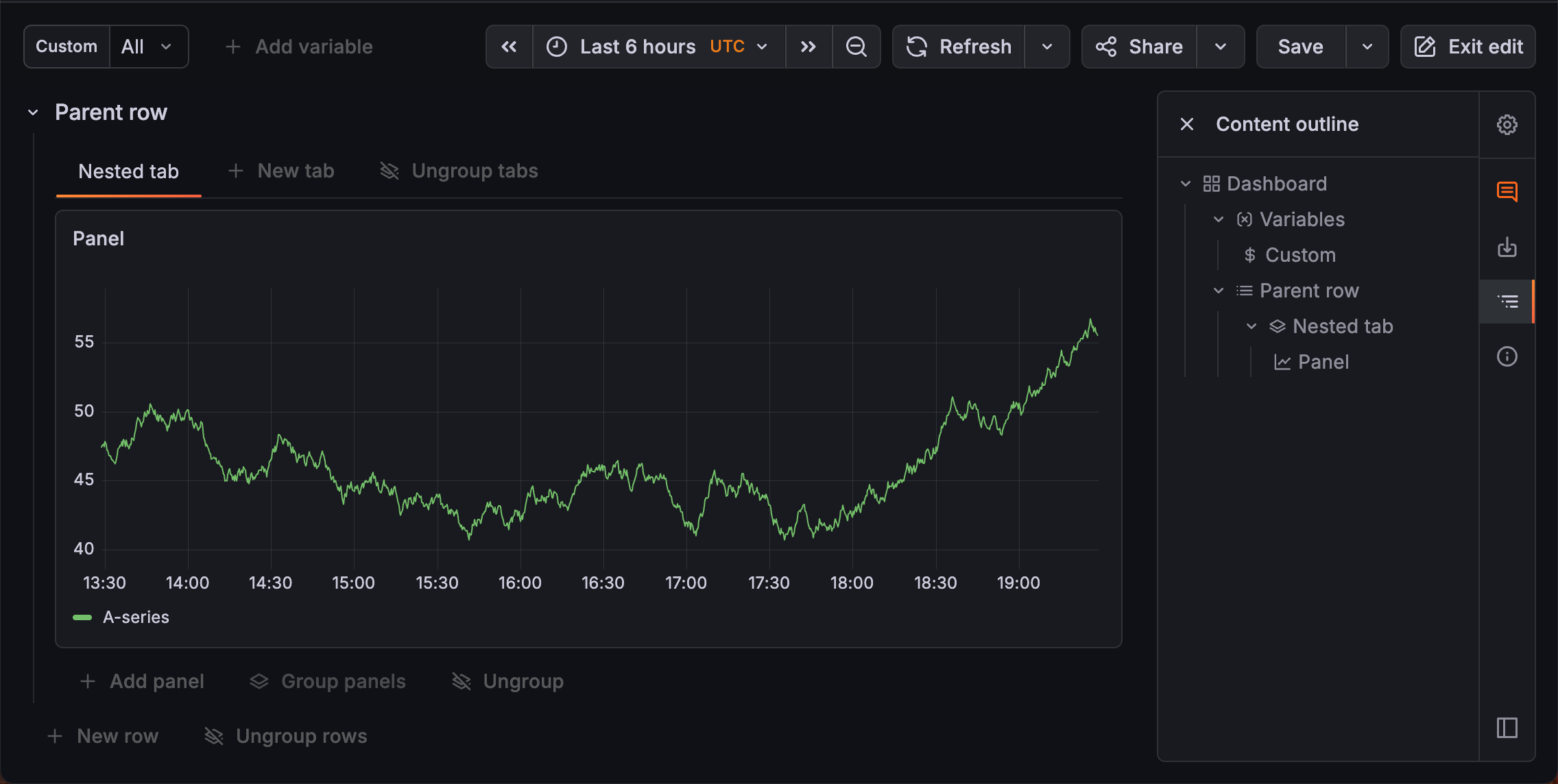

The Content outline provides a tree-like structure that shows you all the parts of the dashboard and their relationships to each other, including panels, rows, tabs, and variables. The outline also lets you quickly navigate the dashboard and is available in both view and edit modes (note that variables are only included in edit mode).
Dashboard with outline open
To navigate the dashboard using the outline, follow these steps:
  1. Navigate to the dashboard you want to view or update.
  2. In the right toolbar, click the Content outline icon to open it.
  3. Do one of the following:
    • Expand the outline to find the part of the dashboard you want to view or update.
    • Enter the name of the element in the outline search bar.
  4. Click the tree item to navigate that part of the dashboard.

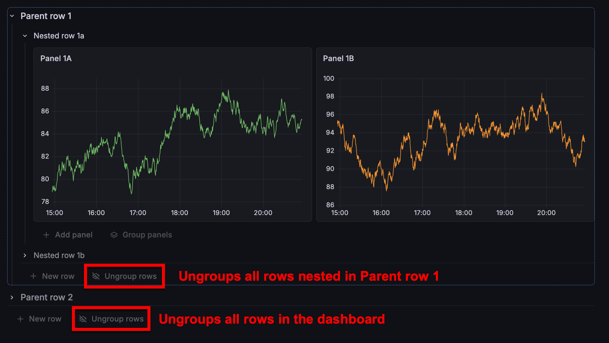

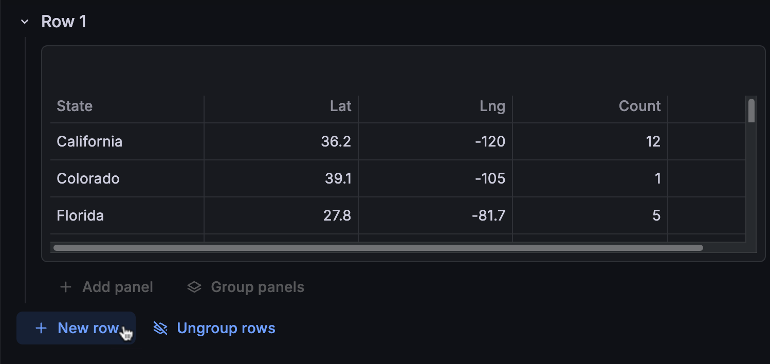

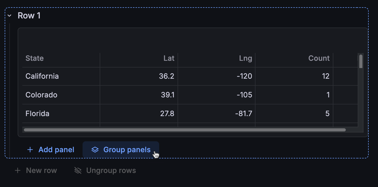

    Group panels
    Click the Add new element icon and select Add row/Group into rows or Add tab/Group into tabs.
    Alternatively hover your cursor on the dashboard to display the Group panels button and select a grouping option or select a specific set of panels and group them into rows or tabs.
    For more information on groupings, refer to Panel groupings.

Panel layouts control the size and arrangement of panels in the dashboard. There are two panel layout options:
  • Custom: You can position and size panels individually. This is the default selection for a new dashboard. Show/hide rules are not supported.
  • Auto grid: Panels resize and fit automatically to create a uniform grid. You can’t make manual changes to this layout. Show/hide rules are supported.
When you first create a dashboard, you select a layout and that selection becomes your the default for rows and tabs that you add to the dashboard. However, you can change this default in the dashboard settings.

  3. Click the panel, row, or tab you want to update to open the sidebar, or click the Dashboard options icon to open it.
    If the dashboard is large, open the Content outline and use it to navigate to the part of the dashboard you want to update.
  4. Expand the Show / hide rules section.

    If the dashboard is large, open the Content outline and use it to navigate to the panel.

When your dashboard or grouping has a Custom layout, you can manually resize a panel.
To resize a panel, follow these steps:
  1. Navigate to the dashboard you want to update.
  2. Click Edit.
  3. Navigate to the panel you want to resize.
  4. Click and drag the lower-right corner of the panel to change the size of the panel.
  5. Click Save.
  6. (Optional) Enter a description of the changes you’ve made.
  7. Click Save.
  8. Click Exit edit.
