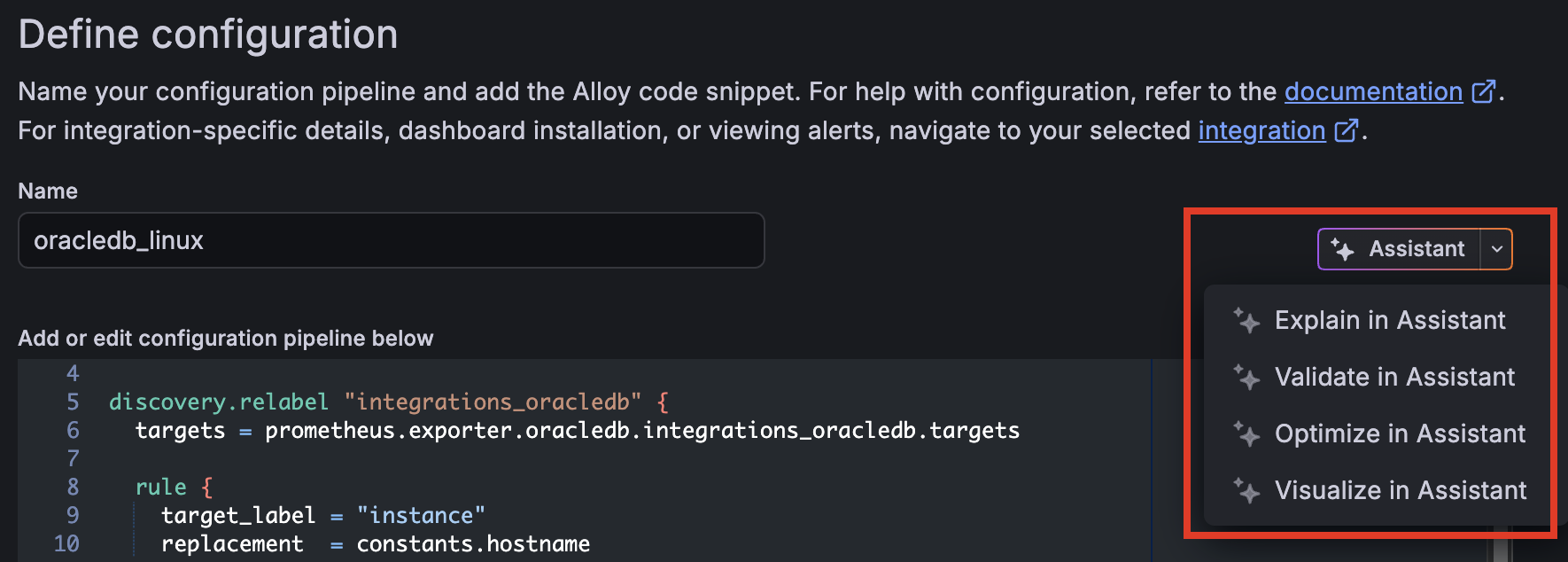

  8. To understand how your pipeline works, the different components in use, and potential areas for optimization, click the Assistant button. You can choose to have Grafana Assistant explain the pipeline, validate the syntax or fix errors if there are any, optimize the configuration, or create a diagram of the pipeline.
    One section of the Define configuration page in the Fleet Management interface in Grafana Cloud where a menu shows the tasks that Grafana Assistant can perform on the selected configuration pipeline. The four options are Explain in Assistant, Validate in Assistant, Optimize in Assistant, and Visualize in Assistant.
