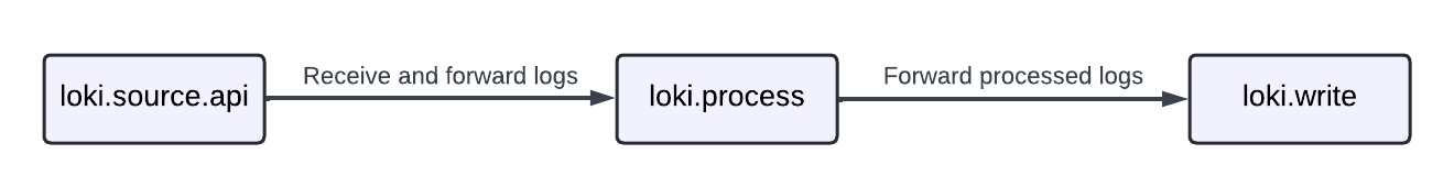

Your pipeline is going to look like this:
Start by setting up the loki.source.api
component:
loki.source.api "listener" {
http {
listen_address = "127.0.0.1"
listen_port = 9999
labels = { source = "api" }
forward_to = [loki.process.process_logs.receiver]
This is a simple configuration.
You are configuring the loki.source.api
component to listen on 127.0.0.1:9999
and attach a source="api"
label to the received log entries, which are then forwarded to the loki.process.process_logs
component’s exported receiver.
