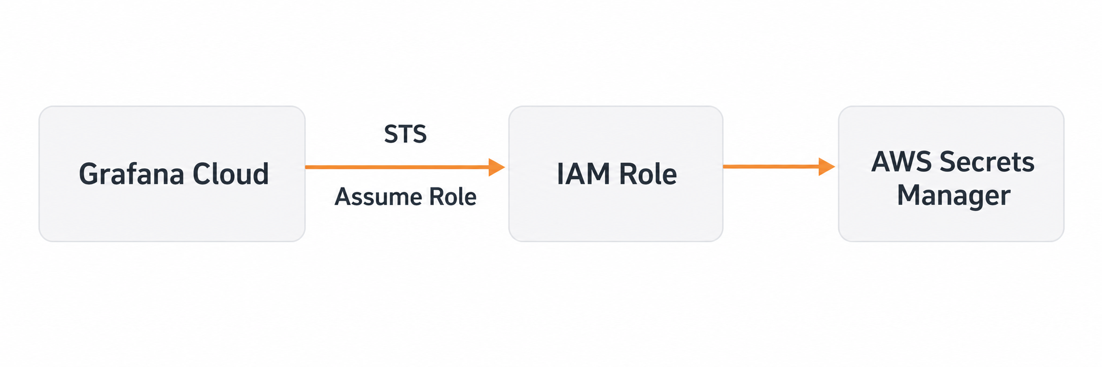

Grafana connects to your AWS Secrets Manager using cross-account role assumption through AWS Security Token Service (STS). Grafana never stores your AWS credentials. You create an IAM role in your AWS account, and Grafana assumes that role to read and write secrets on your behalf.
Grafana Cloud assumes an IAM role in your AWS account to access secrets in AWS Secrets Manager
