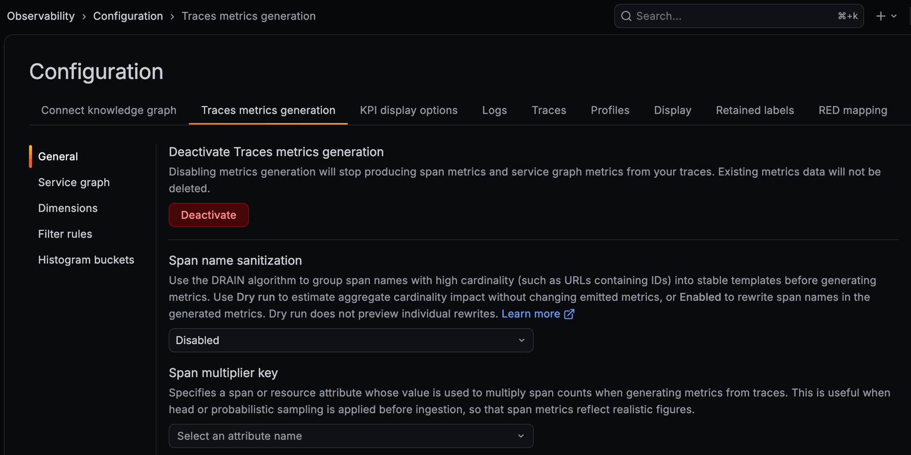

After activation, the configuration interface displays five sections: General, Service graph, Dimensions, Filter rules, and Histogram buckets.
Traces metrics generation configuration interface

Deactivate Traces metrics generation
Deactivating metrics generation stops producing span metrics and service graph metrics from your traces. Existing metrics data isn’t deleted.
To deactivate Traces metrics generation:
  1. Navigate to the General tab.
  2. Click Deactivate.
  3. Confirm the deactivation.
Note
You can safely disable metrics generation if:
  • You generate metrics from traces on your end through OpenTelemetry Collector, Grafana Alloy, Grafana Beyla, or other tools
  • You use a custom data source for metrics
  • You don’t need the automatic metrics generation provided by the knowledge graph
Set span multiplier key
The span multiplier key specifies a span or resource attribute whose value multiplies span counts when generating metrics from traces. This is useful when head or probabilistic sampling is applied before ingestion, ensuring span metrics reflect realistic figures. For example, if you sample 10% of traces (sampling rate of 0.1), set the span multiplier to the inverse (10) to ensure span metrics reflect realistic traffic volumes.
To configure the span multiplier:
  2. From the Span multiplier key dropdown, select an attribute name.
